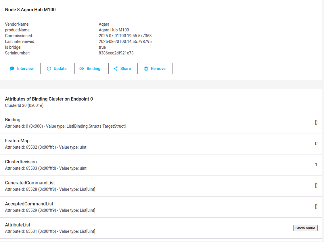

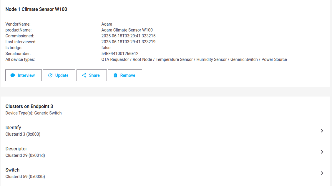

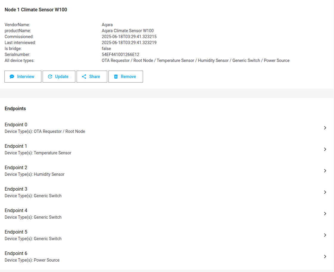

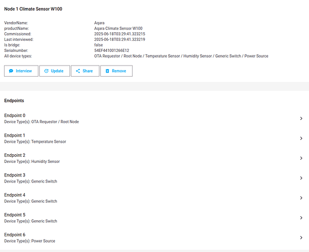

I found out by using the home assistant matter server. Once you add a device you can view all the devices capability’s and clusters. This is what a W100 looks like.

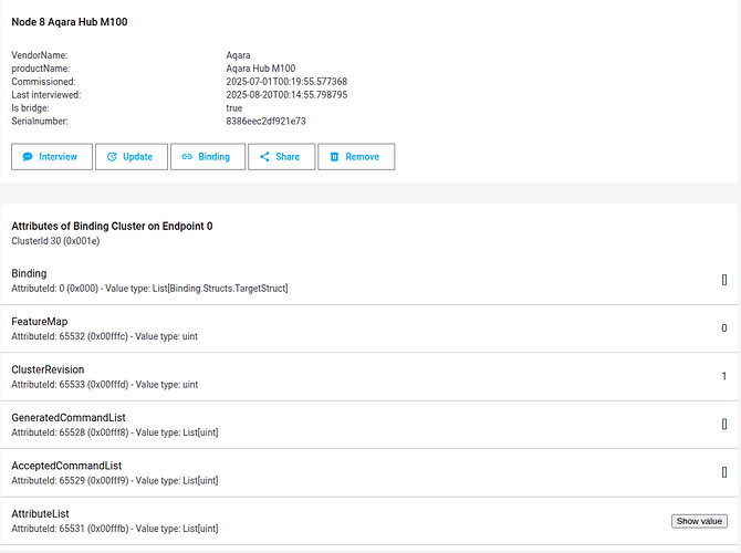

If it had binding support it would look more like this. This is the M100 hub, it has cluster 30.

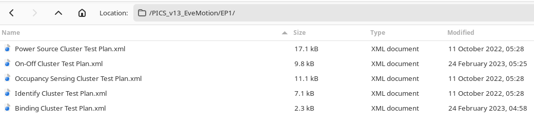

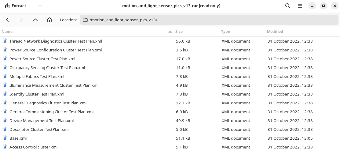

From now on I will be using W100 Matter Certification to figure out if devices support Cluster 30. You can download the compliance documents to find out what clusters a matter device supports.
The Eve thread motion sensor supports binding.
The Aqara Motion P2 does not.

Mind that checking for the bindings cluster is not enough except to know it doesn’t support bindings. If the cluster is available you also have to check which clusters and commands are supported as “client” since they have to match the “server” ones in the target device.
Bindings are kind of a hardcoded automation that you can’t change, it will send the commands that are set by the manufacturer.
For instance, the aforementioned W100 has three buttons but, even if it supported bindings, you would not be able to set the action for each button or what kind of device could it control, that would be predefined.
For a motion sensor you won’t be able to set the behaviour, like the time the light will remain on, or set schedules so it doesn’t turn on the light during the day or depending on certain ambient luminosity. For that you would need an automation, the binding would be limited.
