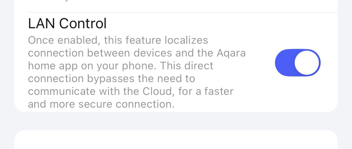

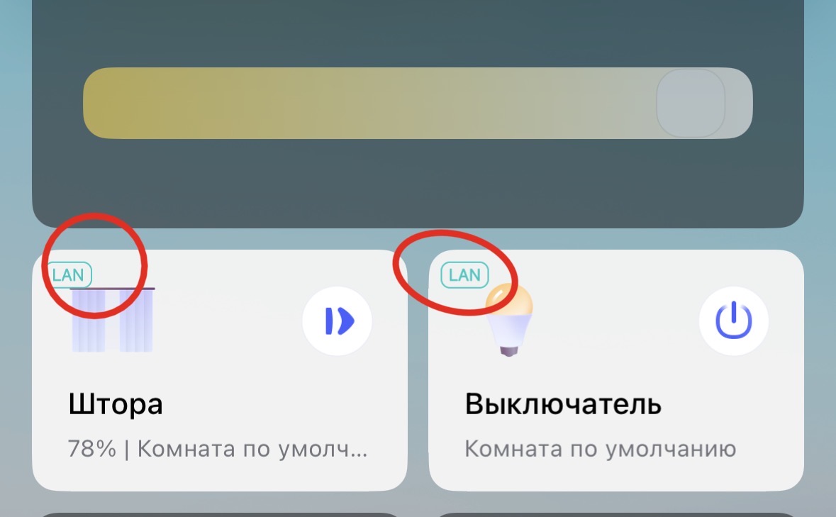

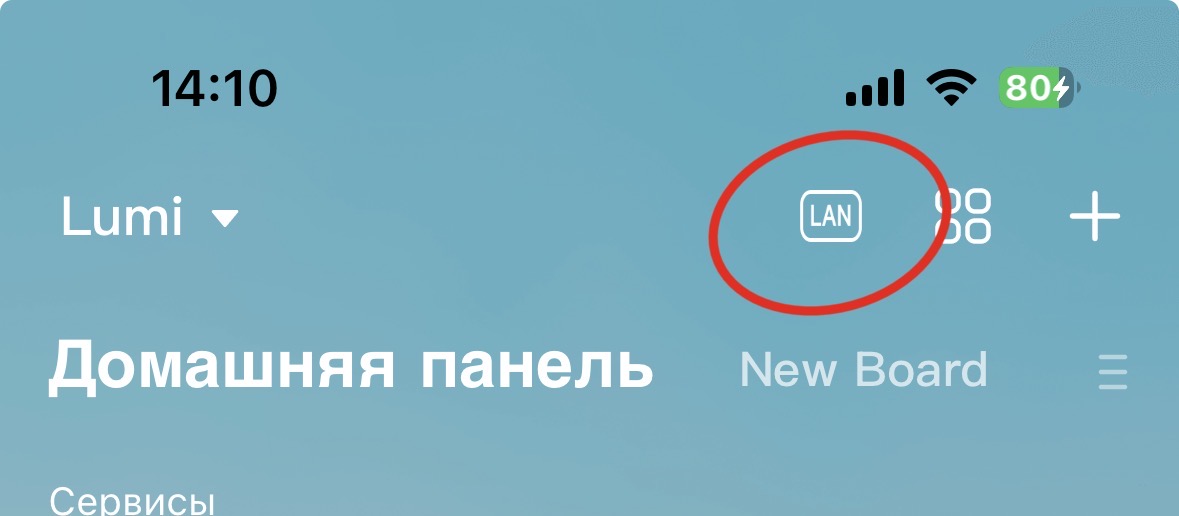

The ZigBee network is local, if you need local control from the application, then you need an m3 hub and enable the Lan control function in the settings. With Lan control, you can control devices (perform simple on/off actions) from the aqara home home screen without the Internet.
