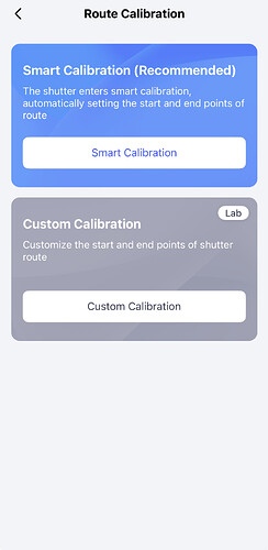

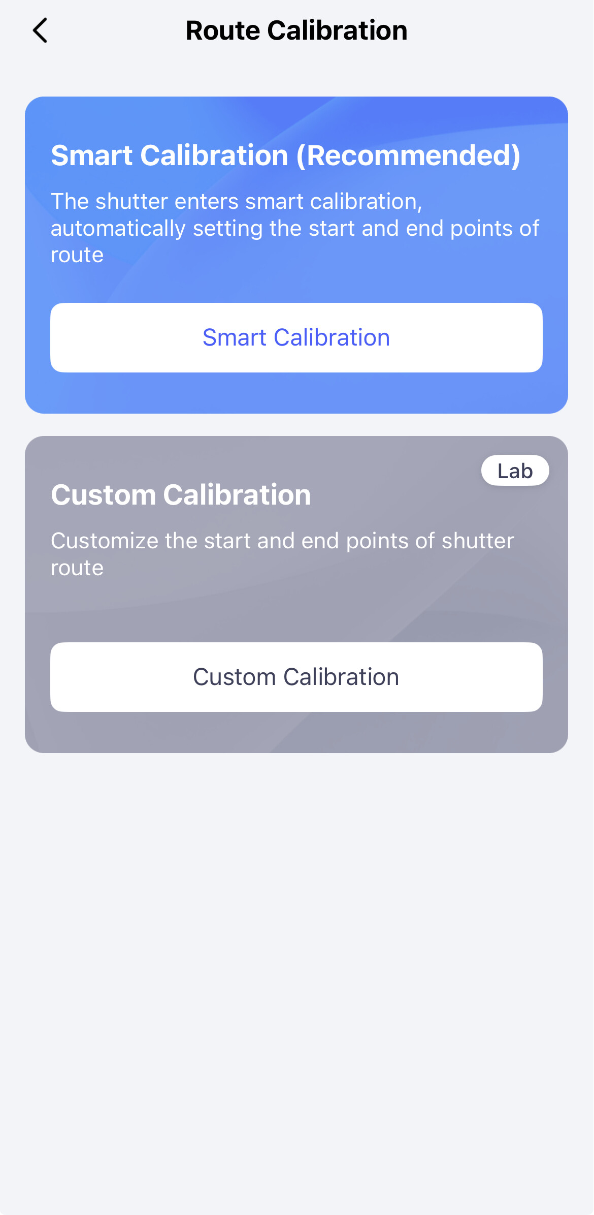

Hi! I just installed the H2 EU myself. Since you are using two motors on one switch, the Smart Calibration likely fails because the switch cannot correctly detect the current drop when the motors stop (the combined load curve confuses the sensor).
However, I noticed in the app that there is a ‘Custom Calibration’ (Lab) option below the Smart Calibration button. Have you tried using that? This should allow you to set the opening/closing times manually, bypassing the automatic current detection.
