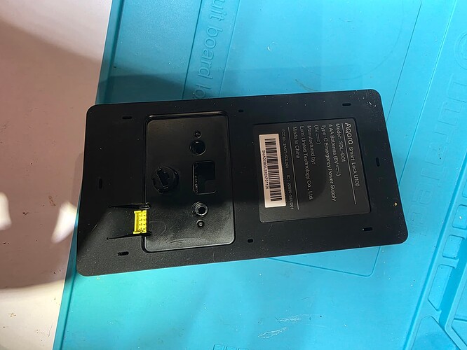

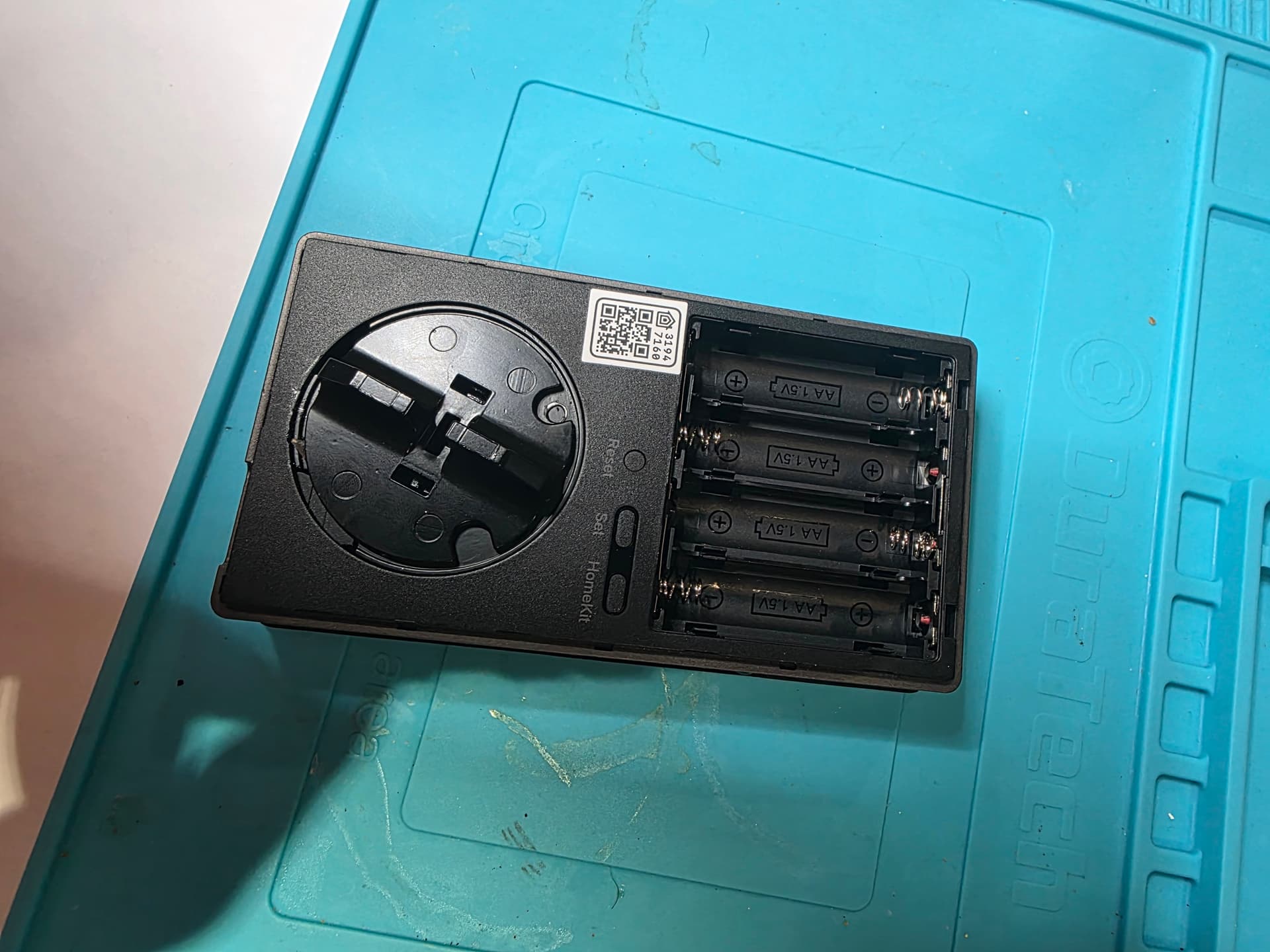

What was the solution? I have 3 of them, and the first two were fine but the third is be it’s doing exactly what you described. I feel like the cable is interfering with the locking mechanism. I’ve tried adjusting it like 15 times and it’s not fully retracting and has trouble. Without the motor on it’s fine, and if I don’t push the cable in, and just align the motor it’s fine, but when I push the cable into the hole it always has the issue. I feel like there should be some type of insert to prevent the cable from Interfering.
I’m having the same issue. The cable - at least in my case - is just too long. I can’t tuck the excess down into my door because other than the hole for the knob the door is solid. As a result I have around 2" of excess cable that inevitably makes it’s way up to the cylinder and gets caught on whatever moves back and forth on the bottom.
I agree that there should be a plastic tube that fits over the cylinder and does not interfere with the movements. Either that, or make the cable M-M and put a Female socket on the front piece instead of having the cable internally attached. Then either include a short and long cable, or at least have one available for purchase. I know when I bought my August lock the one thing they did right was to include different parts for different doors.
This issue is the only issue that is keeping me from buying 2 more locks (side and back doors) and replacing my August locks. I rent rooms out and my tenants are having trouble getting the door to open because of this issue.
