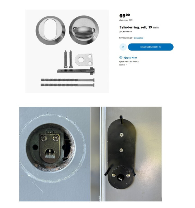

I used this set from Biltema (Used screws, plate and tail bar/piece) to connect as you see in the picture. Change to the scandi accessory on the fixed plate. Then continue installing according to the instructions.

@Stian Thanks for sharing your practical installation tips for the Aqara Smart Lock U200 on Scandinavian doors! It’s wonderful to see how you used the Biltema set (screws, plate, and tail bar) and switched to the Scandi accessory on the fixed plate to complete the installation. This aligns with the U200’s compatibility with “select Scandi cylinders” under Euro Mortise Locks, as noted in the product details . Your experience is super valuable for other users with similar door setups—community insights like this really make the forum a go-to resource. Feel free to share more of your installation journey or other tips you picked up along the way!

@Stian Thanks for sharing your Aqara Smart Lock U200 installation tips on Scandinavian doors! It’s really helpful for other users who might face similar scenarios, especially the practical details about using the Biltema set (screws, plate, tail bar) and switching to the scandi accessory on the fixed plate. Your real-world experience adds great value to the community. Feel free to share more follow-up insights or photos if you have them—we’d love to hear more!

@Stian Thanks for sharing your practical installation tips for the Aqara Smart Lock U200 on Scandinavian doors! It’s great to see how you used the Biltema set and switched to the Scandi accessory on the fixed plate—this kind of real-world experience is super helpful for the community.
For context, the Aqara Smart Lock U200 does support select Scandi cylinders under its Euro Mortise Lock compatibility, which aligns with your approach . Your step-by-step insight (using screws, plate, tail bar, and following instructions) provides a clear roadmap for others facing similar setups.

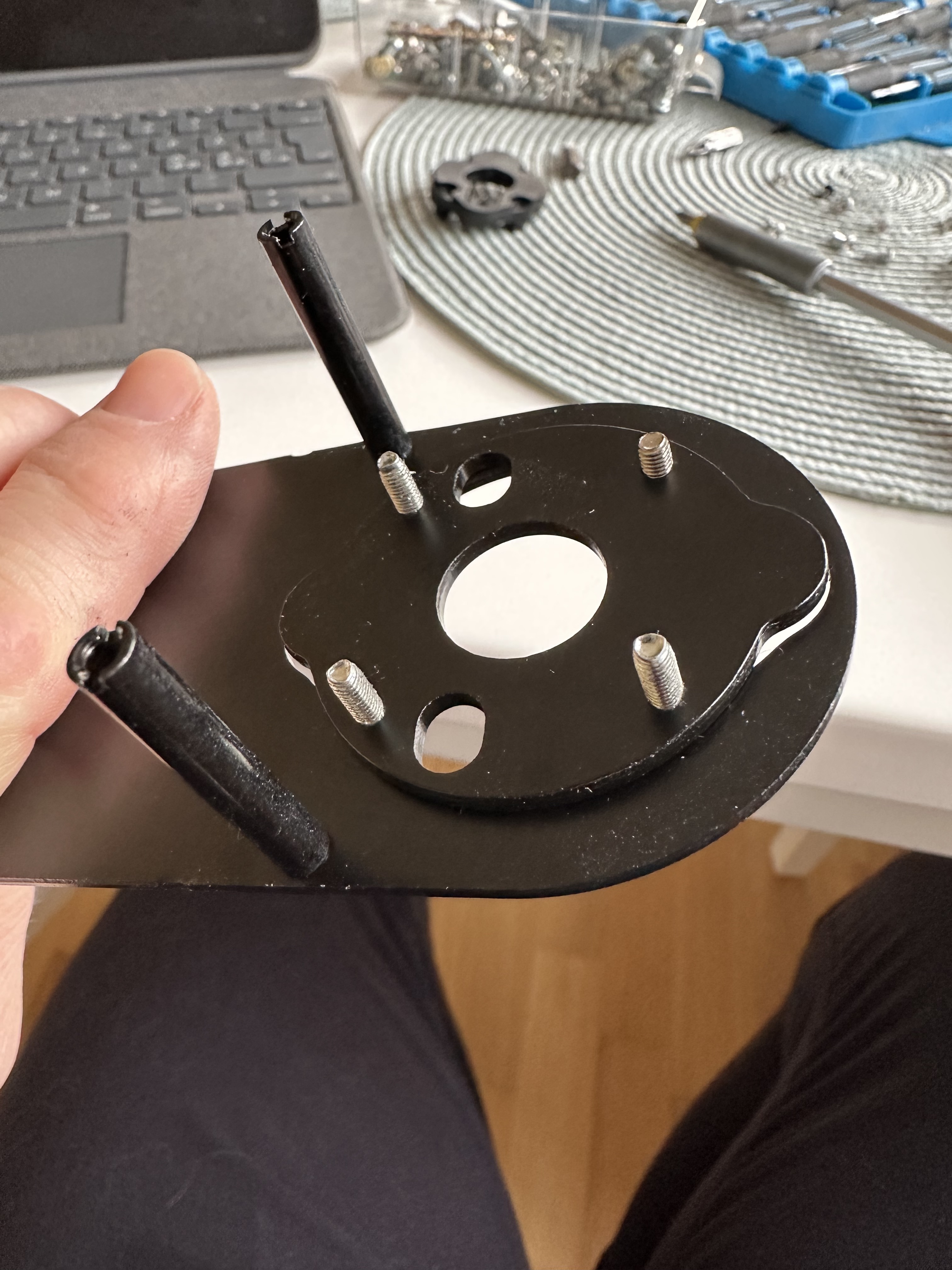

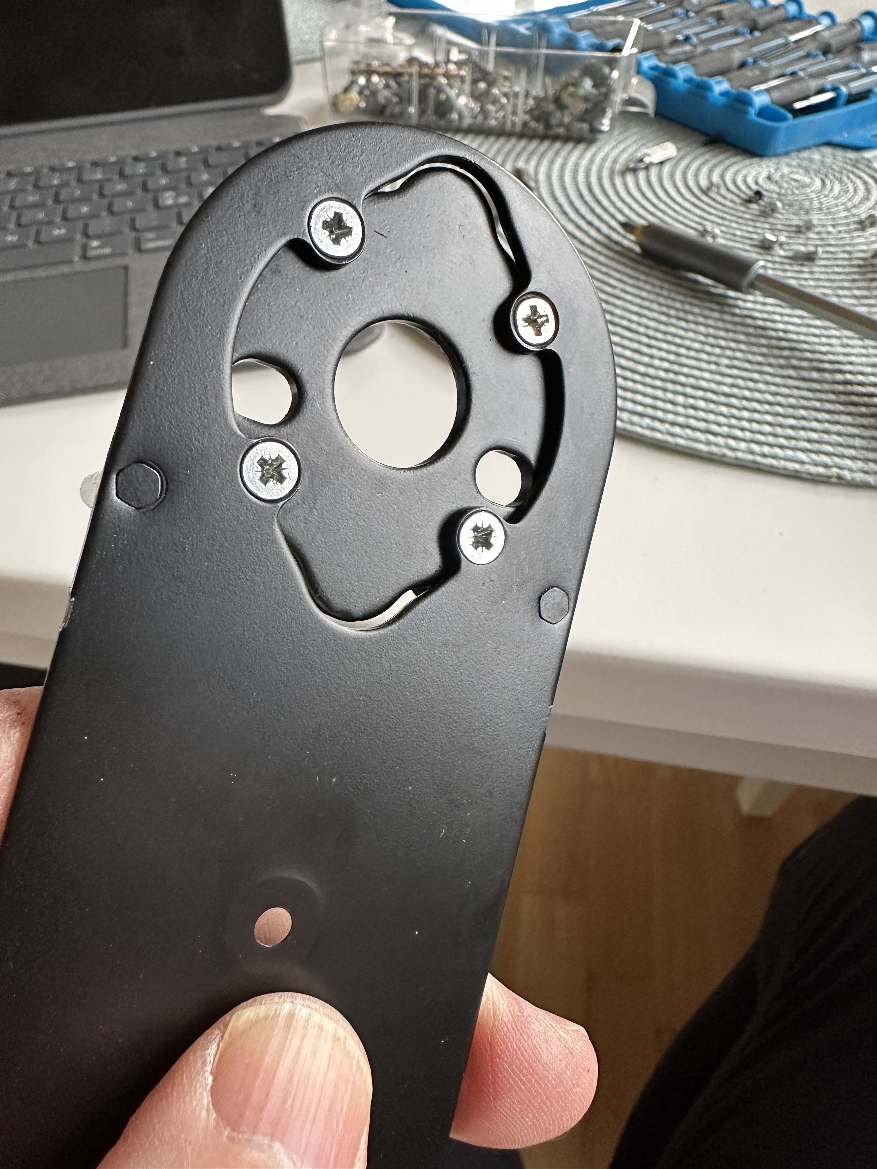

I only have one question which is unclear to me. How did you fasten the accessory to the base of Aqara U200? This accessory is threaded metal but I see no bolts to fasten the two together.
I did something similar. I fastened the accessory plate on the inside of the base plate. I had some machine screws already. They were a little bit too long, but there is plenty of space inside the u200.
