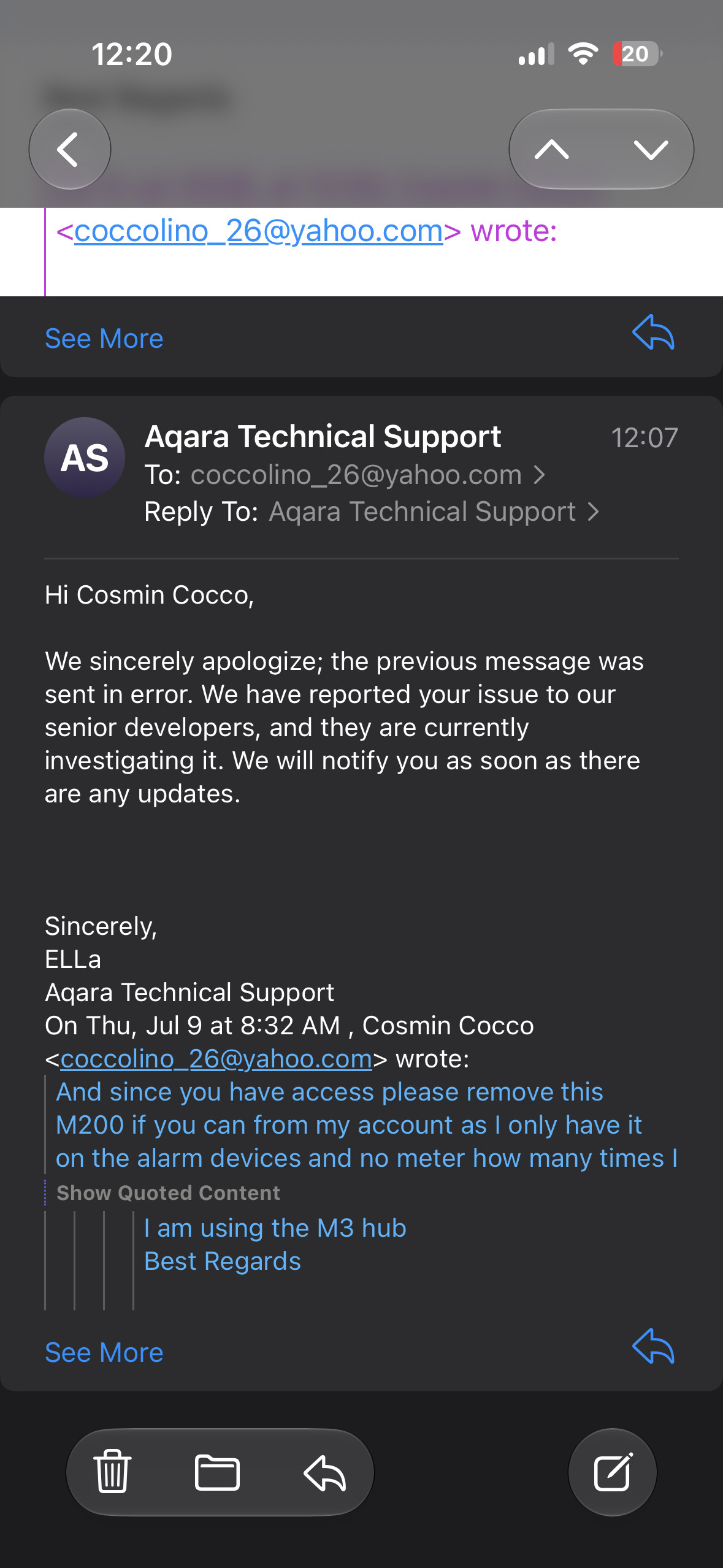

Did you hear back from Aqara support yet? I approved the diagnostic access on July 8th, but I haven’t heard anything from them since. I’m really curious if they found anything in your logs or mine!
Not yet as only yesterday I give them access and told them the day I made the tests ether way they will not let as know about and if they find some issue will push update ether to M3 or the smoke detectors
I just receive this email this will take some time so we need to be patients and wait for some updates in the near future
That matches my experience! I actually sent them a follow-up email and got a reply today as well. They asked for the exact timestamps of when the issue occurred, and I had to approve the diagnostic access in the app once again.
