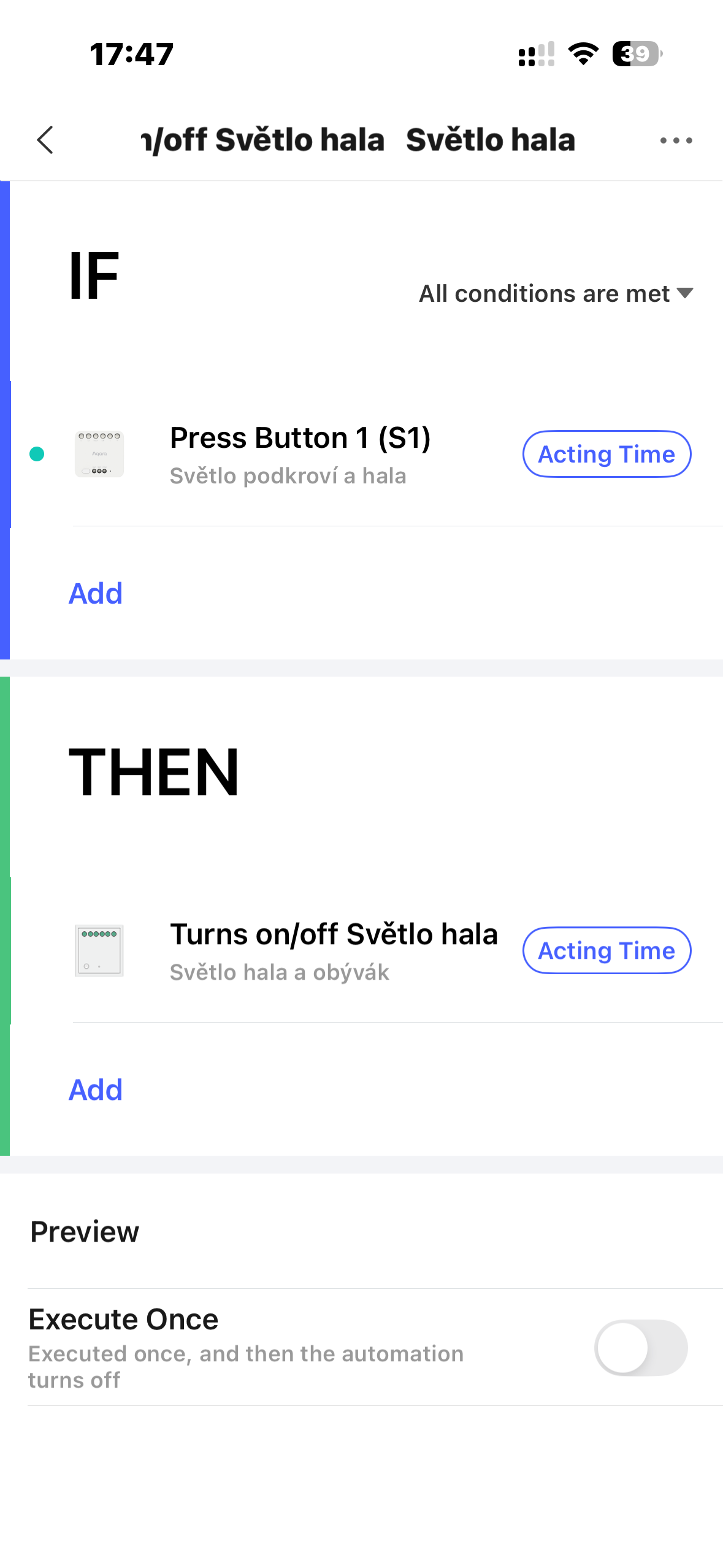

  • IF: Short press of Button 1 (S1) – the upper button at the stairs
  • THEN: Turn ON/OFF Channel 1 – the main relay at the bottom near the light

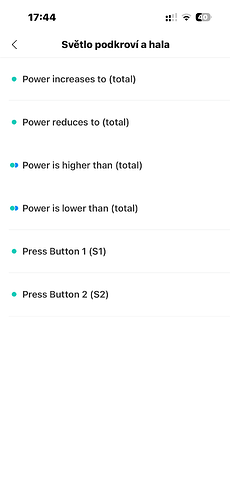

For a better understanding, you can upload screenshots of automations.
Just to add, when I create the same automation on an Apple iPhone, it works. But I need in Aqara Home
Got it.

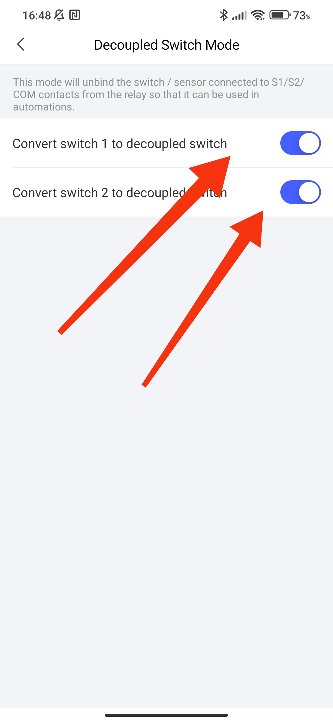

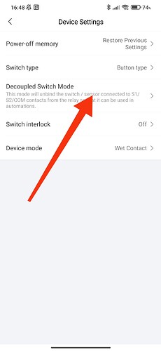

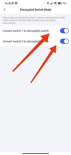

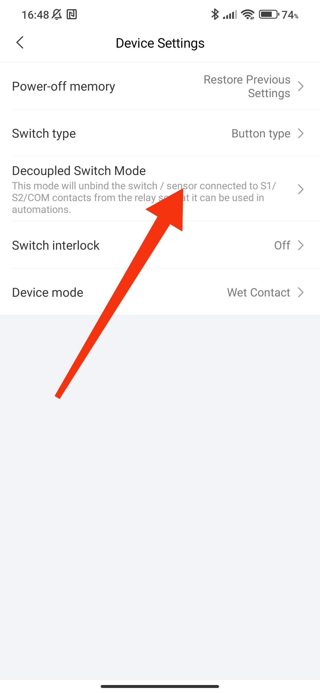

I made the automation you need. In the T2 settings, you need to switch to wireless switch mode (screen), after that everything works fine.

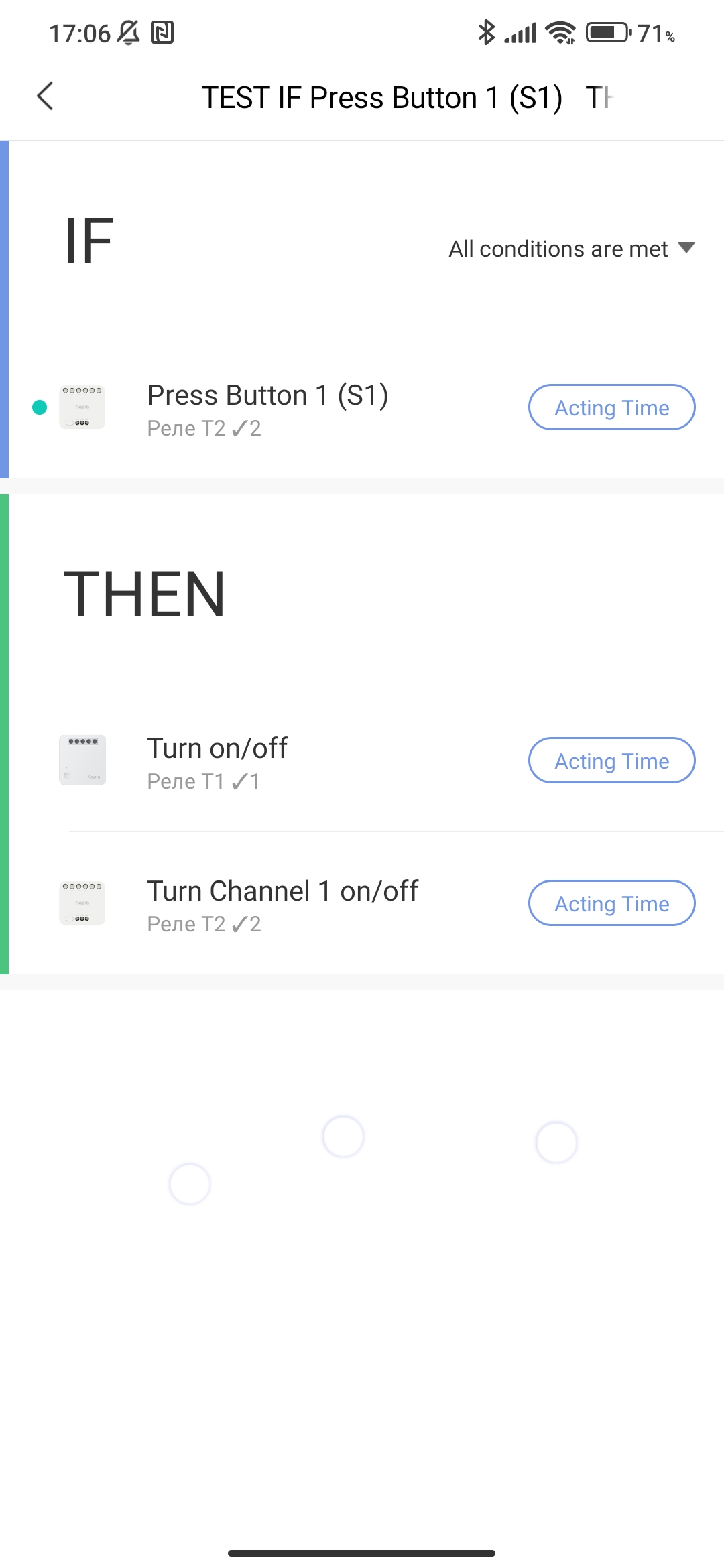

But there is one feature: to activate the T2 switch via the button, you will have to make another additional automation on On/Off (T2) because the physical button is disabled. Video of this automation.
