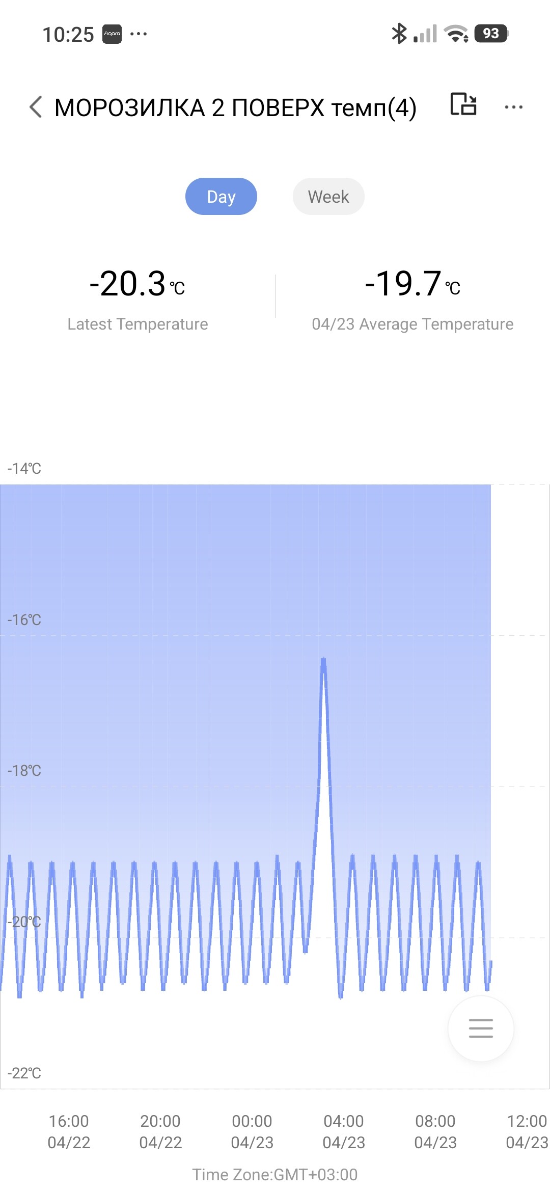

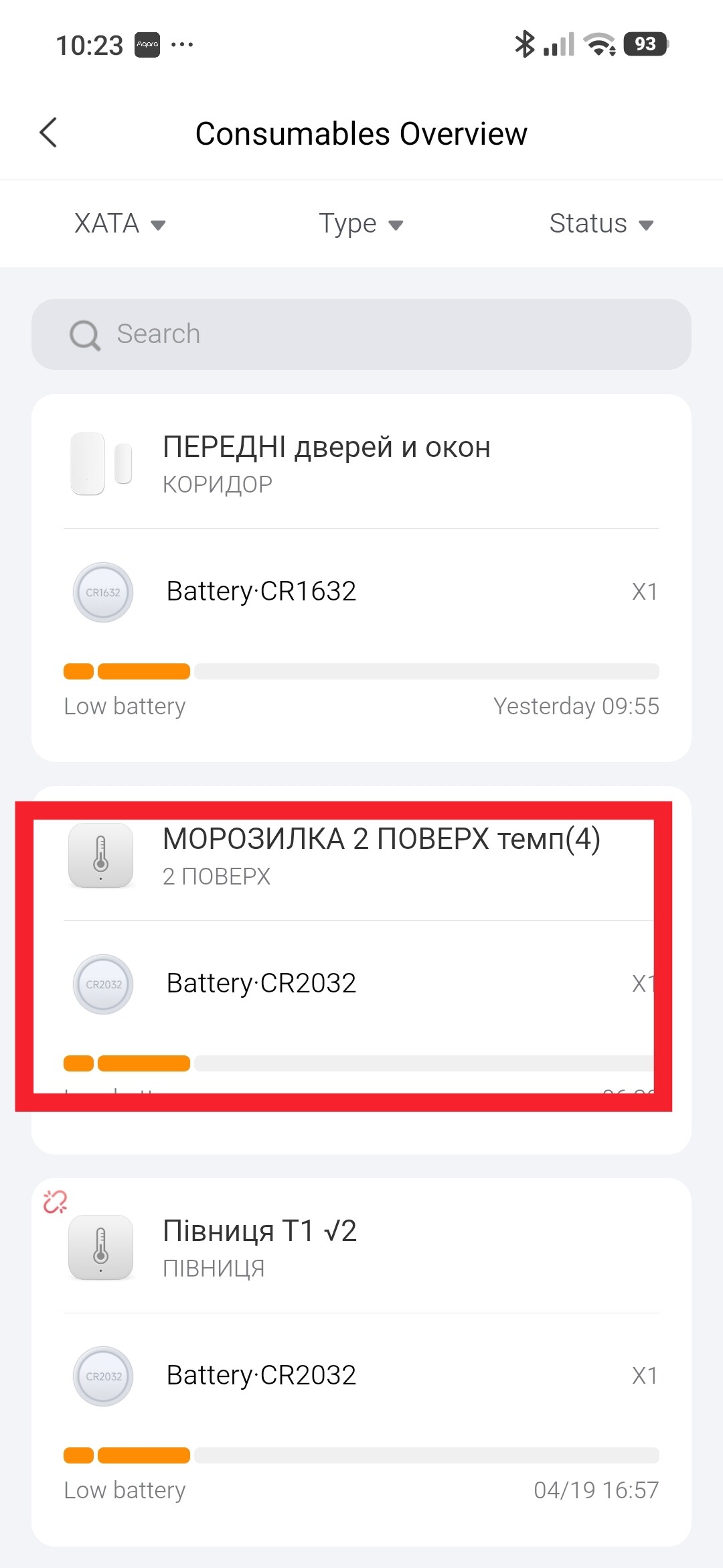

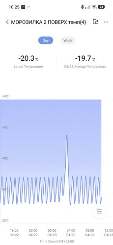

Check, maybe your Zigbee channel just drops for some reason. My sensor is constantly placed in a freezer (-19C°÷-20°C). The batteries last almost a year. The price of the batteries is inexpensive, budget.
