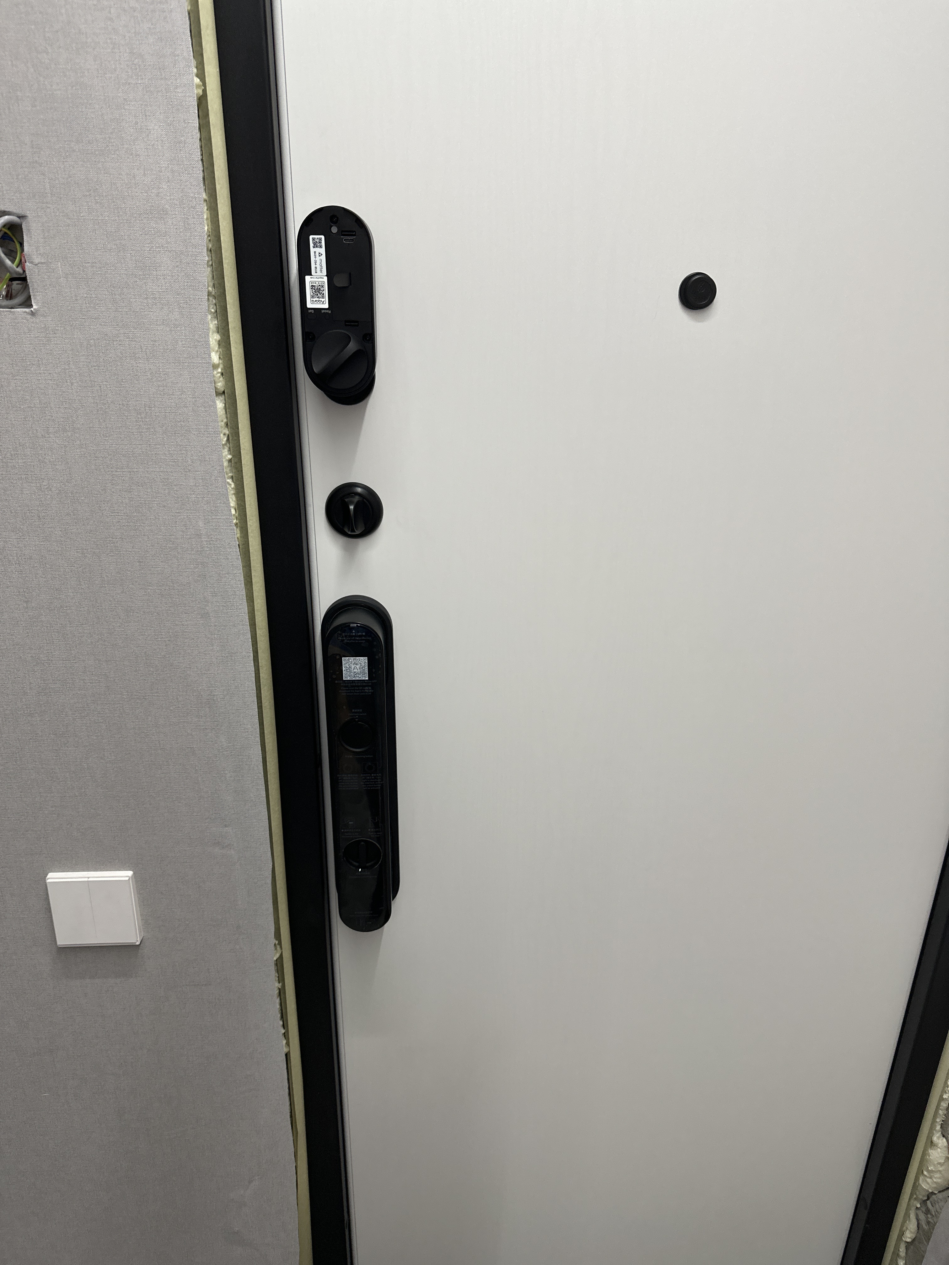

send a photo of your u200 installation. because this method is not suitable for everyone.
Here’s mine, it suits me.
