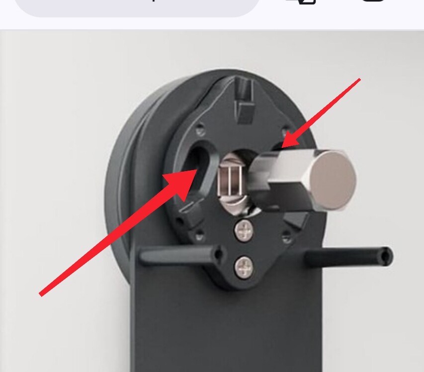

Mine is fixed with 2 screws in this holes showed in the photo, So it’s tight in position.

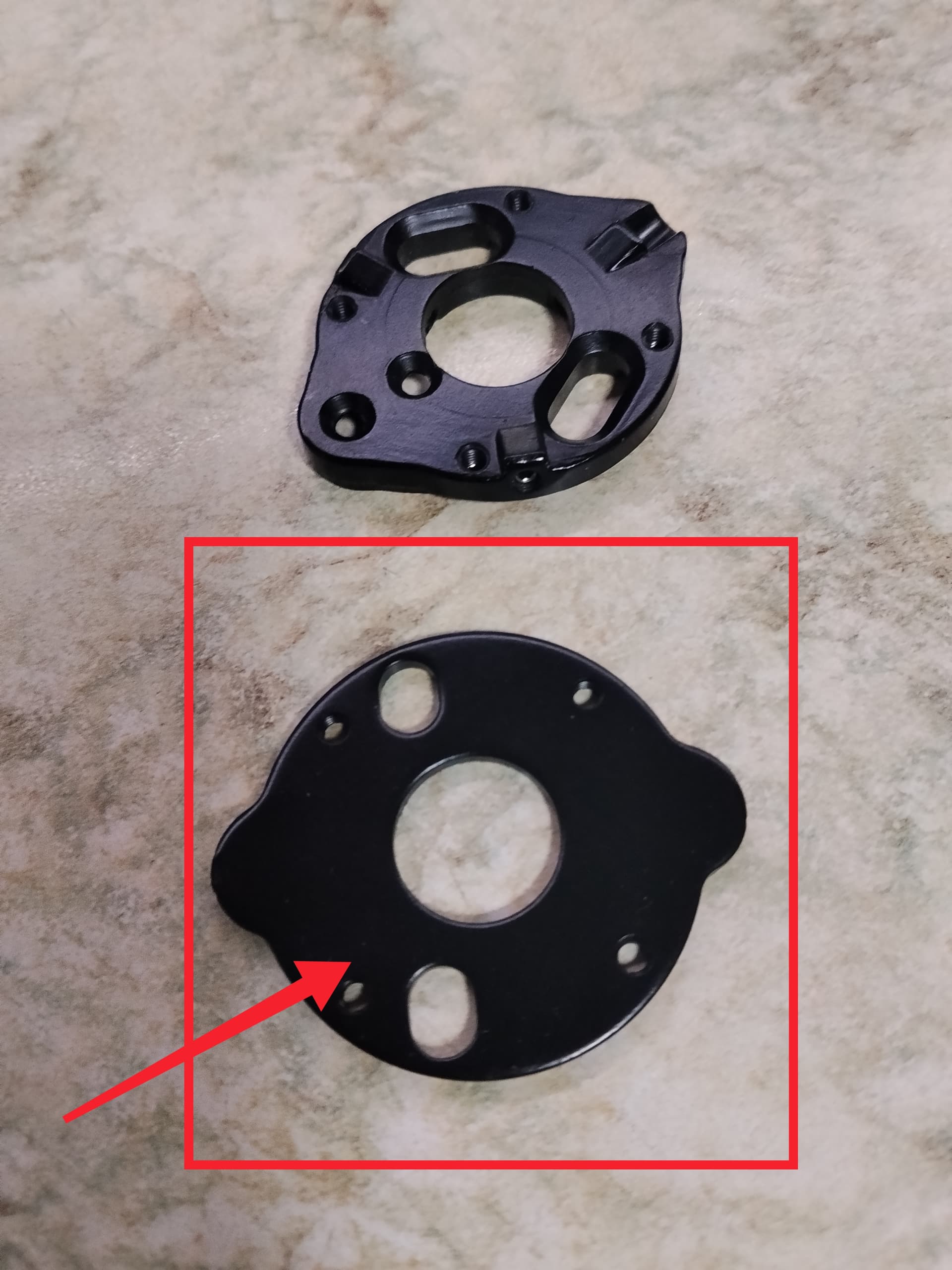

Hello, @Andrei.C .
I am not a fan of using your mounting method (small bolts + side shifters). The best way is to screw through bolts to the native lock mount (bolts are screwed in where the arrow is).
Fig.1.
If these holes do not fit your lock, use the additional insert that comes with the kit.
Fig.2.
Such a mount is more resistant to vibration of the lock during operation.
