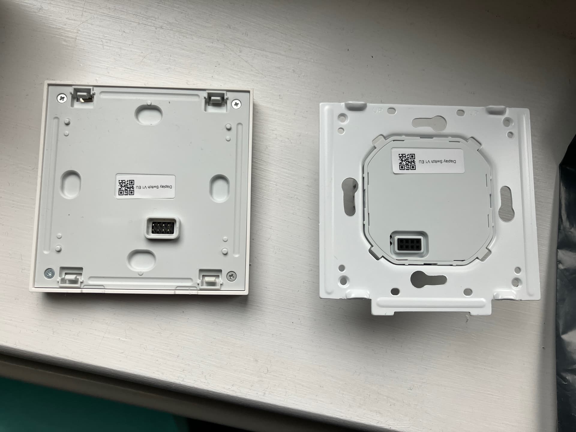

I’ve got a V1 Switch Display with a cracked display and purchased a complete replacement.
My questions are…
Can I just change the front cover / display?
Are the 2 parts linked to each other (specific) or can they be swapped over?
Which part has the “intelligence”?
The back part is the magnetic electric switch and the power supply. The front part has the microcontroller, screen and the buttons. You should be able to just swap the front part
So if I just swap the front part, will it become a new Aqara Device?
Basically yes
Great, thank-you
