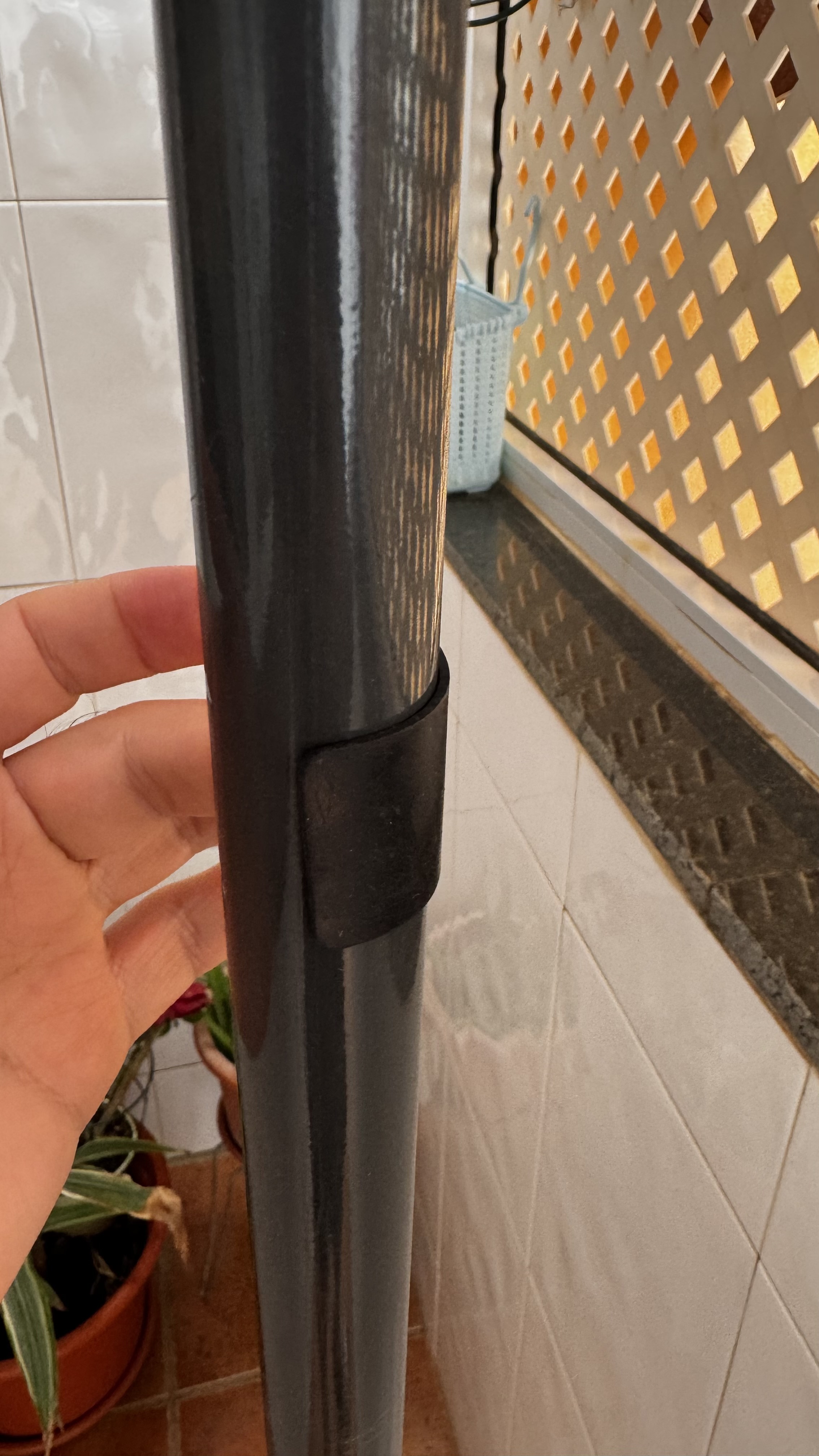

Hi guys, I am struggling to mount the damn thing… I am attaching the photo of the valve and hoping you have and tips - the original brackets are not ideal…

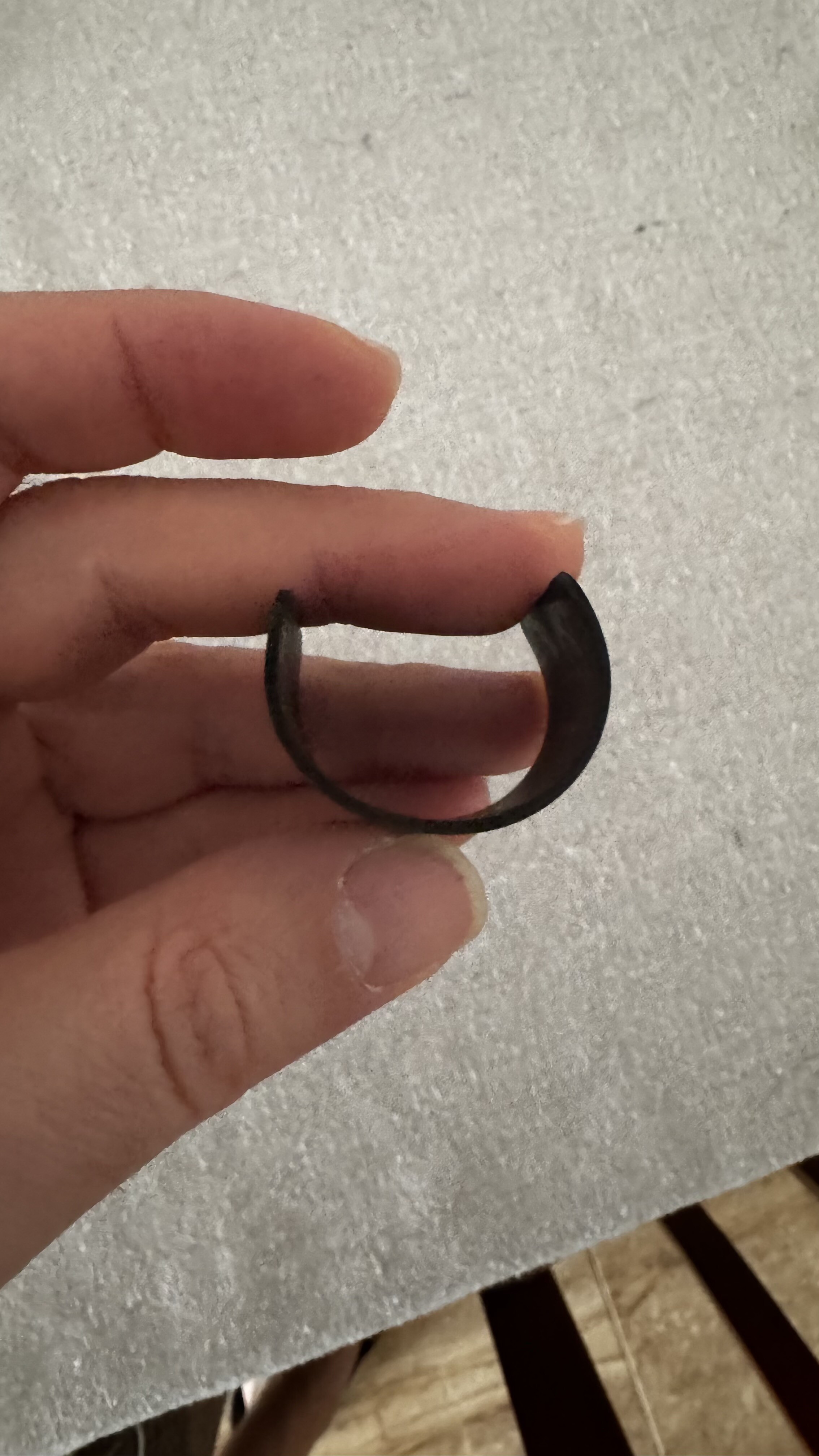

I tried using alle the brackets. The first one is to small, the bracket for larger pips is slipping when controller is trying to close the valve. And I made sure its mounted as tight as possible. Any homemade tips?

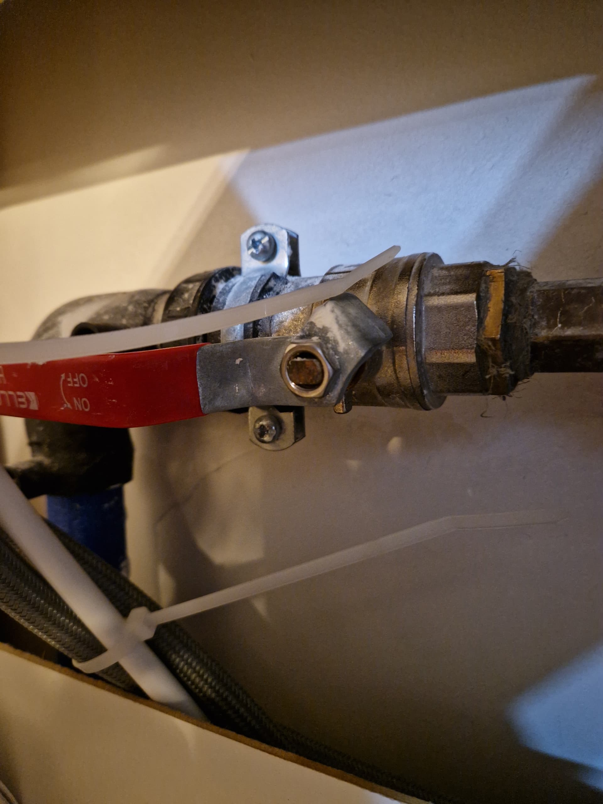

I’ve installed a few of these. They can be really tricky to mount because the hardware is meant to be a tight fit (and perhaps the brackets tend to be a little small -while the larger one can be too big).
In the end I’ve always made the standard brackets work. You want to mount it on the valve itself and not on the pipe. Lubricate the screws first to make them easy to go in. It may feel like it’s not tightening down all the way, but as long as the screws are tight and you do not see movement while the valve opens and closes you are ok.

Hm, what do you mean “mount it on the valve”?
Could you try selecting the place on my photo (first post)?
I agree. I put a holder in place so the the valve is working, it wont move from the bracket. I will take a pictures later this weekend.
