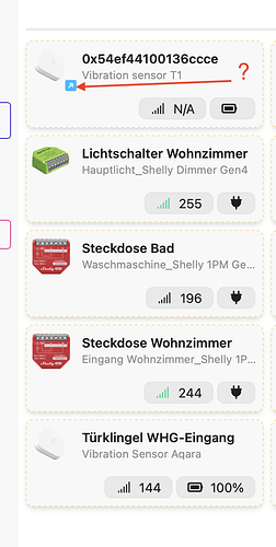

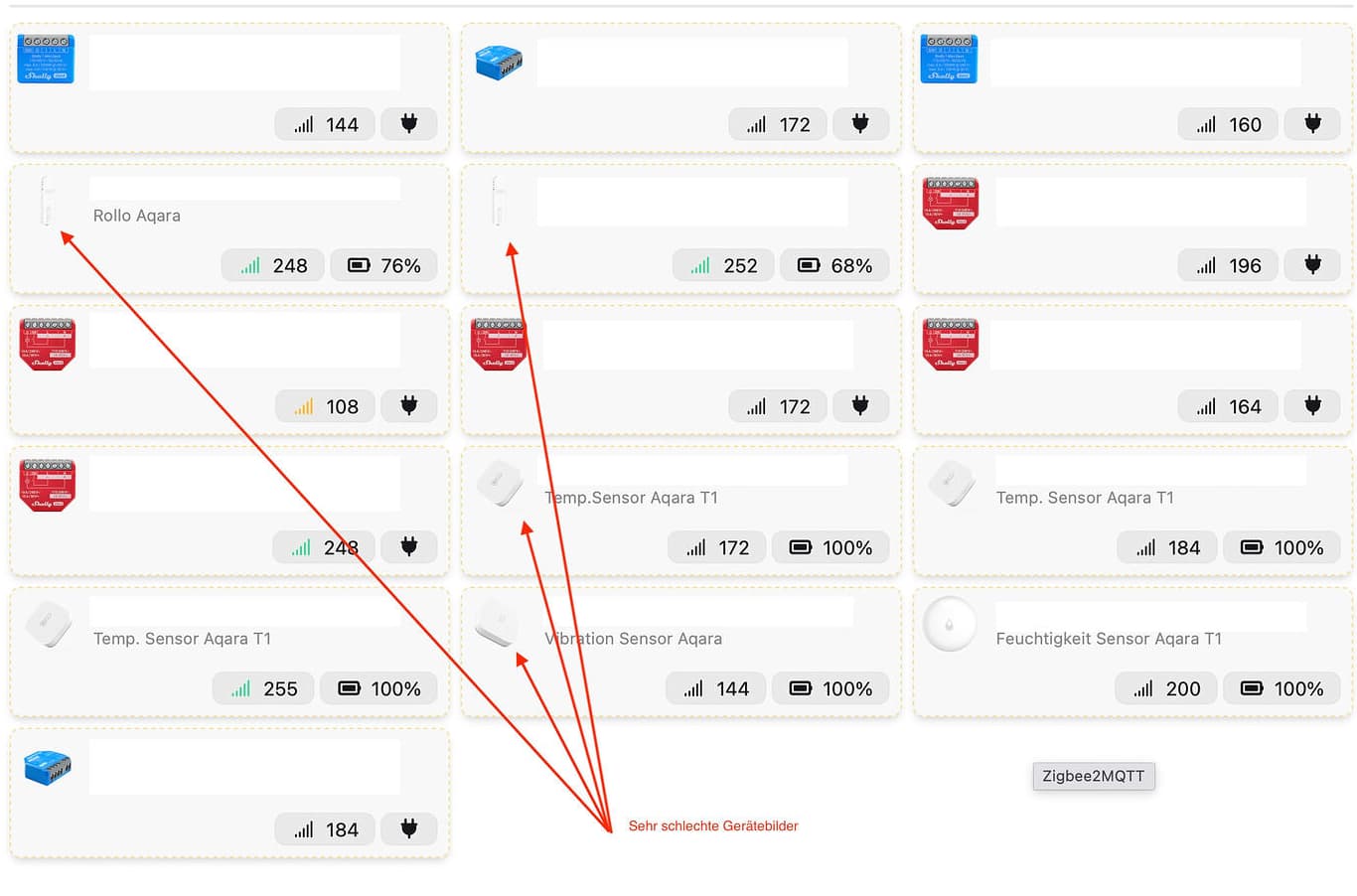

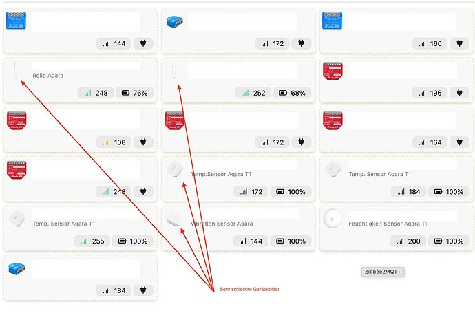

I have another question:
In Home Assistant, all the device images for my Aqara devices are faded, and so far no one has been able to help me with how to make them vibrant again.
I noticed this after a Home Assistant update.
The images are faded everywhere and almost invisible on my iMac, iPad, and iPhone.
Best regards, WolfgangP.
PS: Please excuse my poor English :wink:
No problem, you’re welcome. You add it in Zigbee2MQTT. Go to settings-dev console-External converters. Create a new converter, call it agl01.mjs, paste in the code, click save. Then restart Zigbee2MQTT and it should work.
In regards to Homa Assistant images, do you mean in the devices page list? Or the dashboard?

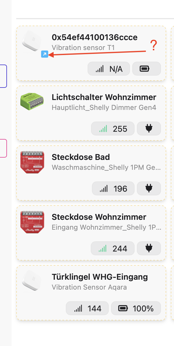

Home Assistant images:
In the Zigbee2MQTT interface:
Home, dashboard, and device view—they appear faded.
Image attached.

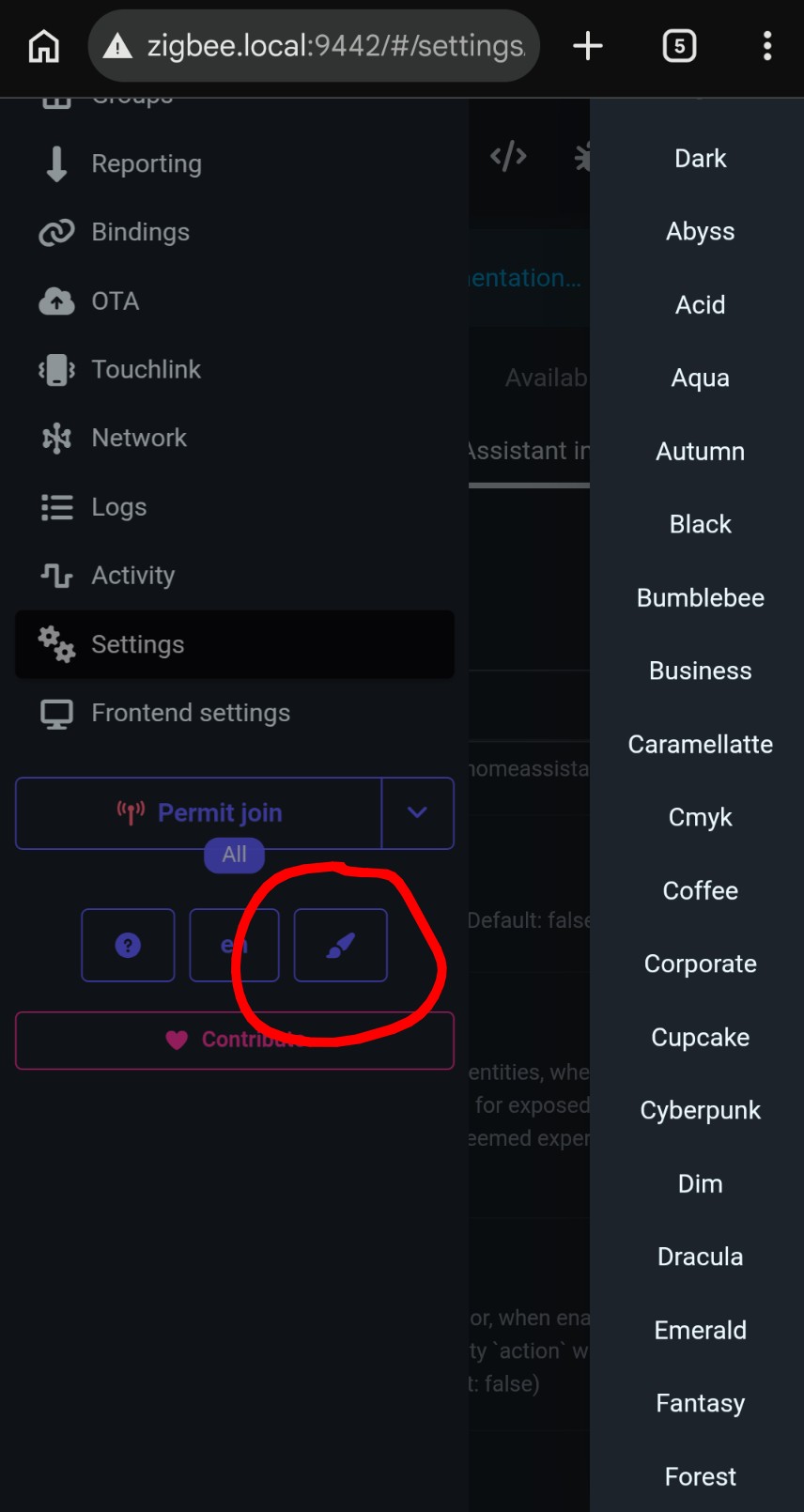

I think that’s simply because that are white devices, Zigbee2MQTT uses transparent backgrounds in device images, and you’ve got a white theme in Home Assistant. If you change to Home Assistant theme to dark do they show up better? The setting is in your user profile under User preferences.

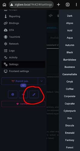

Edit: actually Z2M has it’s own themes too. It looks like you’re using the HA addon so the setting might be in a different place but in the standalone Z2M there’s a paint brush icon in the menu bar that opens the theme selector.
Edit 2:

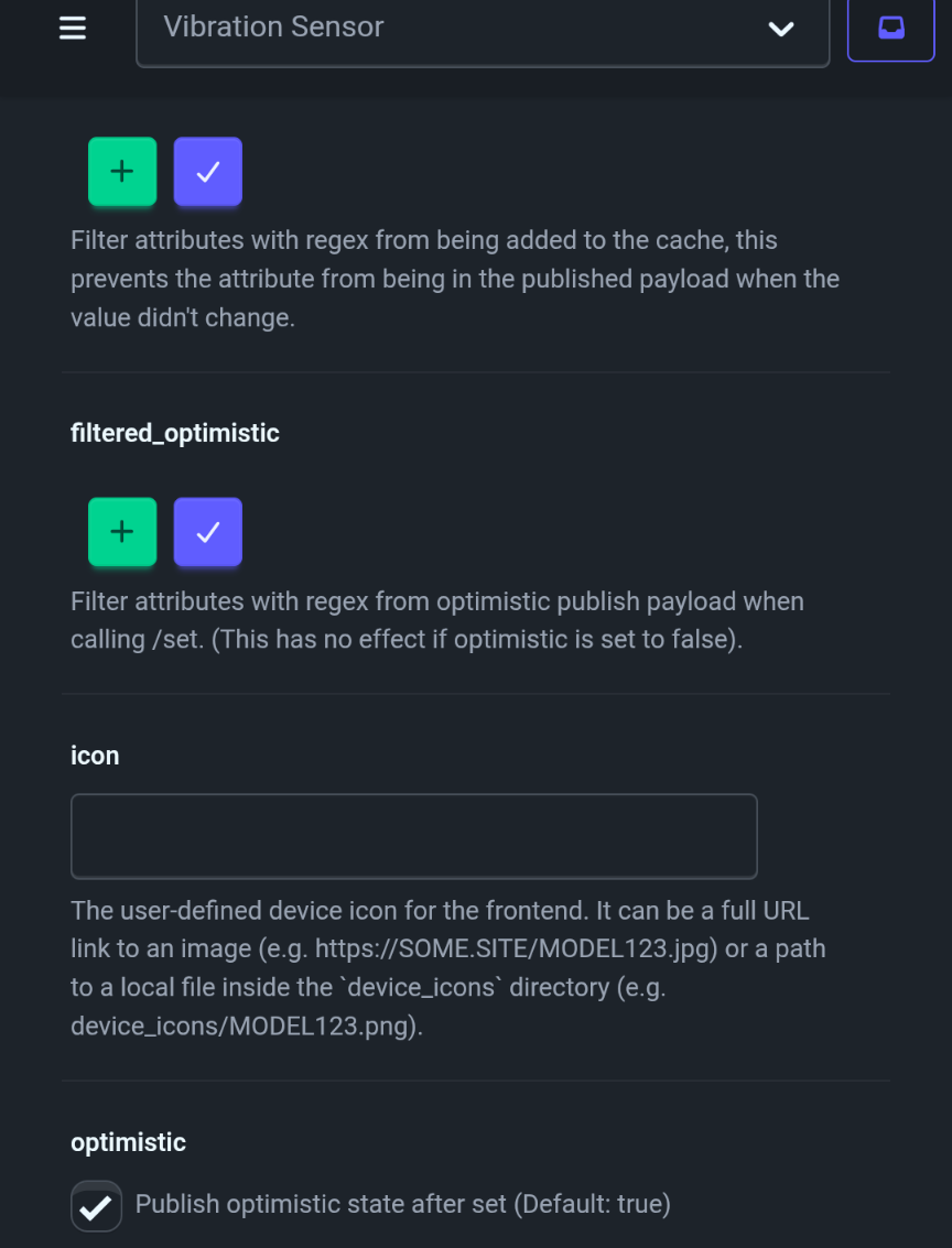

You can also set your own icon for each device under its settings:

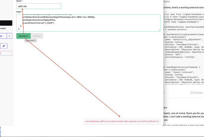

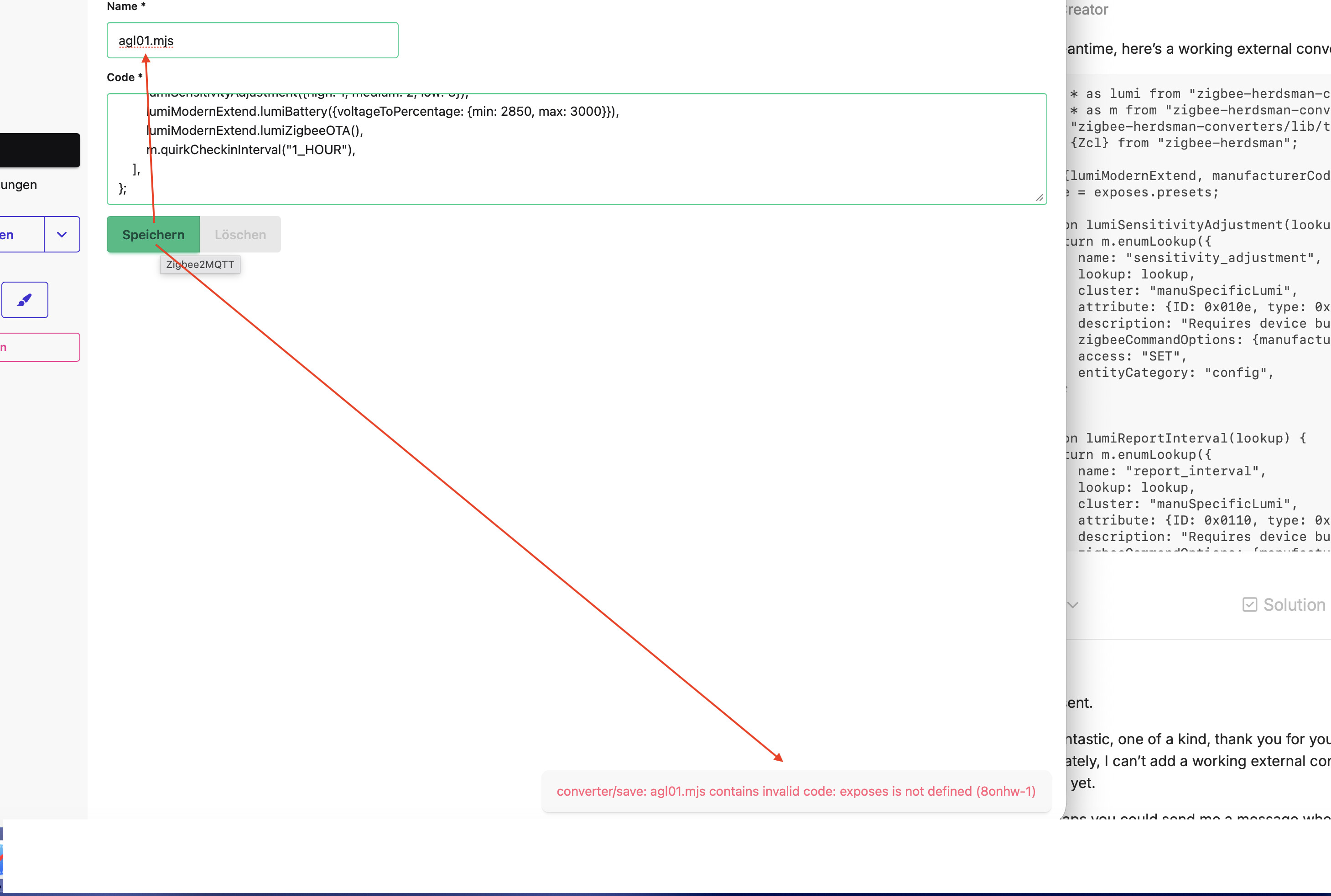

Hello,
Unfortunately, I’m getting the following error message when saving the code; see attached image.
Sorry, a line got chopped off the top it pasting into the forum. Try it again now.

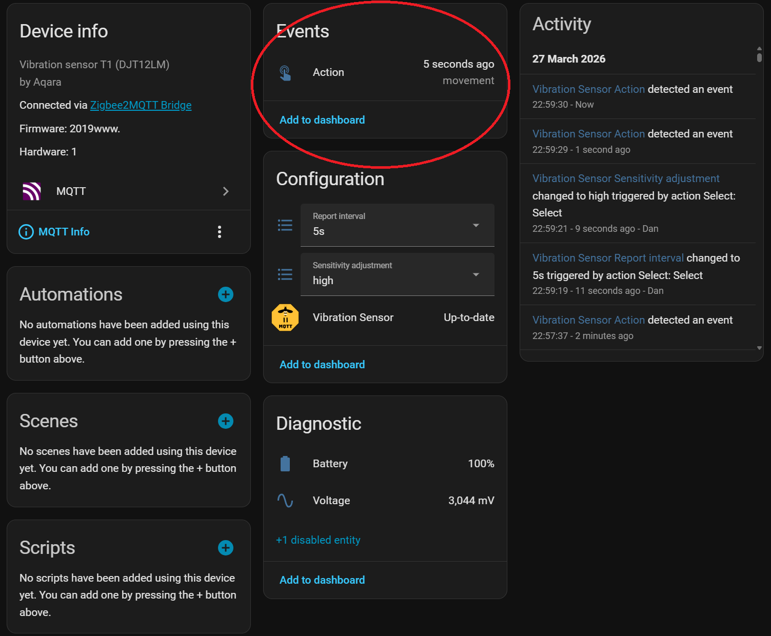

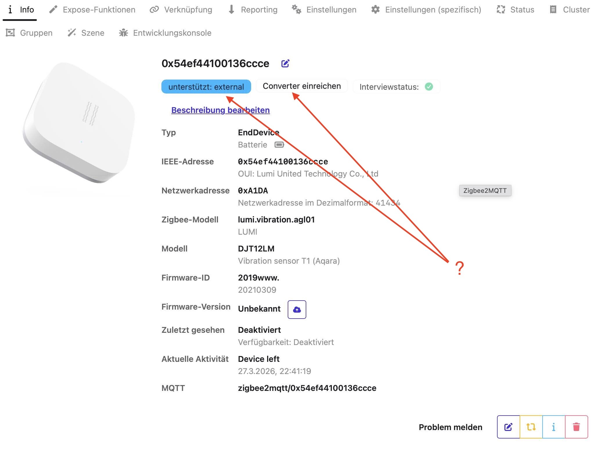

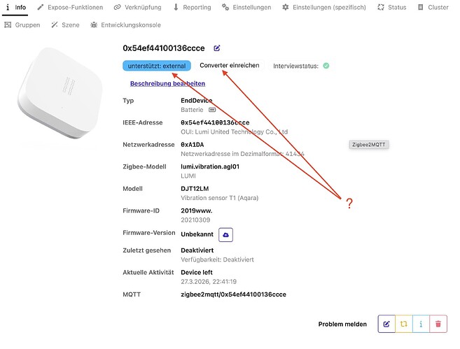

Unfortunately, the T1 vibration sensor isn’t working for me.
I’ve tried pairing it three times, but it’s still not working properly.
It’s not being passed on to HA!!!
It works in Z2M, albeit with significantly fewer features than its predecessor!
But it’s ready to go again much faster!
In the attached image, the text “Submit converter” keeps jumping around.
The text means it’s working with an external converter, that’s the code you pasted in.
It’s working fine for me in Home Assistant. Do you not see the events listed in the device page:
Regarding the features, it only supports movement and triple strike.
