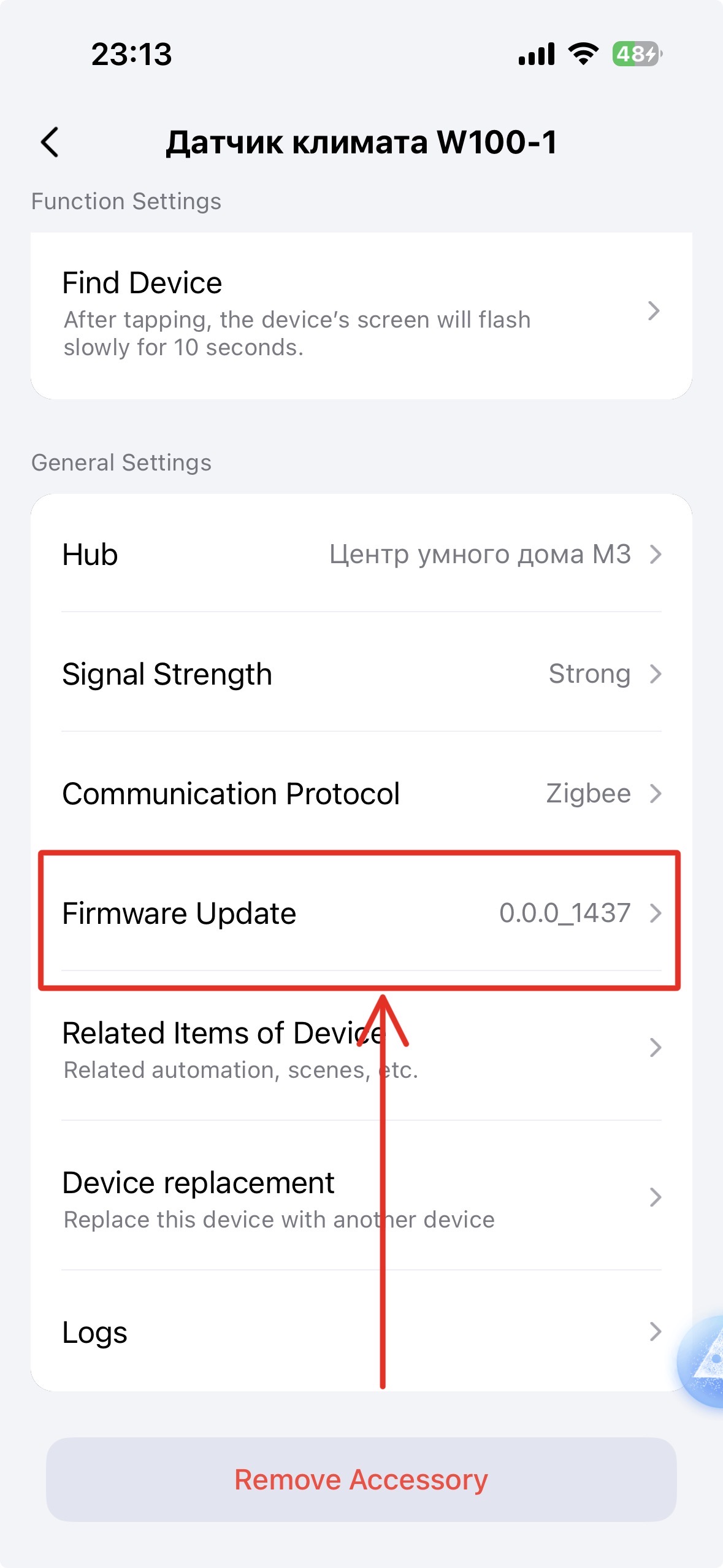

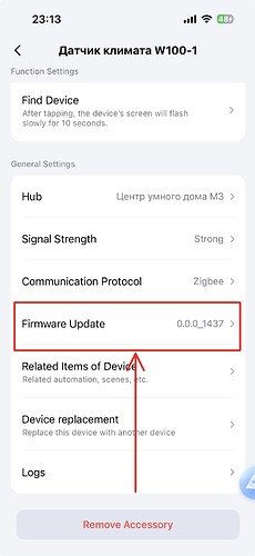

Hello @merdok
The w100 device in Zigbee mode can be updated via the device settings
or via the profile tab in the Aqara home app
Same Software here. I got mine today
This is the latest available firmware, we are waiting for more updates
