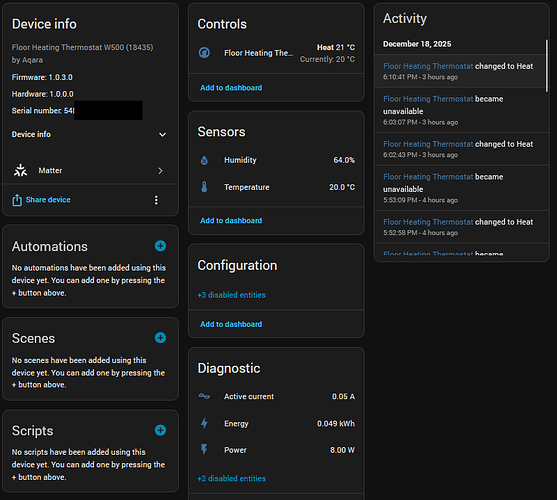

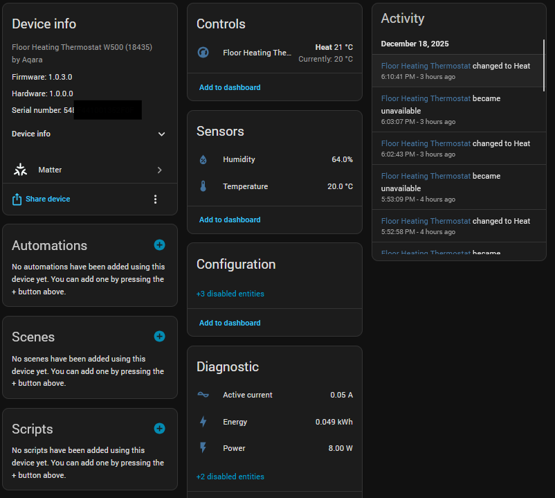

You must connect a load and heat it up for the values to rise above zero.
Otherwise, the entities will not appear.

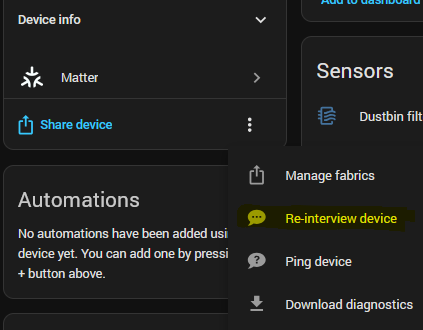

You should try to re-interview the device:
@hssmith Does it solve your issue?
Sorry, just realised emails from this forum were going to spam. Unfortunately this has not solved the issue, power and energy entities still missing.
Looking at the screen grabs, one difference is that mine is connected through the Hub M3 - it is that which was “Matter” discovered and as per your instructions I tried re-interviewing.

Mine is connected using the Thread protocol.
