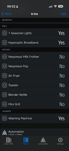

First is the “In Use” feature of Apple Home, I love this feature it lets me find a free socket at a glance in any room. All my other smart sockets that support HomeKit have this feature, It’s really simple, if the socket has a plug in it its shows as In Use even when its powered off. The “In Use” state is separate from the “Power” state.

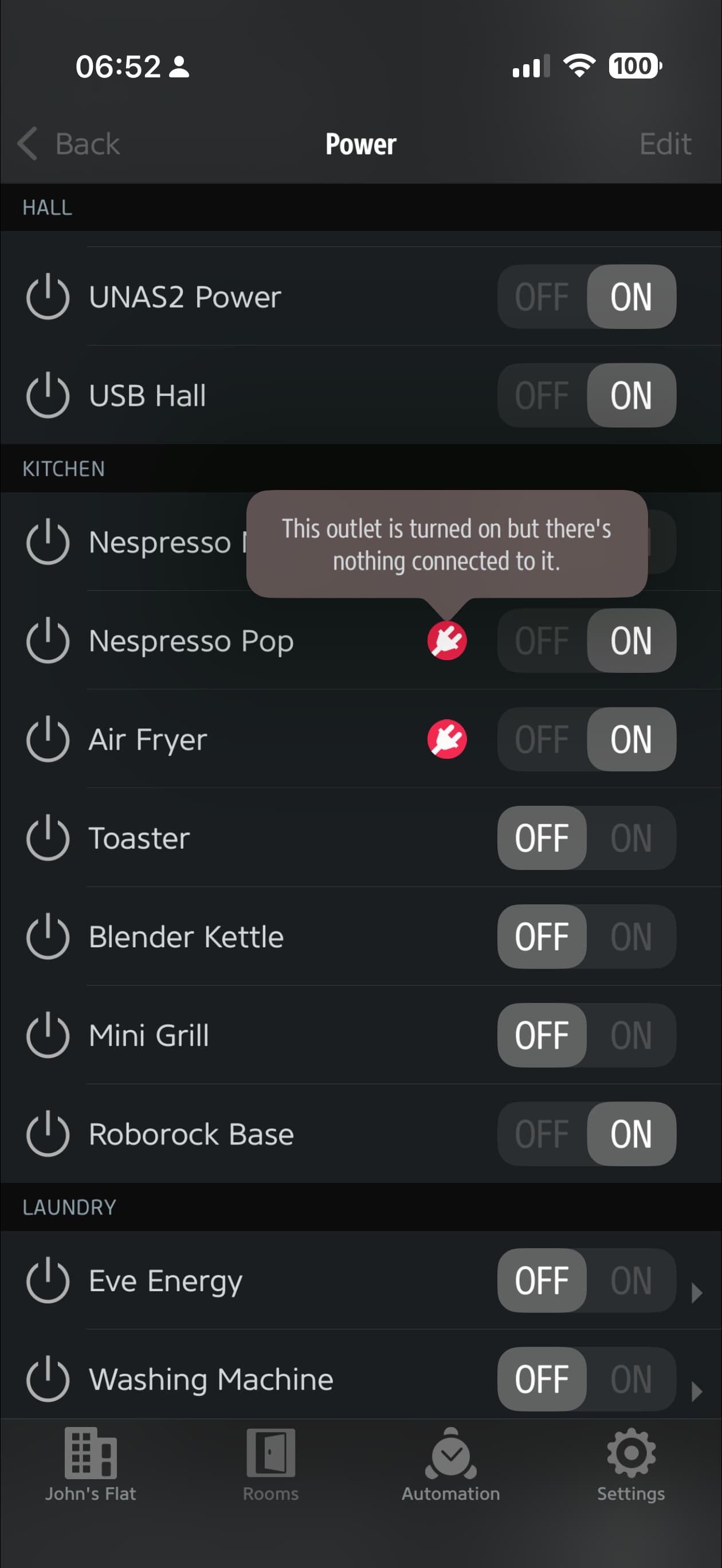

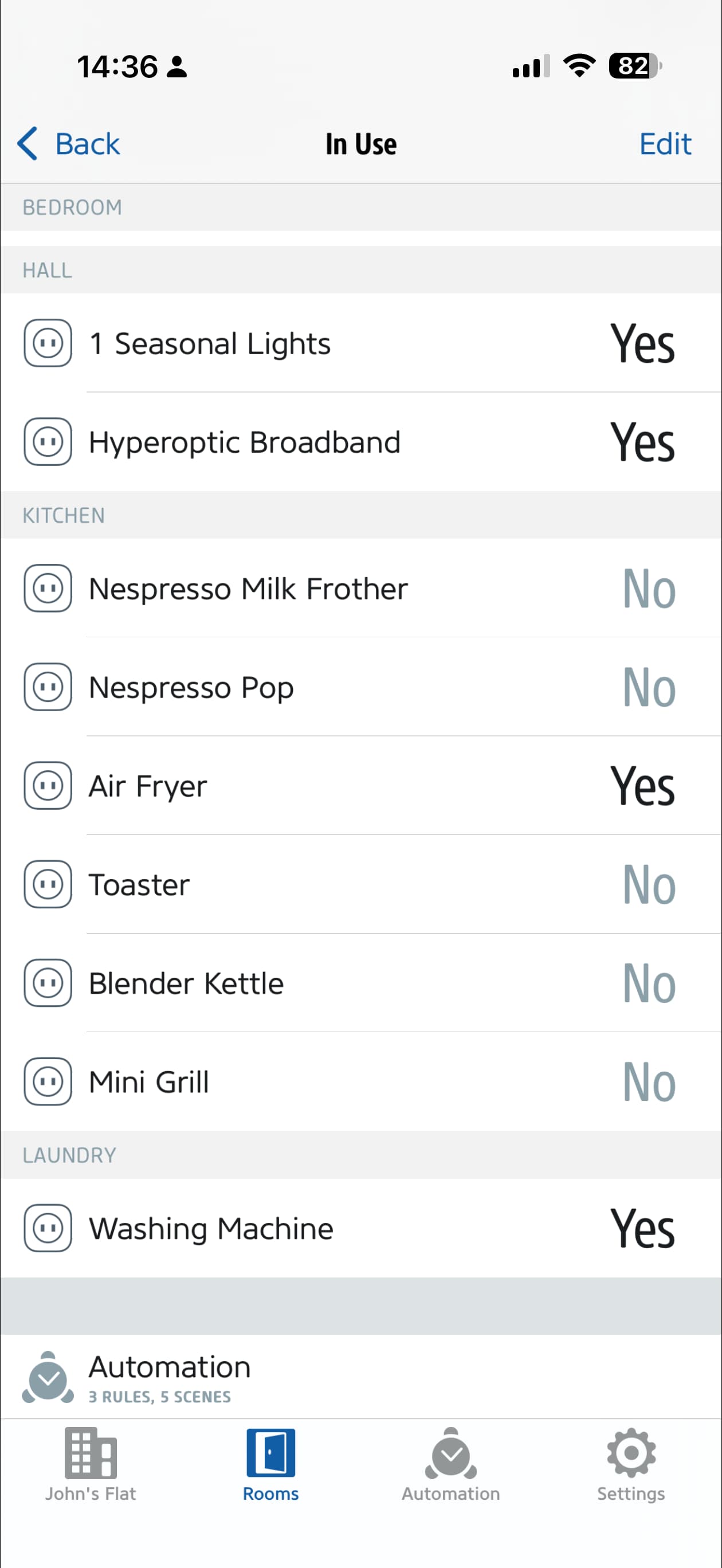

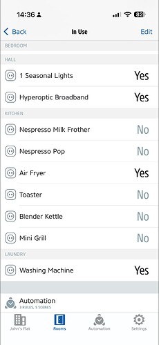

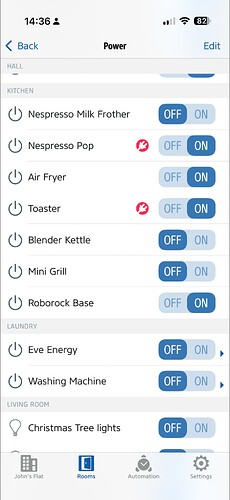

That said, the Aqara Wall Outlet H2 UK does not correctly support this feature. It only shows as In Use when the socket is powered on but this is not consistent, even with a device pugged in and the socket powered on it can still show it’s not in use. In that case you get an error message from some apps that support Homekit, The screenshot below is from Eve and you can see the error message. I should point out all the sockets with names have that device plugged in.

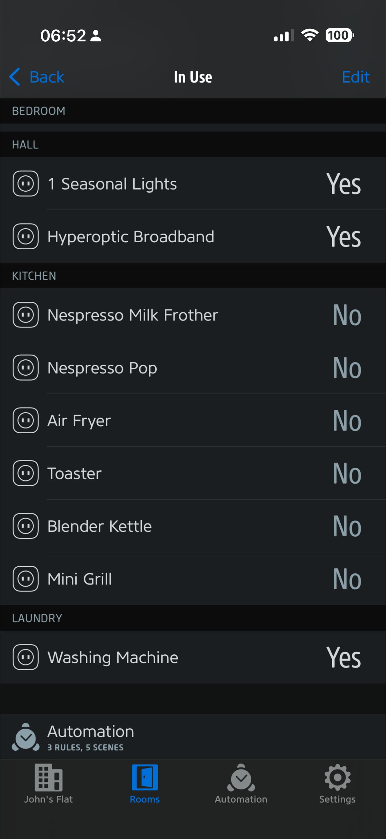

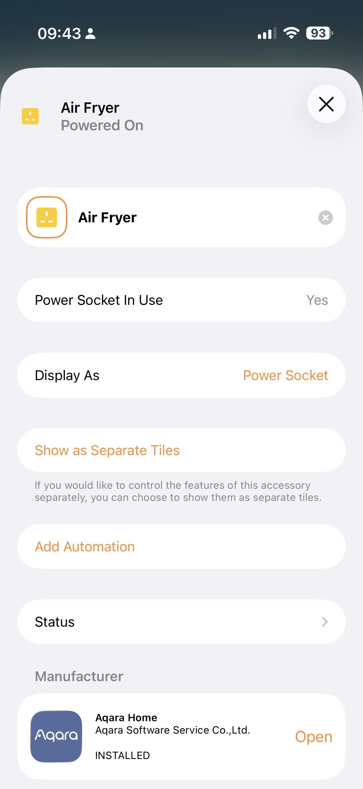

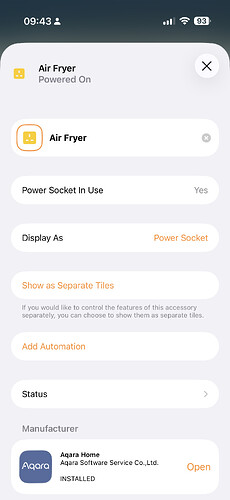

The image below is after I removed the plug and re-inserted it, the socket is powered on and this time it shows the “In Use” state as Yes.
EDIT: correct photo added. Sorry!

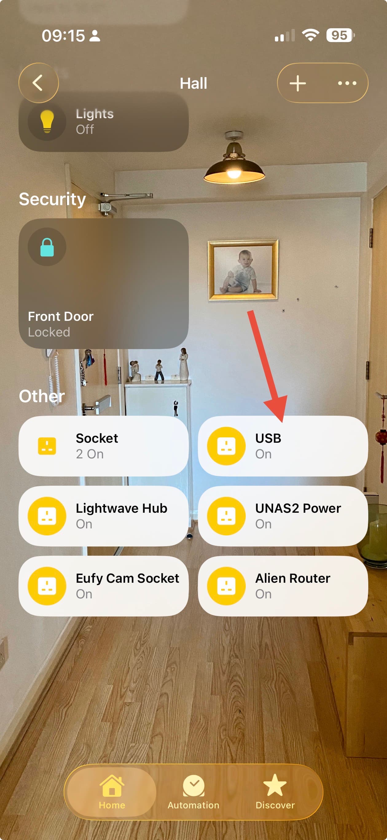

My second point has been mentioned before in some video reviews. It’s a strange one as there is no logical reason why the USB-C ports are not exposed to HomeKit as a third switchable socket. I have Meross power bars that expose the USB ports as a single switchable socked in Apple Home, they are HomeKit enabled, not Matter.

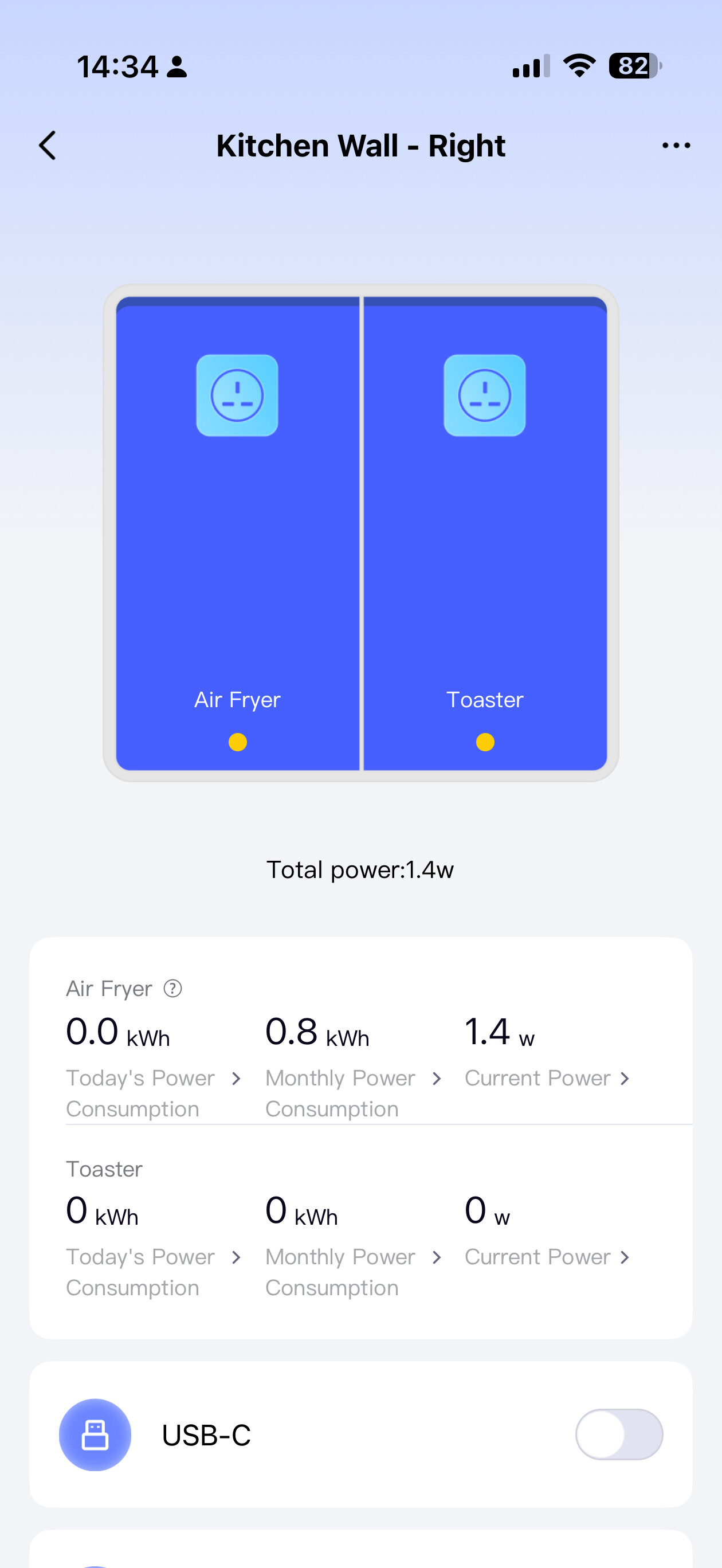

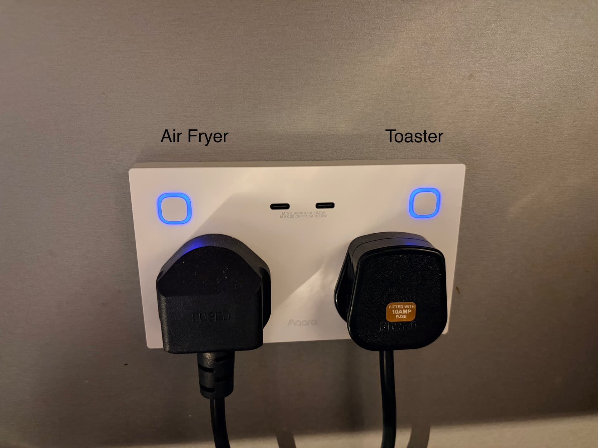

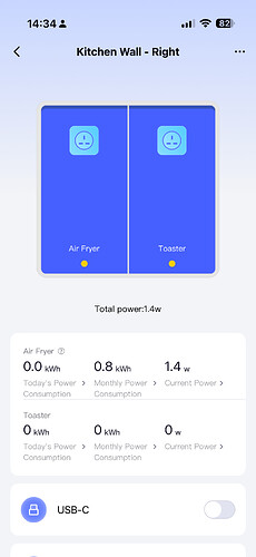

This is a photo of the socket with both devices plugged in and sockets powered on. As you can see from the Aqara app screen shot, the Air Fryer is drawing a small amount of power, it’s connected to wifi so always draws some power. The toaster is not being used. The Eve app shows the Air Fryer outlet is “In Use” that is technically correct as there is a plug in that socket. The toaster does not show and it should as it’s plugged in even when it’s sitting idle.
From what I can work out, the outlet “In Use” appears to record true (Yes) only when the device is drawing power and that is incorrect based on the specification.
