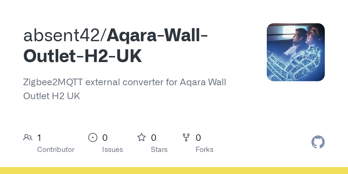

Aqara Wall Outlet H2 UK Zigbee2MQTT support
Here’s a Zigbee2MQTT converter to add support the Aqara Wall Outlet H2 UK. It should be included in the January release of Z2M.
Features supported include power measuring, multi-click actions, child lock, indicator light settings, and overload protection.
If anyone knows the ZigbeeModel for the single USB-C version please let me know and I’ll add it. I assume it might be lumi.plug.aeu003

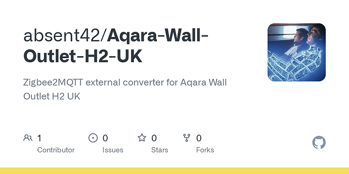

First of all. Thanks for the converter. Unfortunately it seems I have done something wrong, because when I try to turn off the led, it doesn’t seem to do anything. I can see in HA, the power usage and it switch on and off with no issue, but the other functions (led indicator, child locks and flip led) doesn’t seem to work for me… Any idea?
What version of Z2M are you using? I may need to update it for changes made in v2.9.2
I have at look at this evening.
I’ve updated the code in the Github repository for compatibility with Z2M v2.9.2+, it should work for you now.
It worked like a charm!!! Thanks !!!
