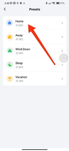

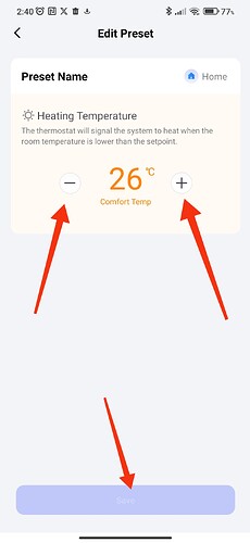

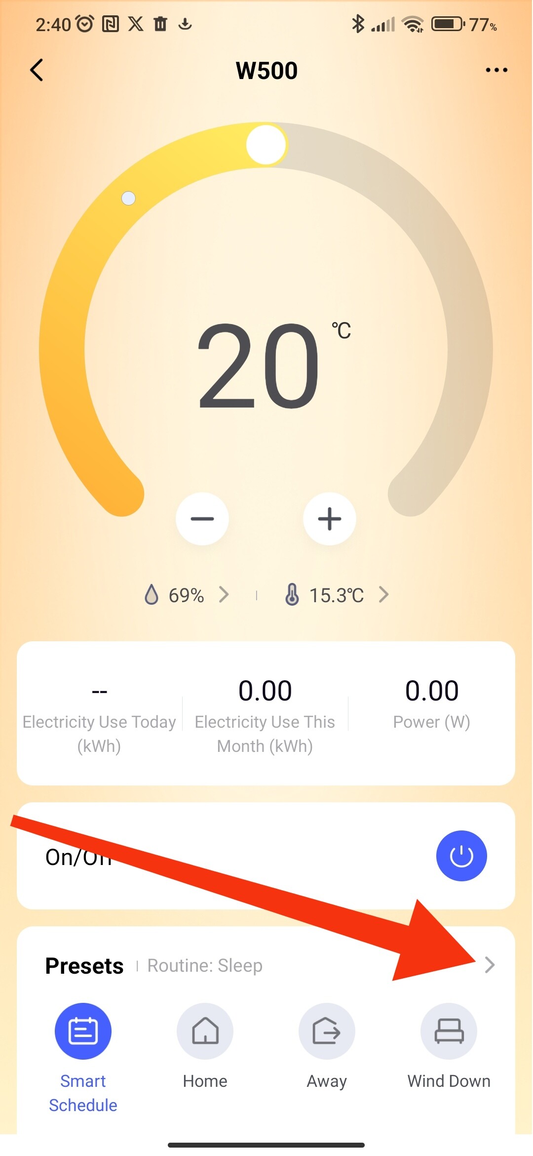

Hello, if you are talking about this setting, then that’s how it should be.
That should be the functionality, yes. However, I ma not using the Aqara app nor the hub, I’m integrating the device into Home Assistant through Zigbee2MQTT and the entities required to do that don’t seem to be exposed there…
