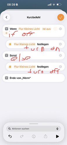

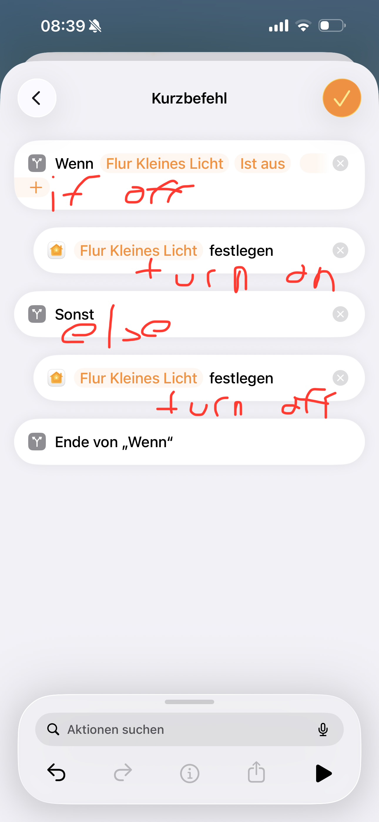

You can create an HomeKit Automation:
This way the lights turns on. And if it’s already on, it’s turn the lights off.
