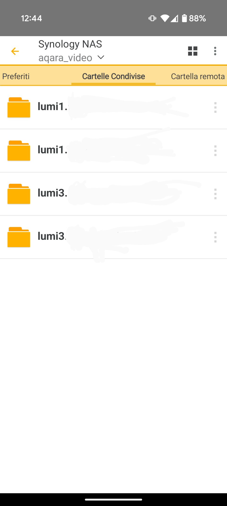

Yes, I can confirm this as I have four Aqara cameras at home. After each recording is made to the SD card, the same video clip is transferred to the NAS in short clips of less than a minute. It all depends on your settings, such as continuous recording, motion detection recording, or something else. Also, remember to power your device properly.
Interesting post I do have a DS918 does that work
@d_duskan Hi, yes I save my camera recordings on my DS718+ without any problems. I have two Camera Hub G3s and two Camera G100s.
The Aqara app automatically creates folders for each of your cameras and suggests saving everything to the default video folder on your NAS. Of course, you can also change the file storage location.
