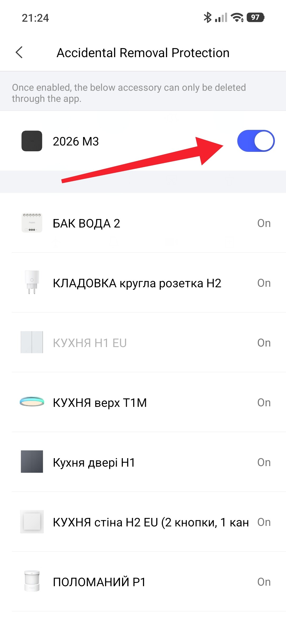

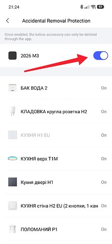

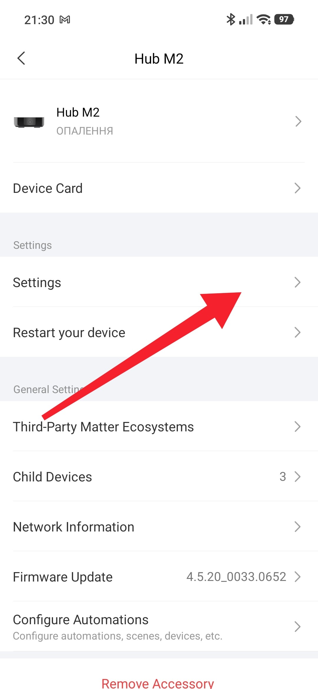

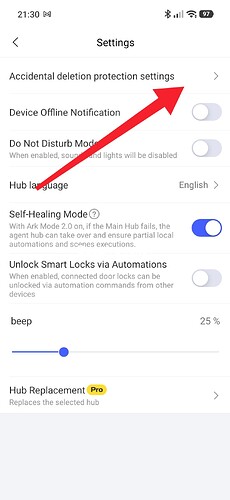

Procedure.
  1. Disabled protection.
  2. Re-added the device.
  3. Enabled protection.

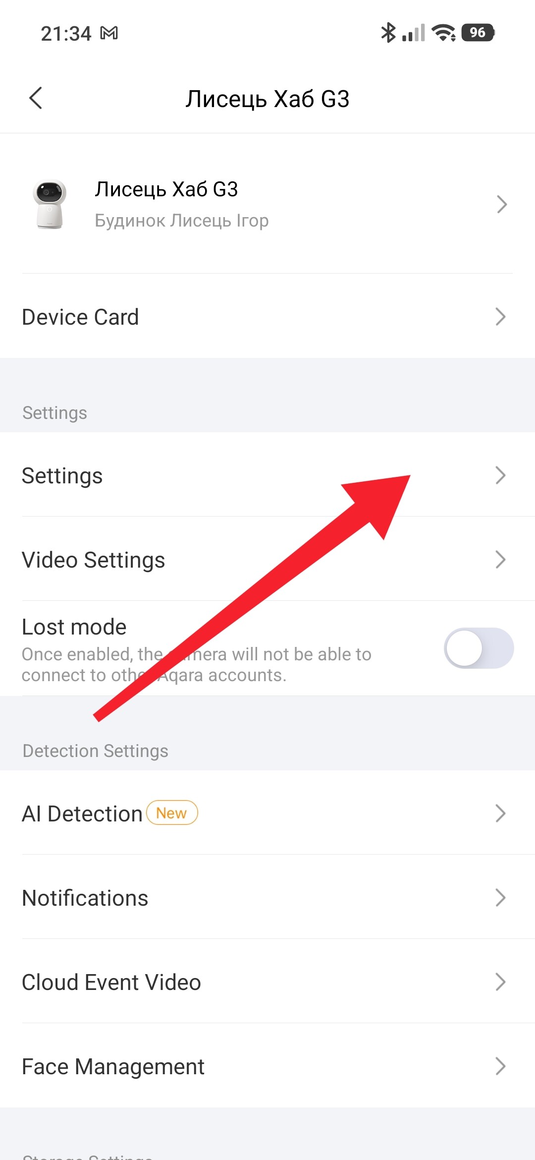

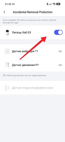

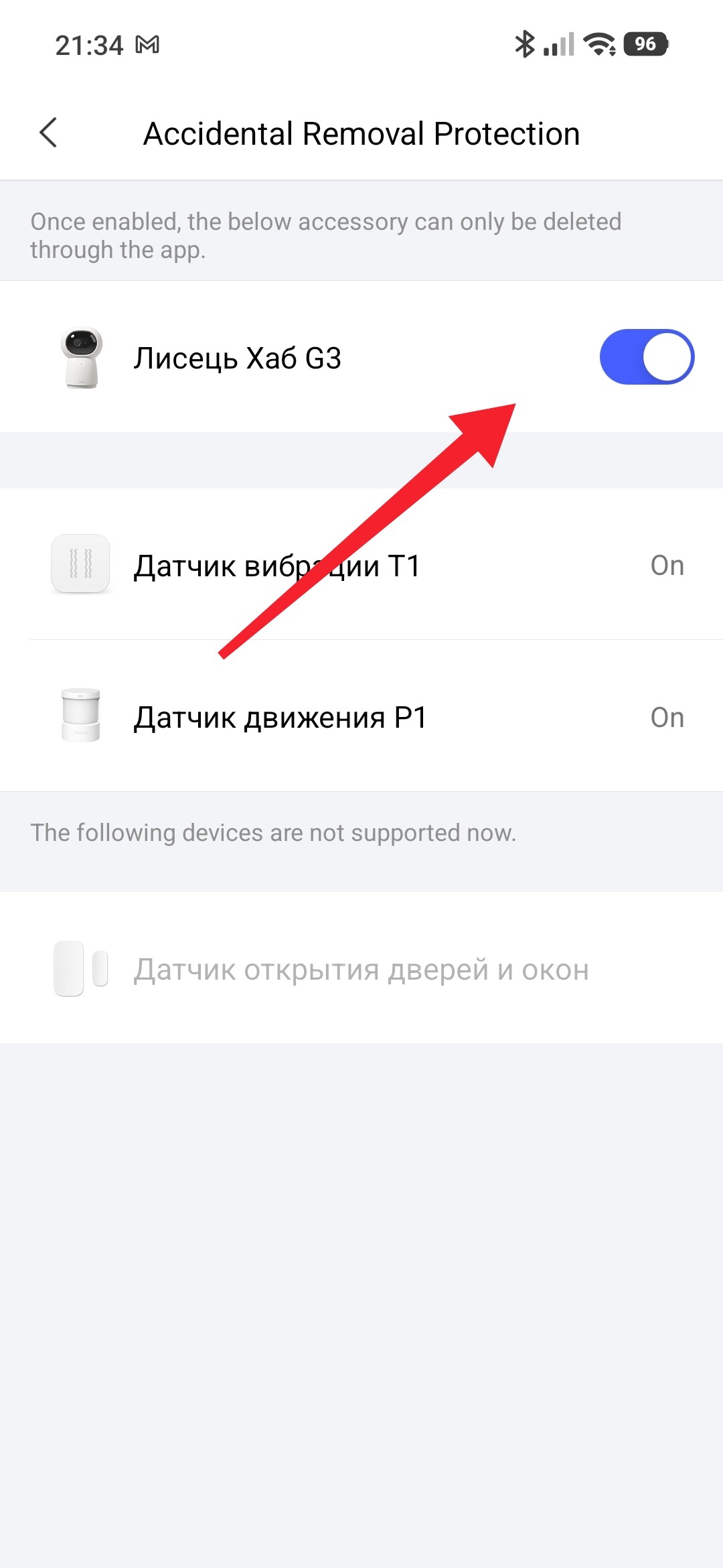

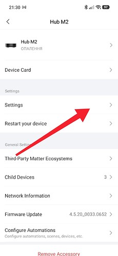

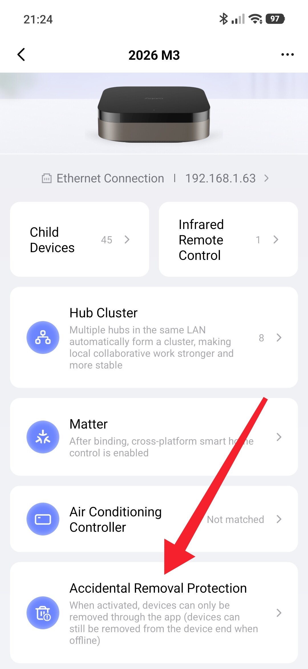

Settings screens where this function is located for the M3 gateway.
Fig.1

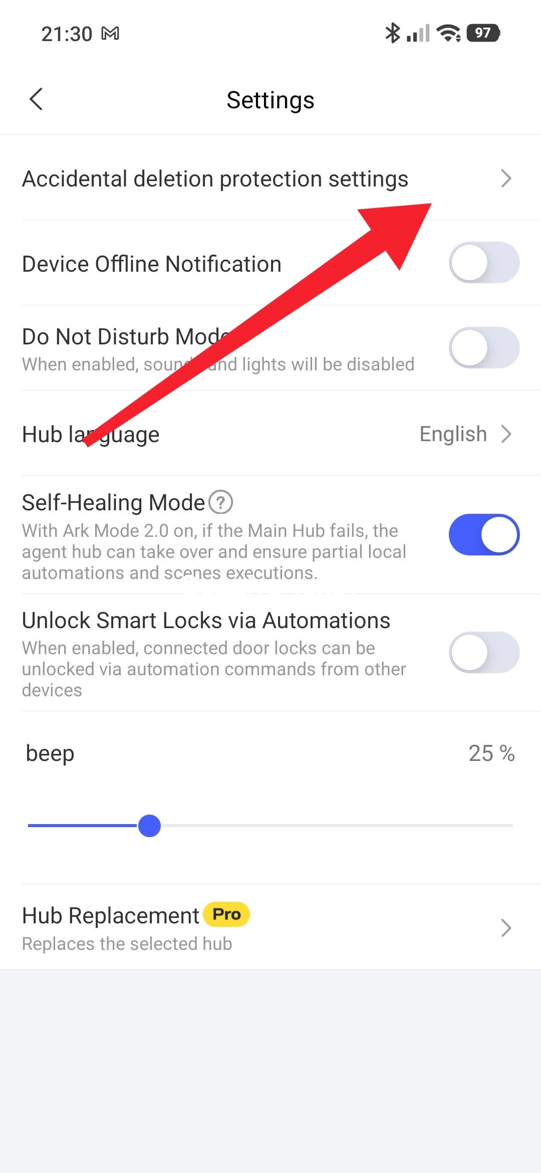

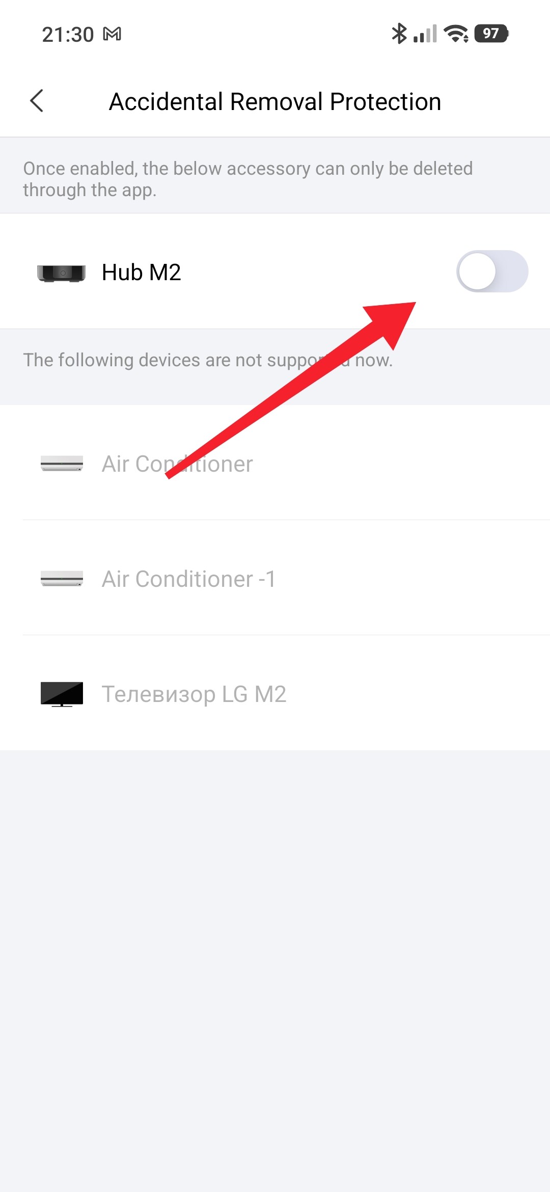

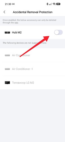

For M2, M100 gateways.
Fig.2

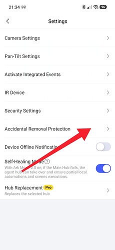

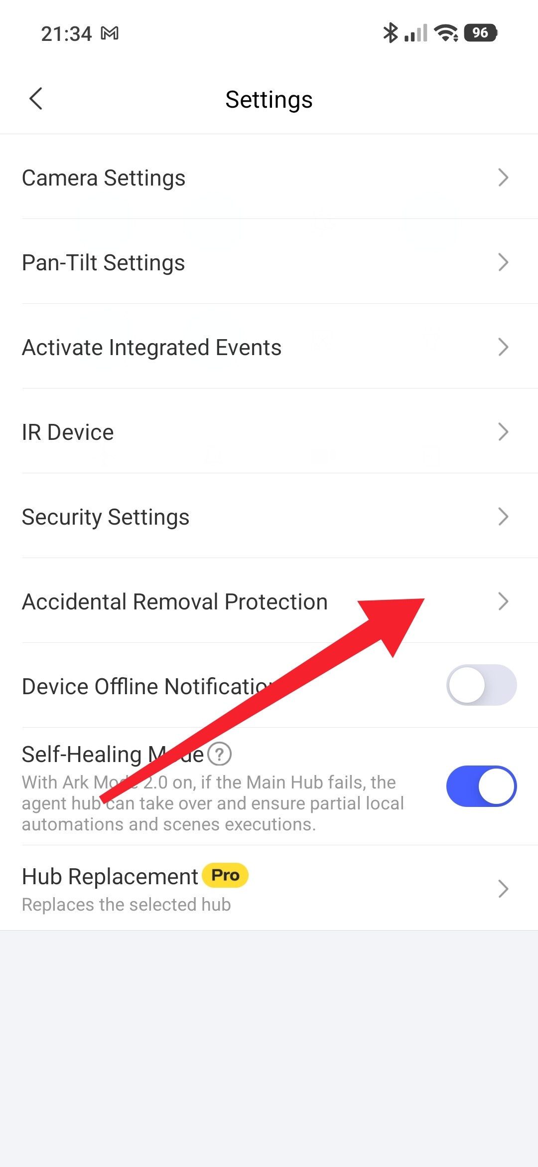

and all types of cameras, video calls that support the gateway function.
