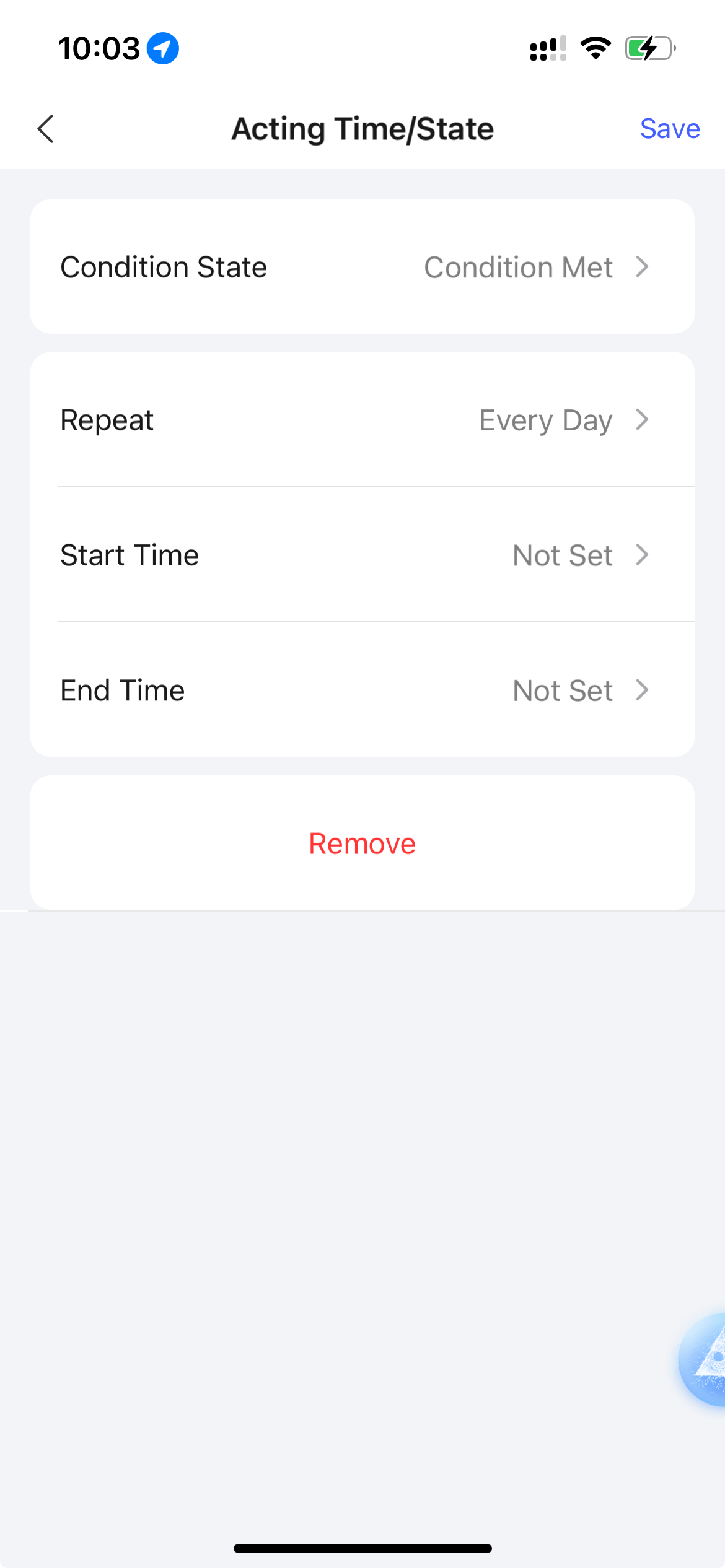

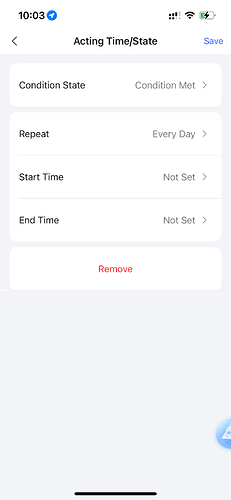

  1. Acting Time / State - under each device in your IF condition there is a button on the right for “Acting Time” where you can set conditions individually “met” or “not met.” If you set your device “Door Is Closed” to Not Met, this might help.
