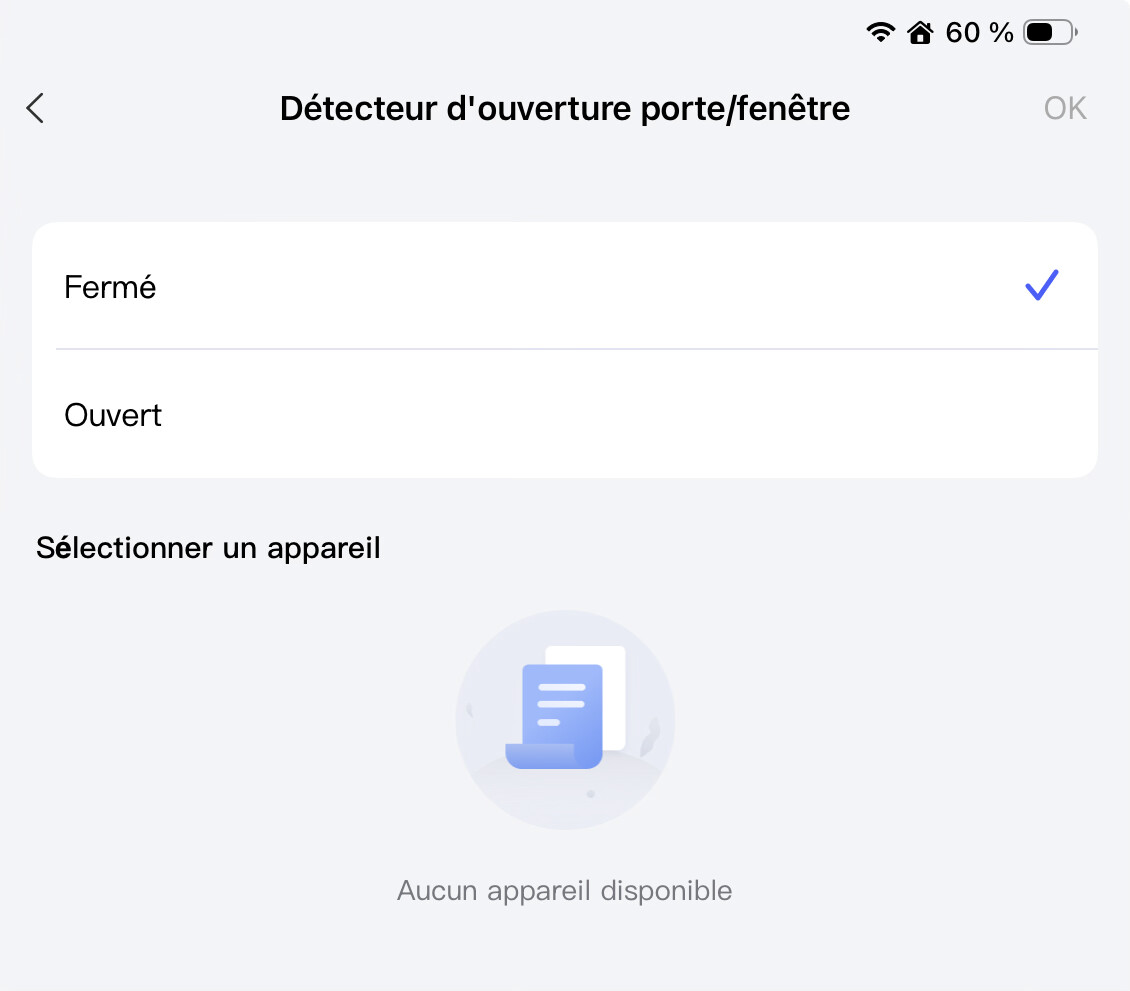

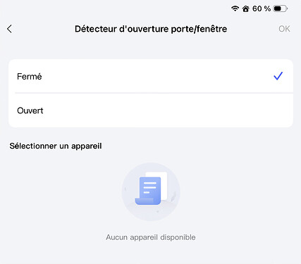

Hi, I’m not sure whether this issue is related to the French interface, but Automation 2.0 seems to have a bug with grouped devices.
Normally, grouping should allow devices with the same capabilities to be combined into a single group, making it easier to create automations based on that group.

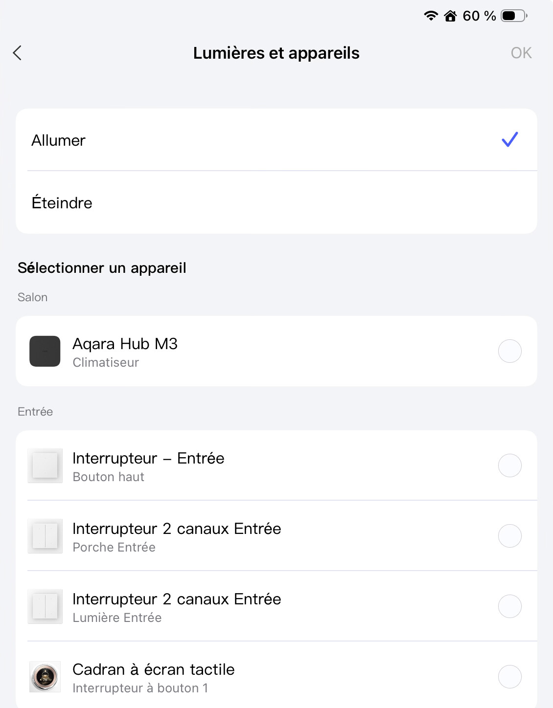

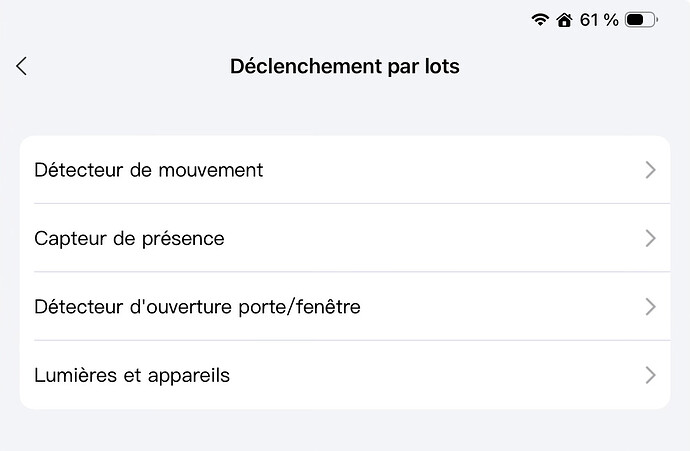

However, when selecting certain groups, no devices appear in the list. For example, the “door sensor” group is completely empty, even though I have three door sensors installed.
This one, should display 3 door sensors.

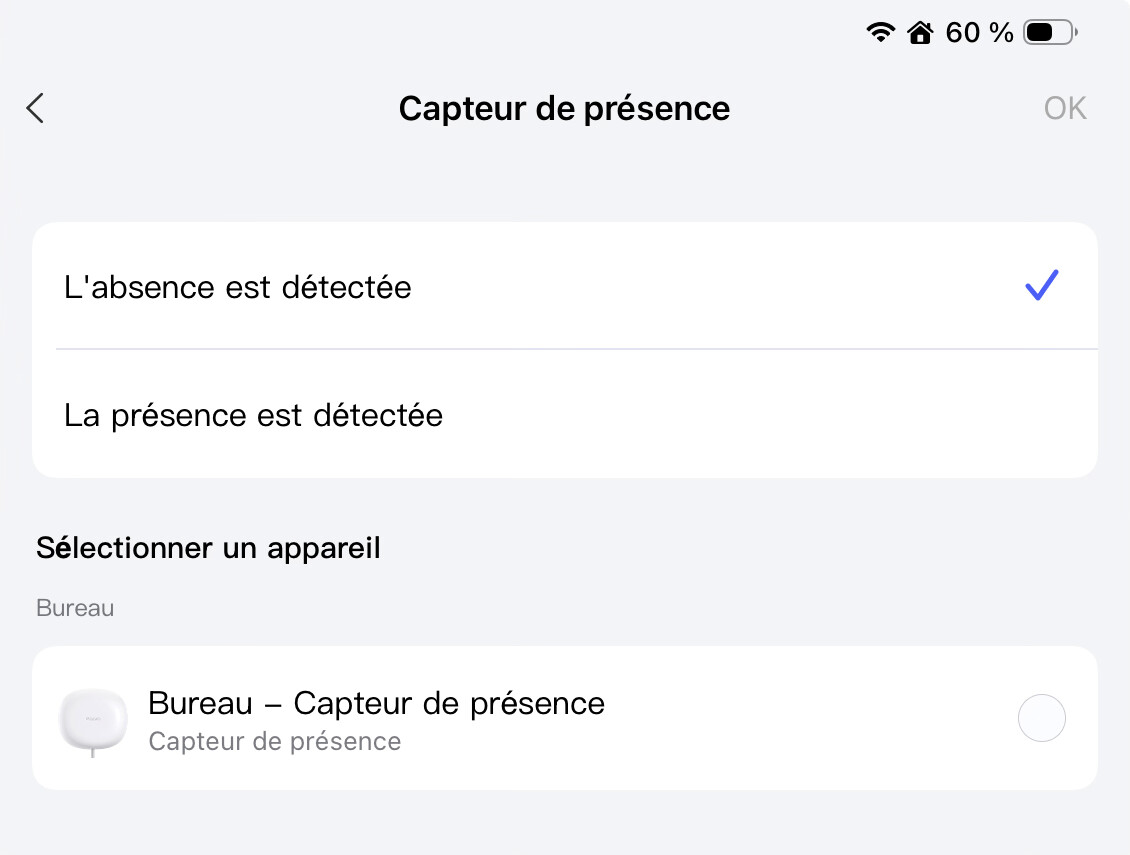

This one is fine :

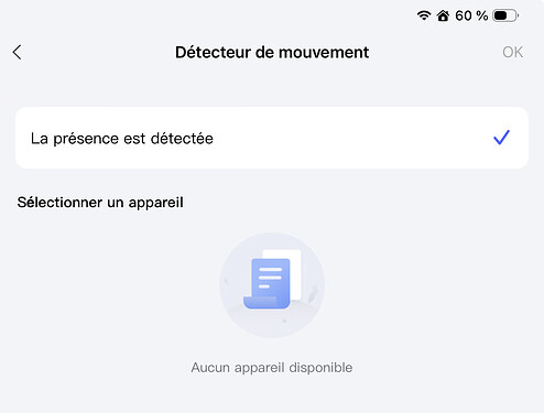

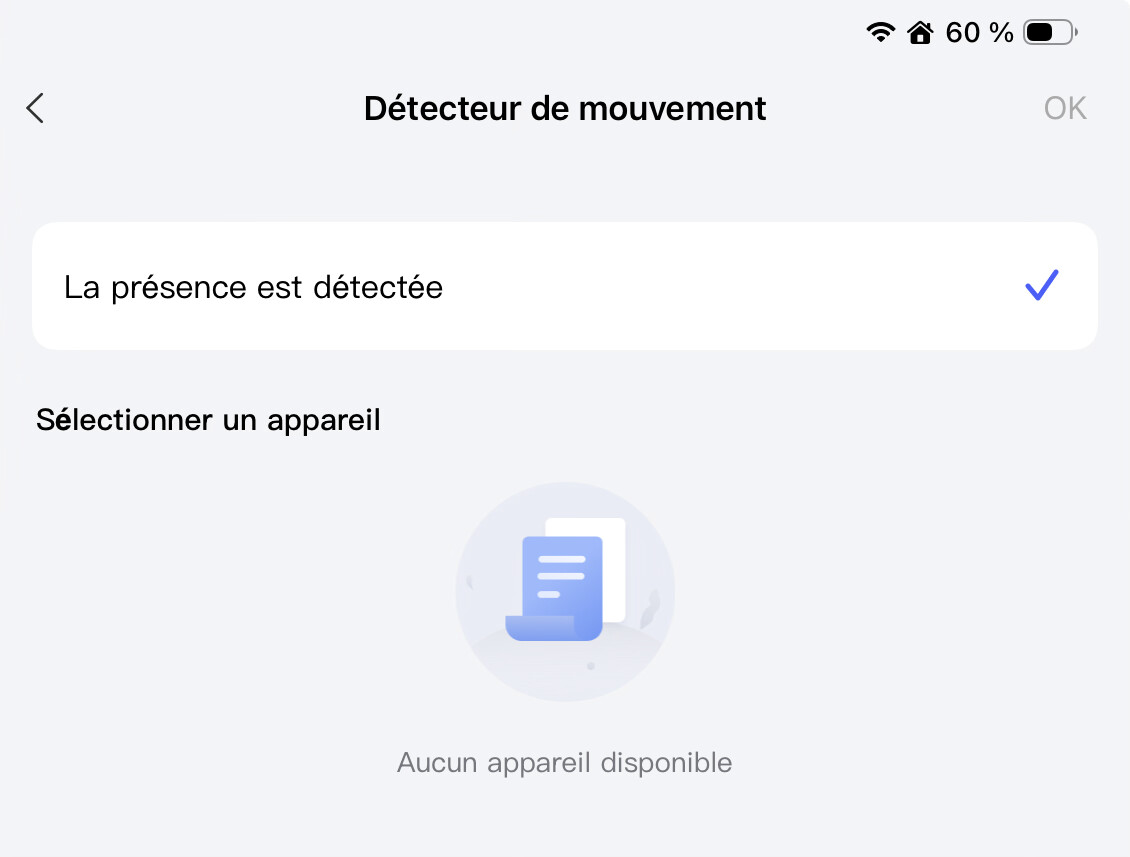

This one doesn’t work, I have one of them.
The last one is fine :

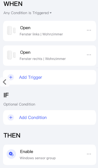

Create an automation that represents the sensor group. This could be an automation that never triggers. For example, something like this:
Define the status of the automation in your mind:
  • Automation activated: at least one window is open.
  • Automation deactivated = all windows closed.
Do not forget to set the initial status of the automation depending on the current status of the sensors. Set the automation to deactivated if all windows are closed.

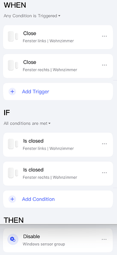

Then you need another automation to activate the first one when a window is opened.

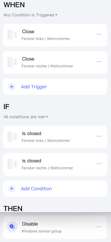

You also need an automation that deactivates the automation when all windows have been closed.

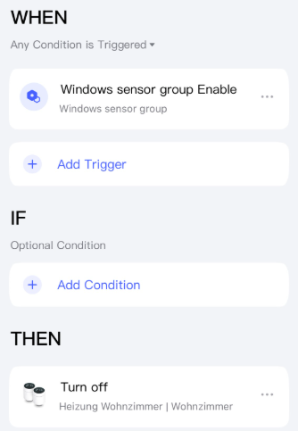

Then you can use the status of the first automation in other automations. For example, like this:
This principle can also be applied to other sensors, such as multiple presence sensors, which can activate or deactivate an automation, e.g. ‘someone is at home’.
