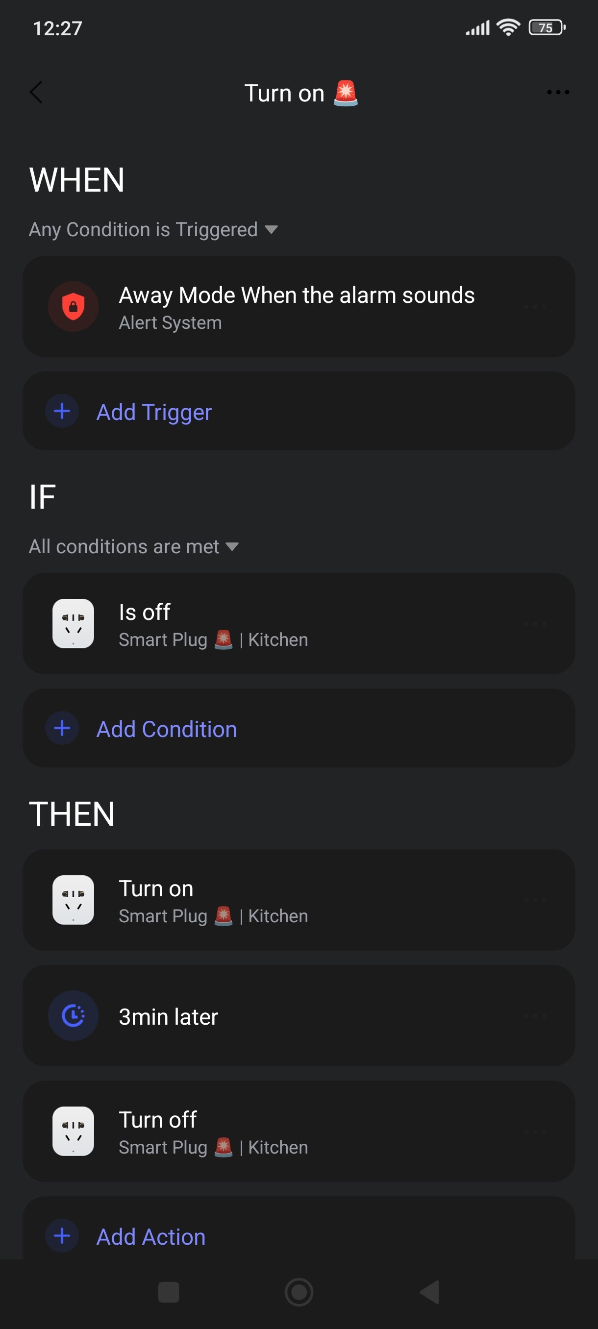

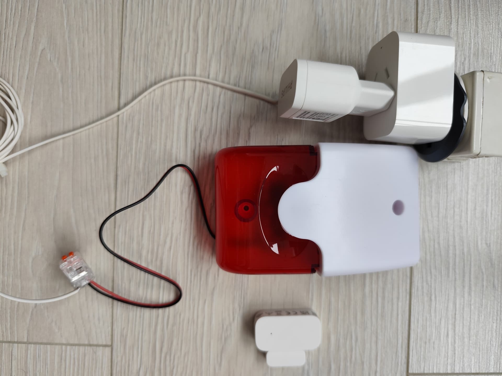

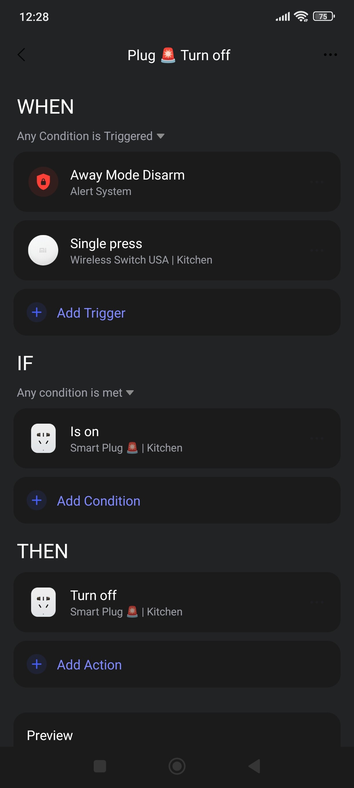

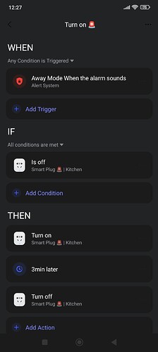

I added a siren to the “away” arming mode. The strobe siren
is connected to an Aqara socket, which turns on when the “away” mode is not disarmed. Its advantage is that it is powerful, it can be installed indoors/outdoors. Below you can also find screenshots of the automations.
