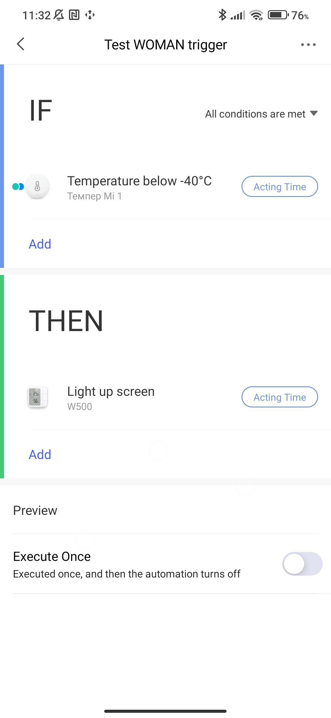

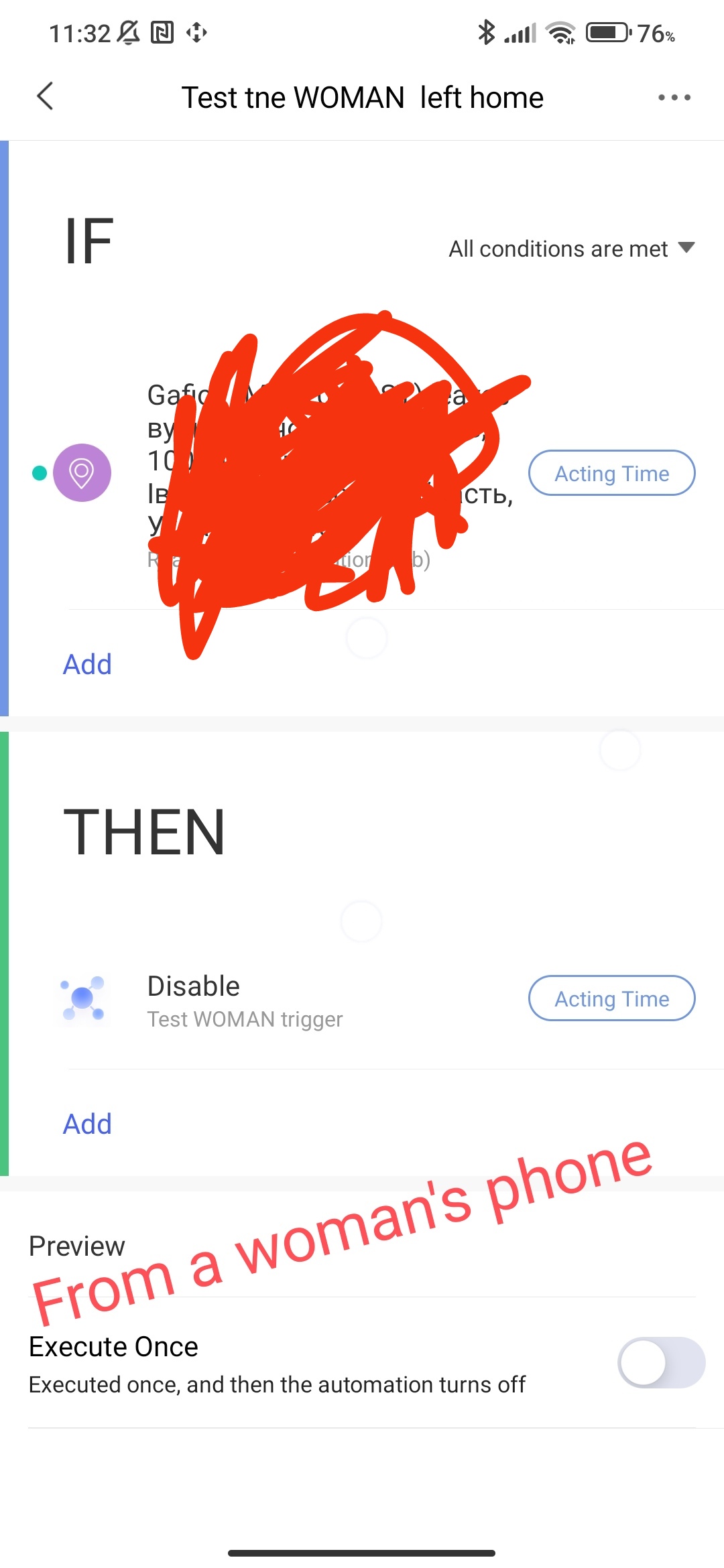

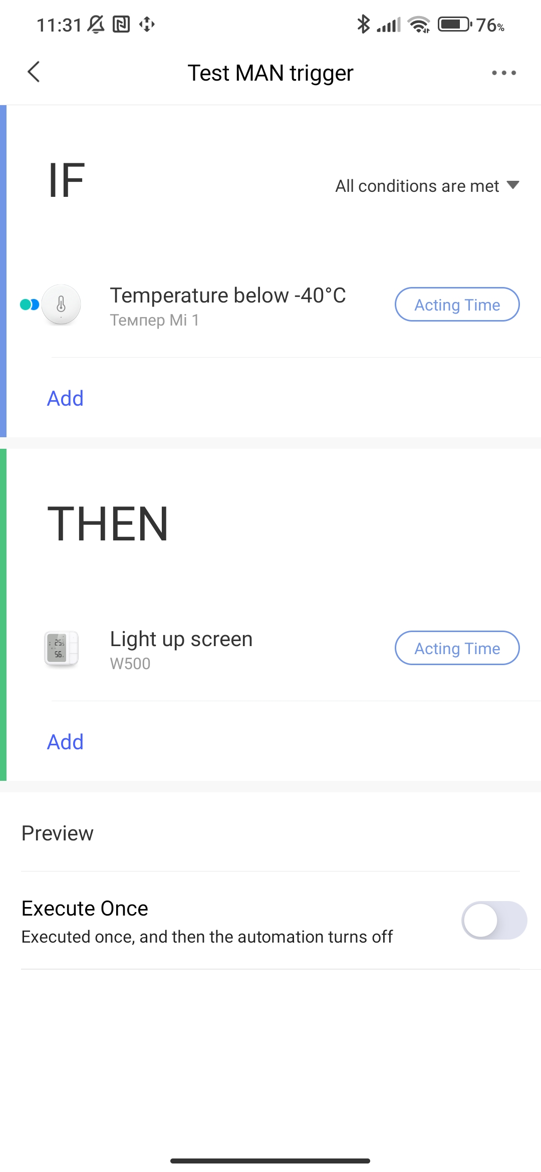

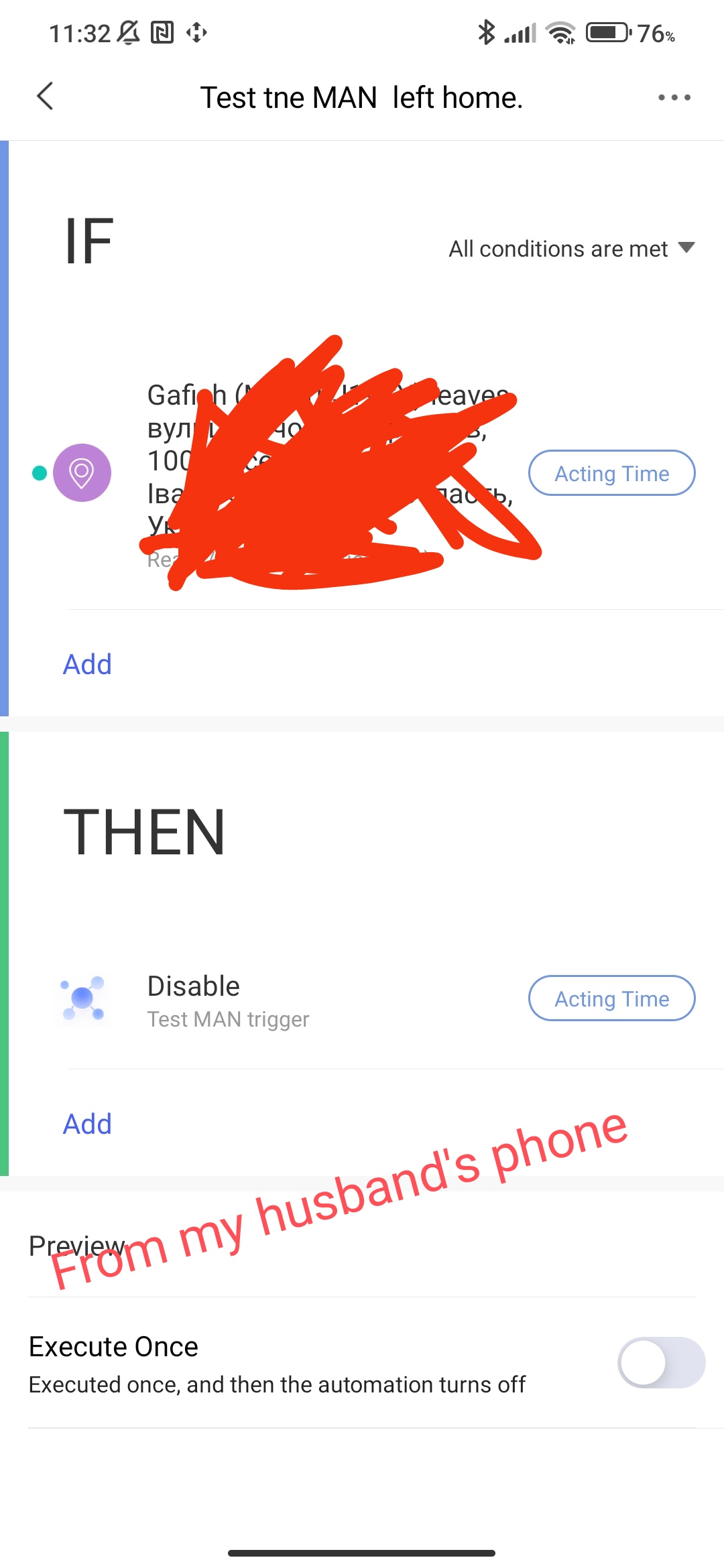

Theoretically, such automation should work, I tested it at your request. See the names of the automations for understanding.
1.I made trigger automations (which never work). They can be made for the whole family respectively from each phone.
2.For each family member I launch Off trigger automations in case they leave the house.

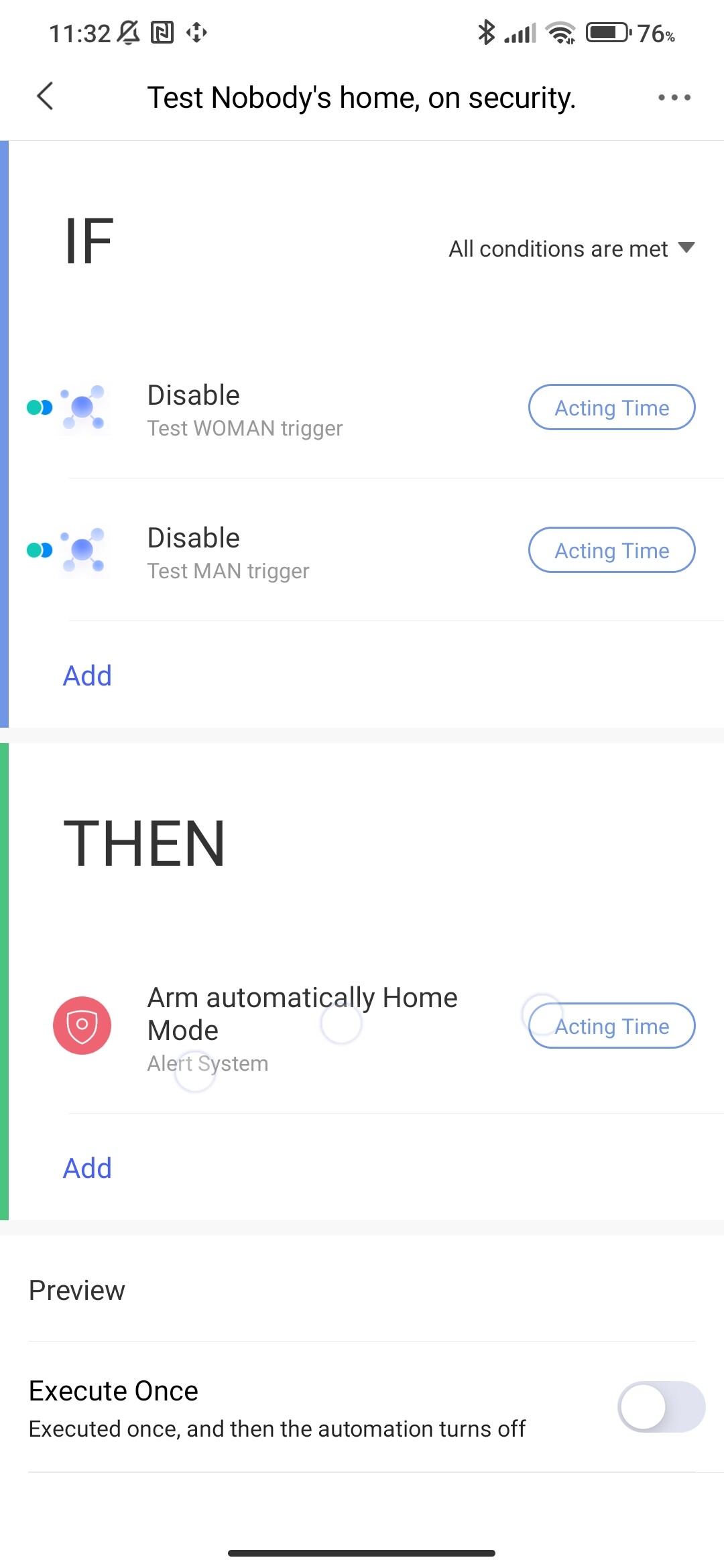

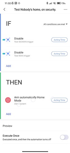

  1. Automation that triggers security when there is no one at home.
You can do the automations for disarming when someone comes home yourself, just don’t forget to add an additional “On trigger” automation for the family member who has returned home.
