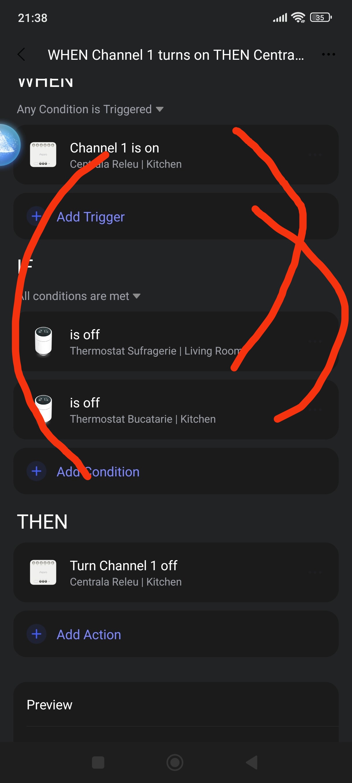

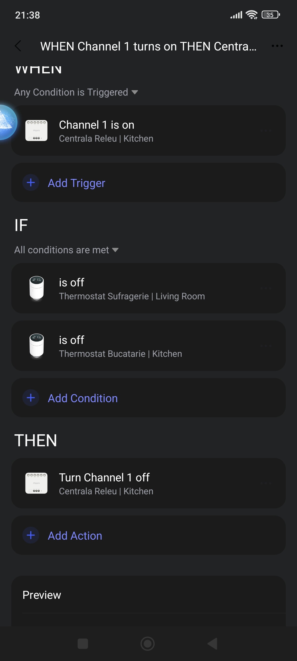

I have three Aqara thermostats and three W100 sensors, T2 relay. I set it so that when the temperature drops below 21 degrees, the heating system turns on. These settings work, the problem is when I want the heating system to turn off. Can you tell me what is wrong with the automation in the picture?
@avram_bv I’m sorry, but the reference information doesn’t have knowledge directly related to what’s wrong with the specific automation in the picture you provided.
However, let’s collaborate in the community to figure this out! Maybe other members have encountered similar issues and can share their insights.
If you have any suggestions or areas where you think things could be improved, you can submit manual customer service feedback. This way, we can work together to drive improvements and make the Aqara experience even better for everyone.
Thank you very much for the advice. I will try :).
I needed the condition “all conditions are met” When a thermostat in one room turns off and the specified temperature in the other room has not been reached, the relay does not close.
