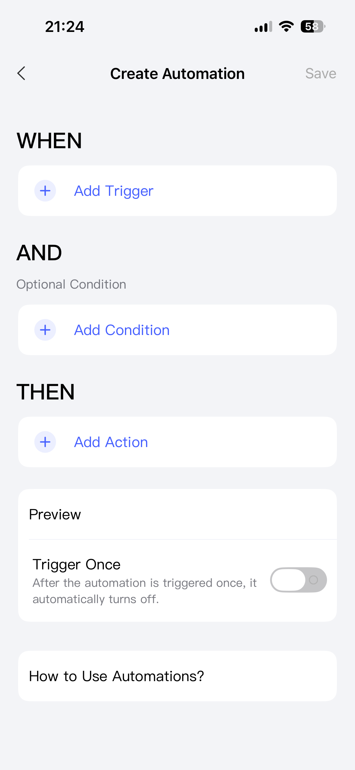

-go to automations then press the + icon and chose “When” add trigger and chose your temperature sensor
After that you will see some options to chose from and chose what you need from there

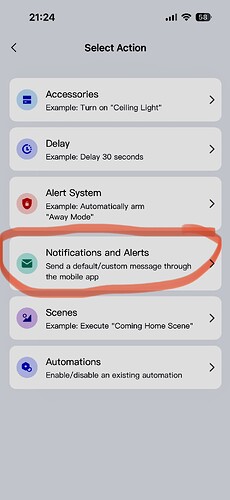

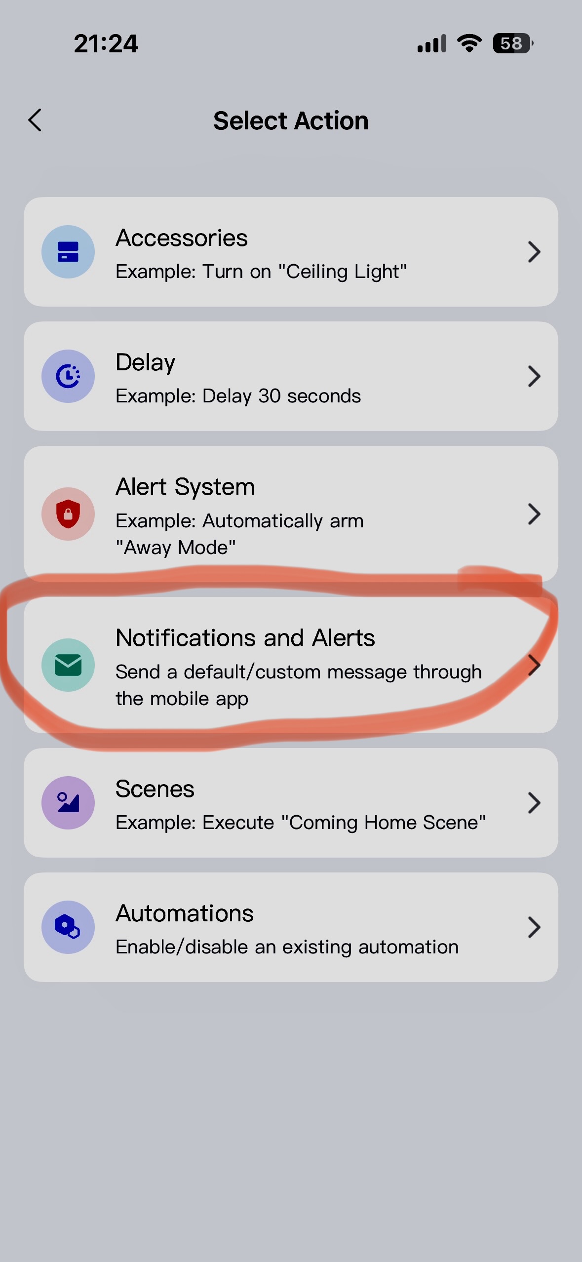

Next seep is “Then” add trigger and here you chose Notifications and alerts

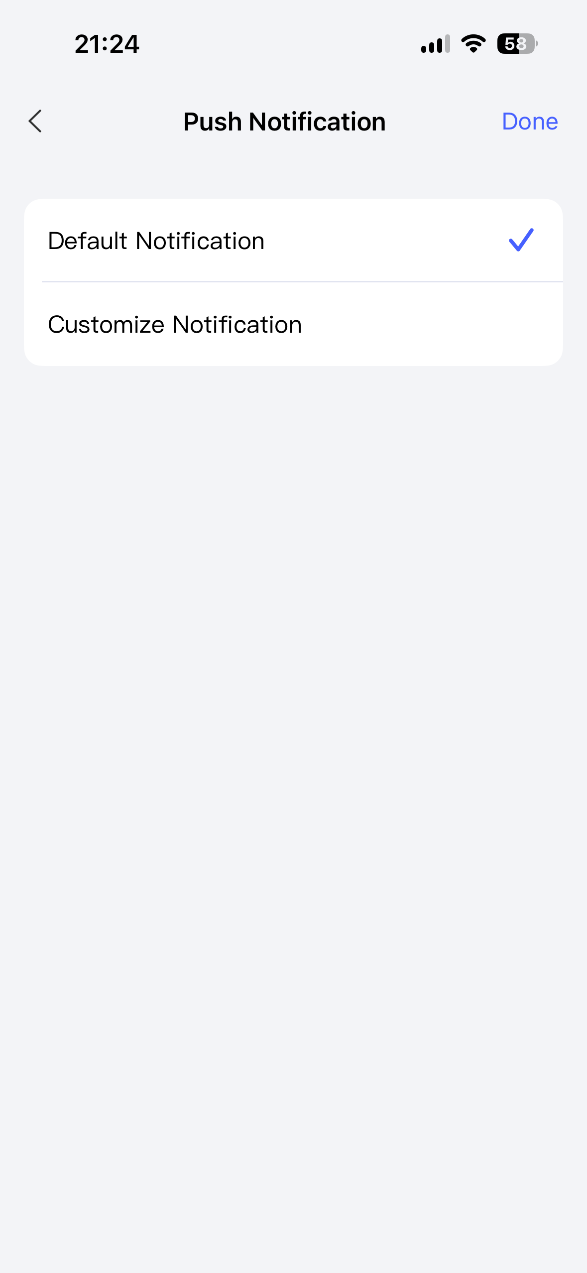

After that chose “push notifications” there you have 2 option default or custom on default aqara will send you an basic notification and on custom you can write what exactly that notification will show when you get it
This is a simple but effective automation from aqara home app.

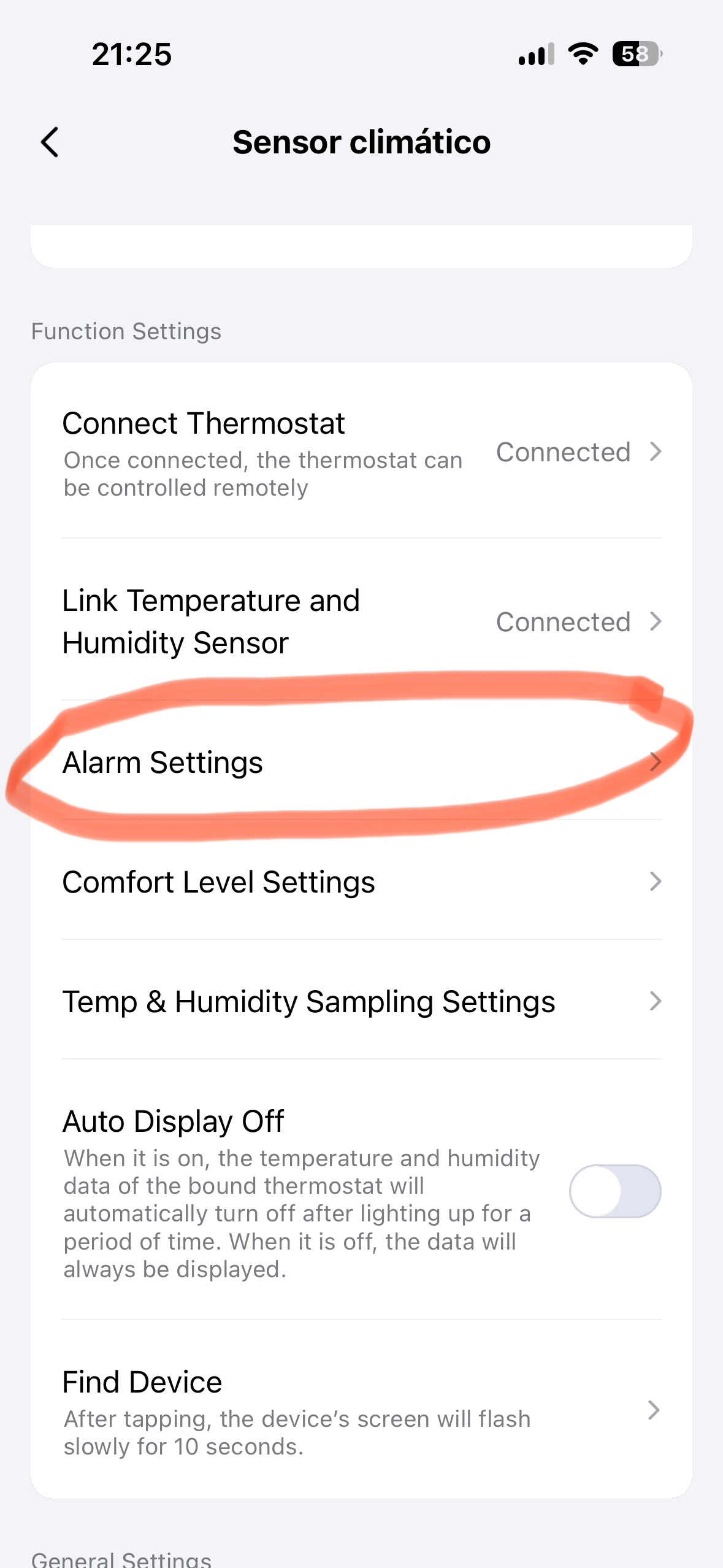

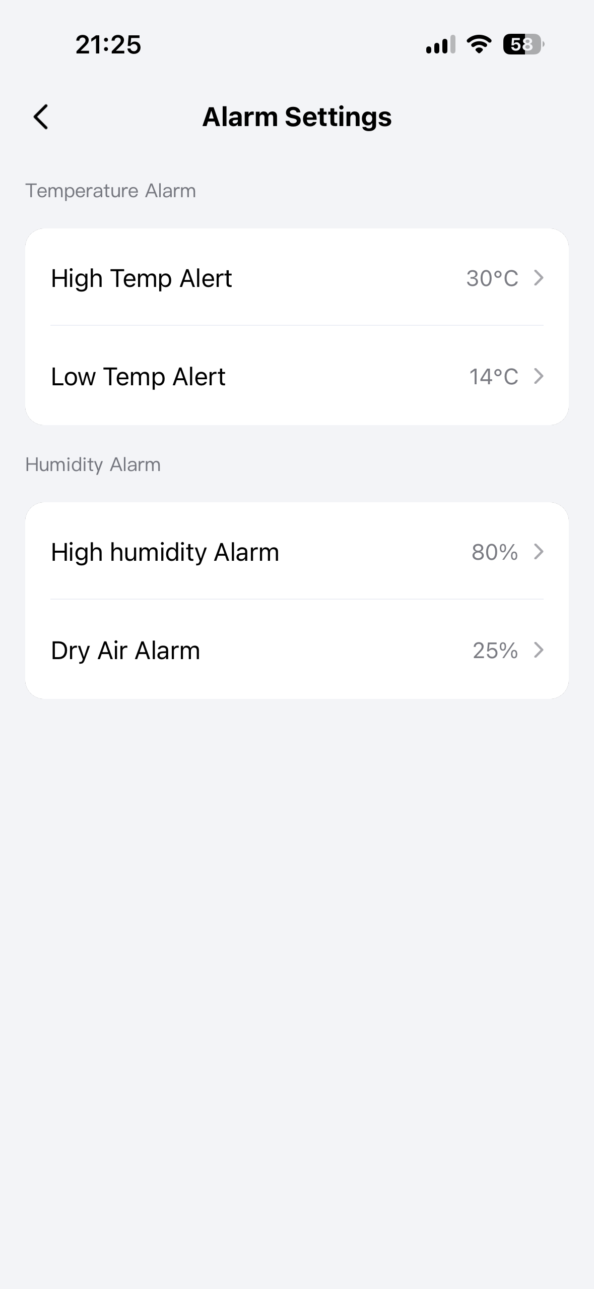

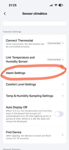

Now if you have the w100 then you can open aqara home app go to w100 page and there press the 3 dots on top and you will see “alarm settings” were you can set high low temp also humidity and the Aqara app will directly send you an alarm notification when those values are reached.
Hope this helps you and remember this can’t be made from HomeKit only aqara home app.
