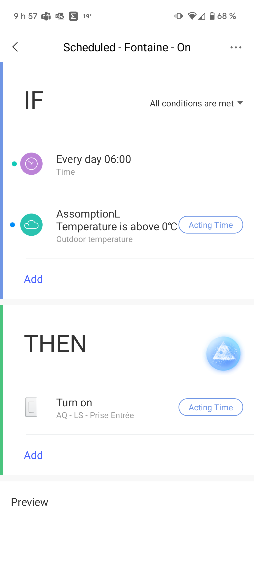

I create two automations that will ack at a certain time if the temperature is above 0 degrees. They are not running. Any Idea?

The automation configuration is fine, you need to see if the temperature conditions are met at the corresponding point in time. If the weather data is not accurate enough for normal operation, you can adjust the temperature parameters according to the situation.
Thanks but I already check. We are in the summer here and the temperature is higher than 0.
Hello, there is an error in the conditions. Automation with two conditions (°) will never work. Theoretically, it is necessary that both conditions occur AT THE SAME TIME in time, and this is impossible. I call the condition (°) an instantaneous condition, so take this into account in future automations and use it in conjunction with the condition (°°). There is also information for you, all conditions related to the external environment outside are CLOUD, and depend on the Internet.
I know that this is cloud base. I just install an Aqara Temperature sensor outdoor and I’m running test to see if it’s acurate. But I reach the support and that should work. There are investigating on this.
