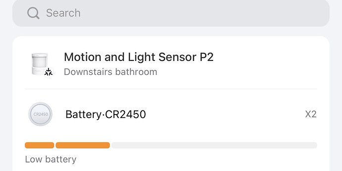

Hello, I have exactly the same problem. I have read the advice. One of my Door P2 sensors is quickly draining the battery. Could the fact that I have associated it (in test mode) with the “Basic Guard Alarm” functions be the cause? Or is it a malfunction of the sensor.
It is surprising that the sensor battery is that low already granted the hub is one floor up and outside camera and doorbell
