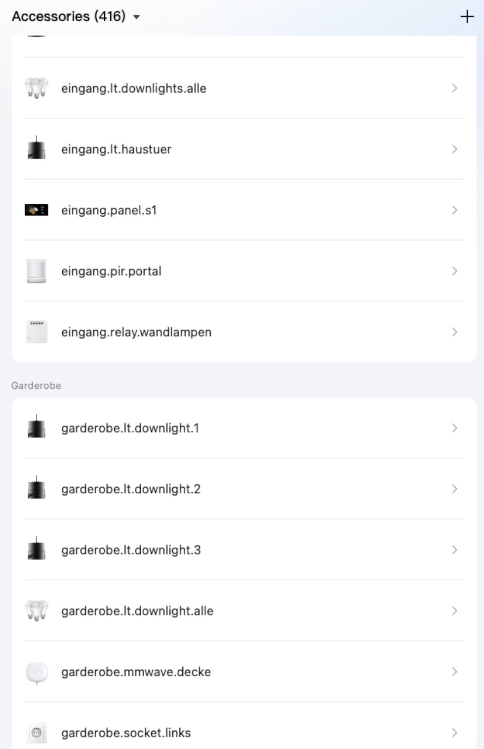

I’m a Smart Home enthusiast and have been working with this topic for over 20 years. Right now, I’m building my third Smart Home – and with over 400 Aqara devices plus dozens of other devices from different brands, it’s a pretty ambitious project. With this post, I’d like to share some of my experience. I hope it’s helpful.
One thing I learned the hard way: without a good naming convention, large setups quickly turn into chaos. Finding the right device in an app, writing an automation, or troubleshooting a scene becomes a nightmare if names are inconsistent, unclear, or duplicated.
Here’s the system I use today – it works just as well for small setups as for monster installs.
It’s based on three principles:
  1. Unique – No two devices share the same name.
  2. Self-explanatory – You can tell what it is, where it is, and what type it is at a glance.
  3. Scalable – Works for the small setups and the monster installs.
1. The Basic Formula
[Room].[Device type].[Number or detail]
Examples:
living.lt.ceiling1 → Living room, light, ceiling fixture #1
kitchen.sns.mmwave1 → Kitchen, sensor, mmWave #1
office.sw.scene2 → Office, switch, scene button #2
bedroom1.blind.main → Bedroom 1, main blind
garage.lock.entry → Garage, entry door lock

I use these names in the Aqara app, but only as the “technical” names. For the dashboards and device cards I switch to something a bit more family-friendly – keeps the system organised, but still easy for everyone else at home to use.
