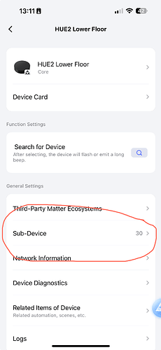

I have integrated several Hubs/bridges into Aqara…Hue/Ikea etc via matter but what I am seeing is that the device limit is 30 per bridge …/so 30 hue bulbs…30 ikea plugs. Is this a known limitation that I missed?

No I think you are misunderstanding. The limit seems to be at a BRIDGE/HUB level….so HUE hub or IKEA hub. It declares 30 sub devices on each hub no more.

Yes I have tested my IKea hub in both HK and HA. In both cases 34 devices are correctly reporting to HK and HA but not Aqara.

I think that this is a limitation IN THIS SUBMENUE, because i have OVER 30 IKEA Devices importet and in this Submenue there are only shown 30, mainly bulbs. But my Sensors,purifier and remotes are also positive importet BUT NOT COUNTED in this Menue.
