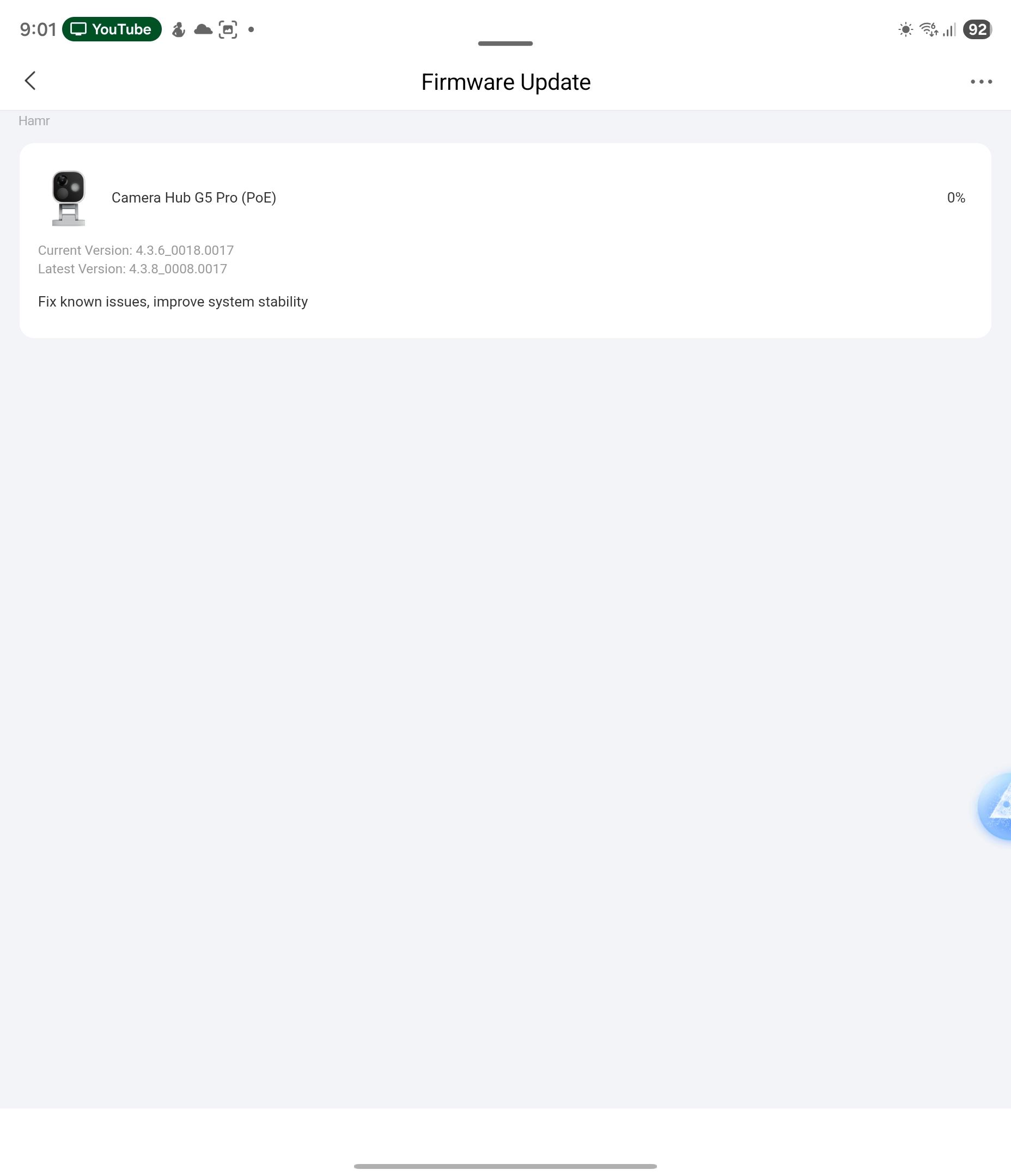

I have a G5 Pro POE camera and I can’t update the camera. I tried turning it off and restarting it, but nothing helped. Update ends at 0%.

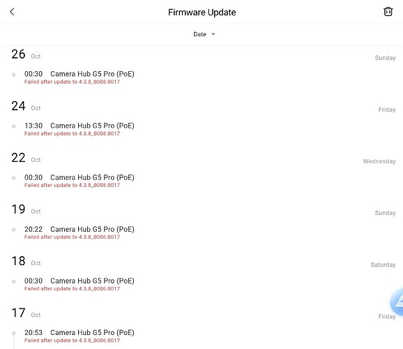

Yes I have tried it from several different devices android iphone. I have tried restarting both the router and the device itself. Previous updates worked fine.

I’ve tried: restart, factory reset, removing from app, does anyone have any other ideas?
