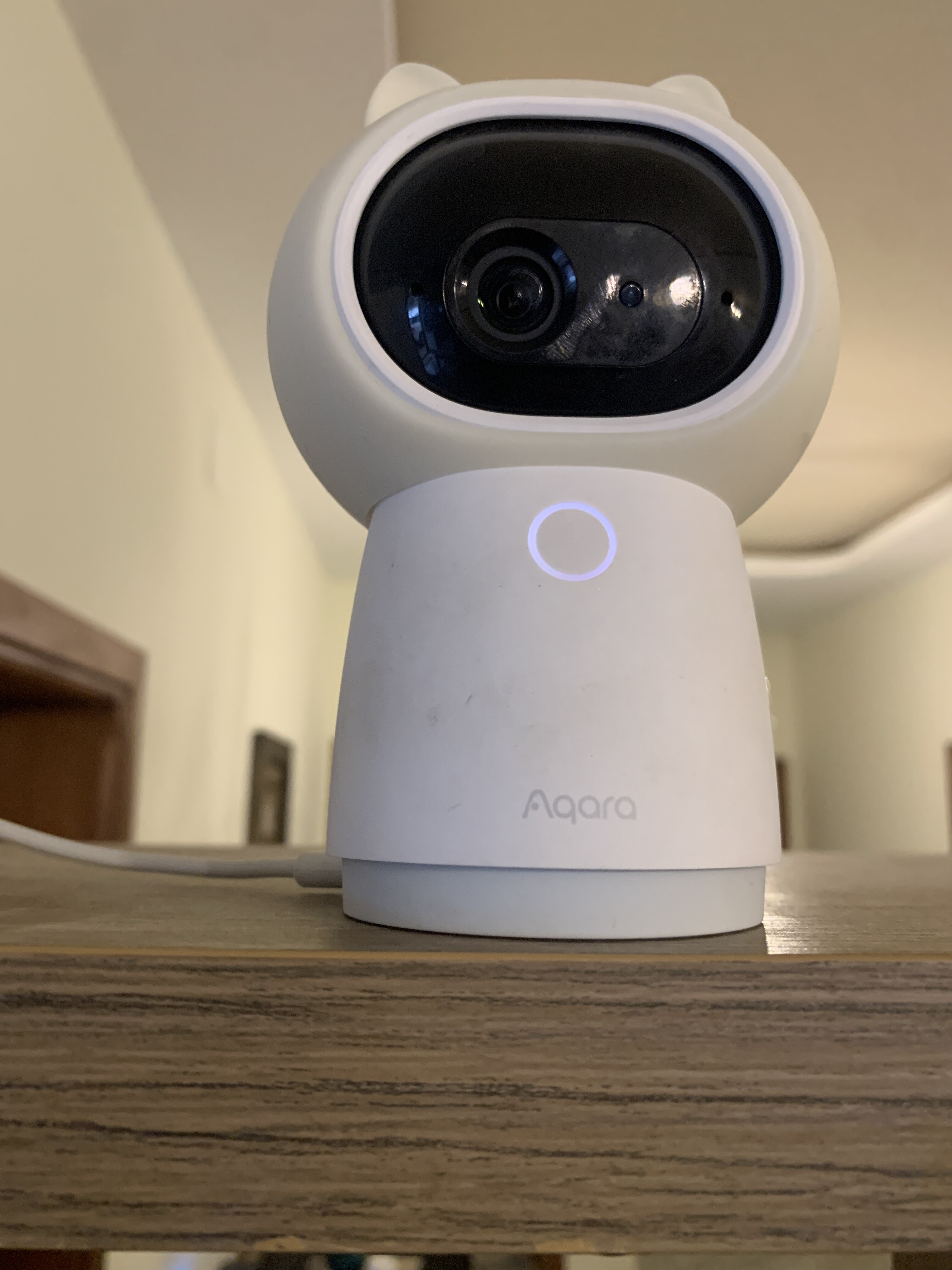

Hi All, I need your assistance, please. For some reason my Camera Hub G3 doesn’t work, I’ve check the power supply and it seems like it’s ok but no lights on the camera!

I’ve just tried another power supply and it turns on. But it’s not working, just a white light
Try holding the button (the one with the white ring) for 10 seconds and try to add it in the app again
I’ve tried holding the button (the one with the white ring) for 10 seconds and followed your recommendations, but unfortunately it still didn’t work.
