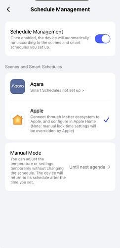

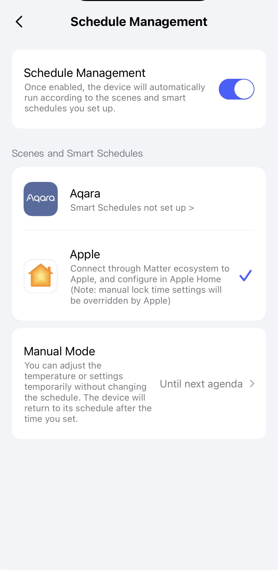

W200 has been amazing for me! But I’ve hit a snag. I disabled Adaptive Temperature for a day but now it won’t let me re-enable it (see video). Any suggestions?
Thanks much!
Thanks much!
Can you share what firmware and ios versions you are running?

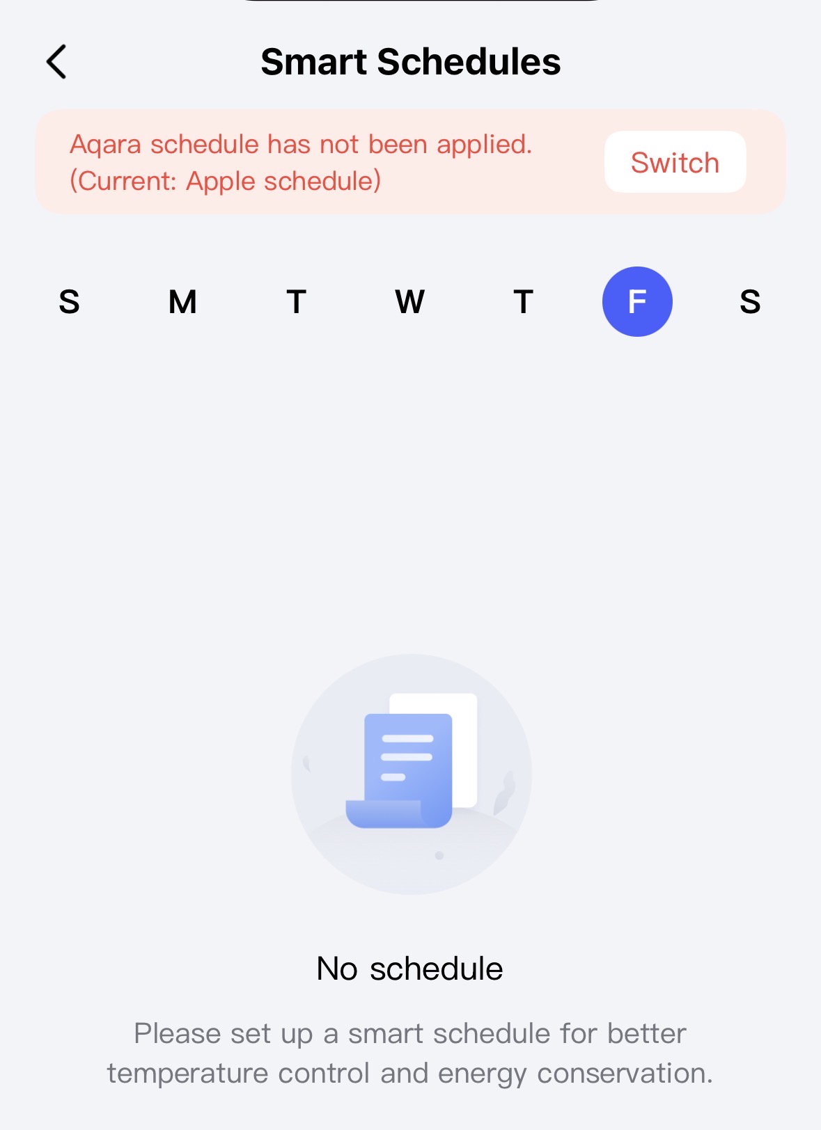

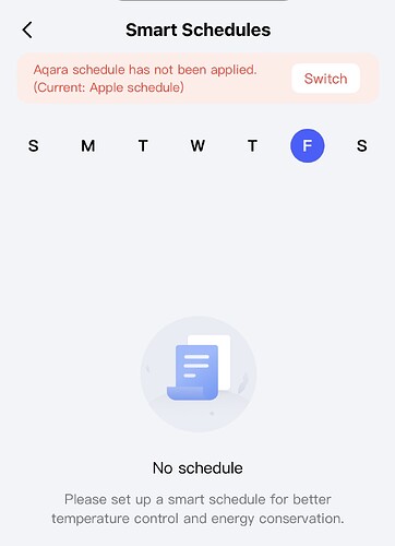

Do you use the Aqara app at all? The aqara smart schedules and Adaptive Temperature are not compatible.
Hey! Thanks for taking the time:
iOS: 26.5
Firmware: 4.5.48
And, to my knowledge, everything is set to HomeKit scheduling control instead of Aqara.
I had this happen to me once. iPhone did this, but iPad was fine.
It was pretty clear to me this was a problem on the Apple side. I rebooted the phone and it started working again.
Good idea. I hadn’t thought of it being the phone. Unfortunately, restarting did not fix the problem. It’s still the same. Thanks for the suggestion!
