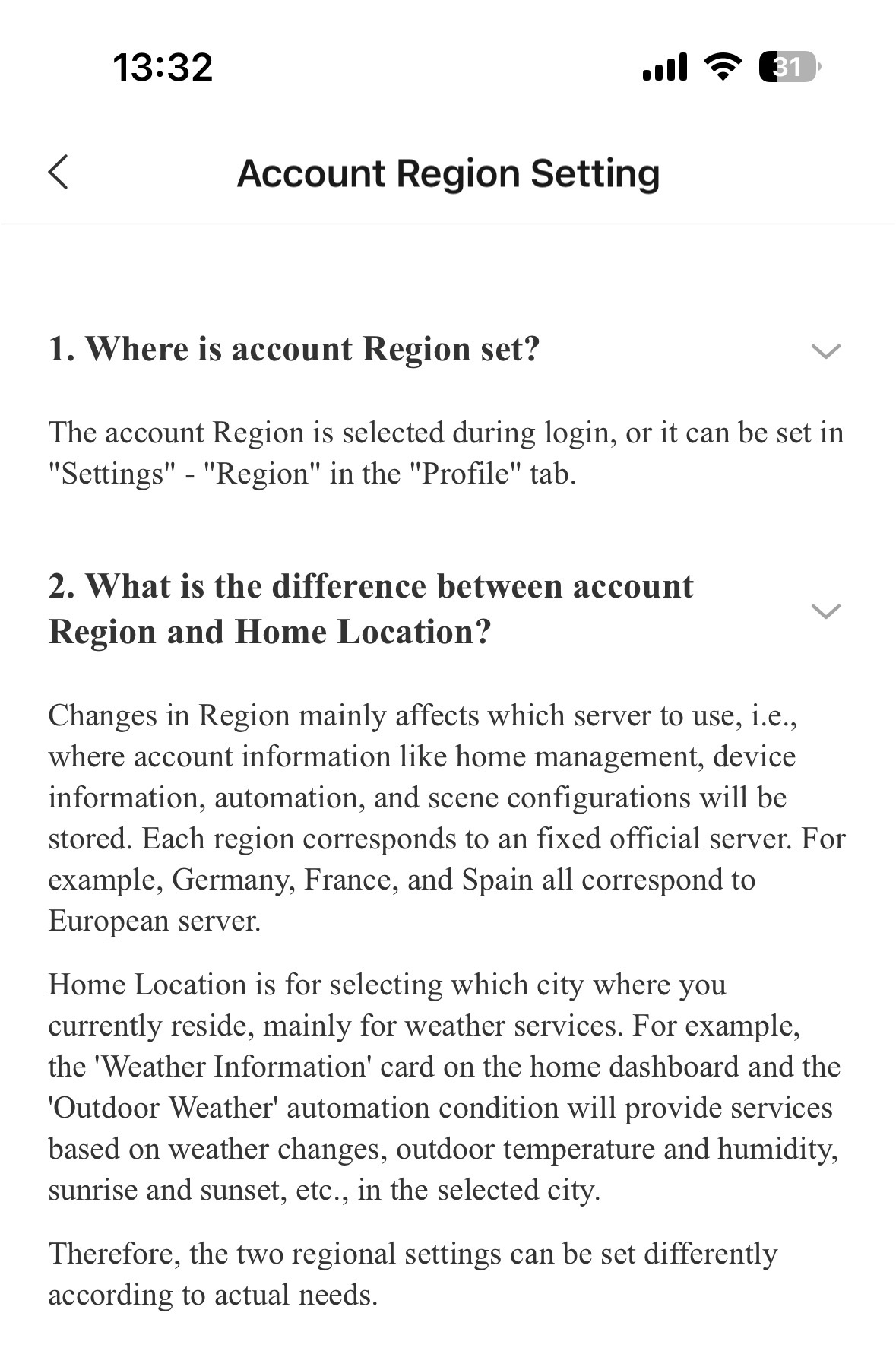

My suspicion is that my account [on the Aqara app] is currently set to Mainland China. [because it is working with my older set up on ms1 that was bought on AliExpress and was a China region only device ]. And now the M3 is an international [it speaks English]. and perhaps it can’t bind to a China region…? but I can’t change the region because I’ll loose my older setup [that is in a different house in a different country ]

Yes, exactly !
If you are on China server, the international version of M3 doesn’t work!
You need to change to another server or get a Chinese M3

Your global M3 won’t work in the Mainland China region. It’s better to use a server for your country. Change the region and your M3 will be added. You can use M1s with the Mainland China settings as a Matter Bridge for your native region.

It’s possible to change between servers- it’s just uncomfortable to logout and login for this procedure :grimacing:

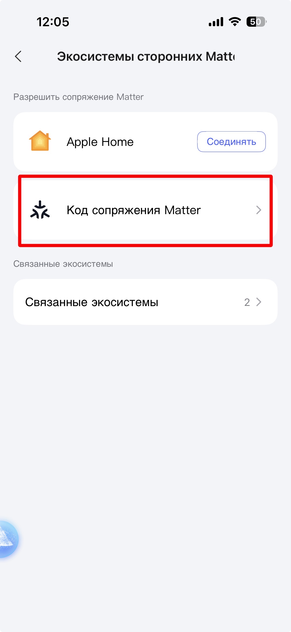

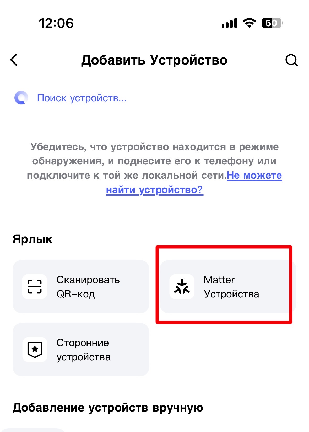

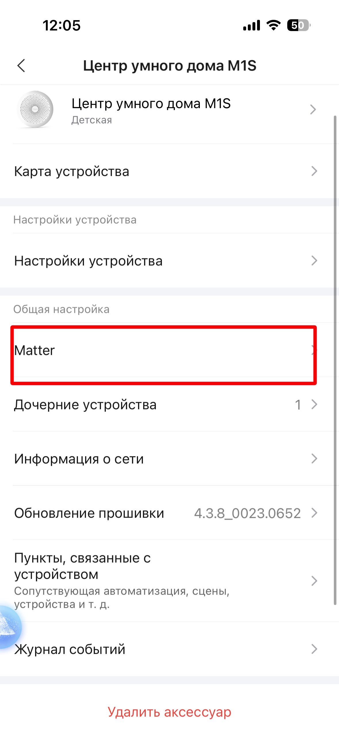

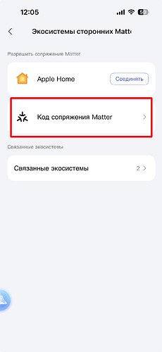

You need to take the matter code in the m1s settings in the mainland China region
then change the region and in the add matter devices tab, enter this code (you need m3).

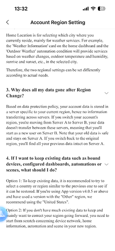

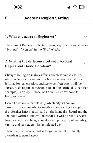

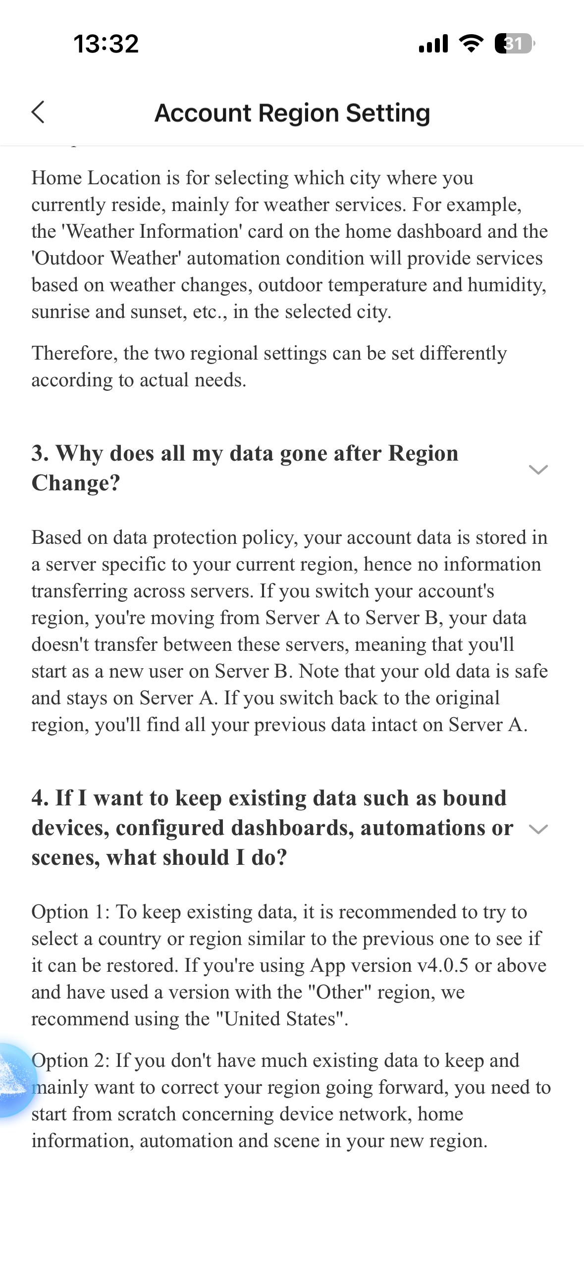

one more Q before I try this: when attempting to change the region , a warning comes up that I’ll loose all data that is on the Chinese server. But does this means the data is still kept on the server, and once I bridge the Ms1 to the M3 it will still function [with all it’s existing sensors and settings]. Or to ask in a different way, if this bridging doesn’t work, and I go back to the China server, will my old data be retained there? or is it being erased once I change server? [which is what the warning implies ]
Everything will be saved, just don’t delete anything from the Chinese region and everything will be fine.

Would you please explain: , after binding the M3. [new region] where do I add the Ms1 Matter code?
the saved code time out is soon…:). found it Thanks. Trying to connect…
