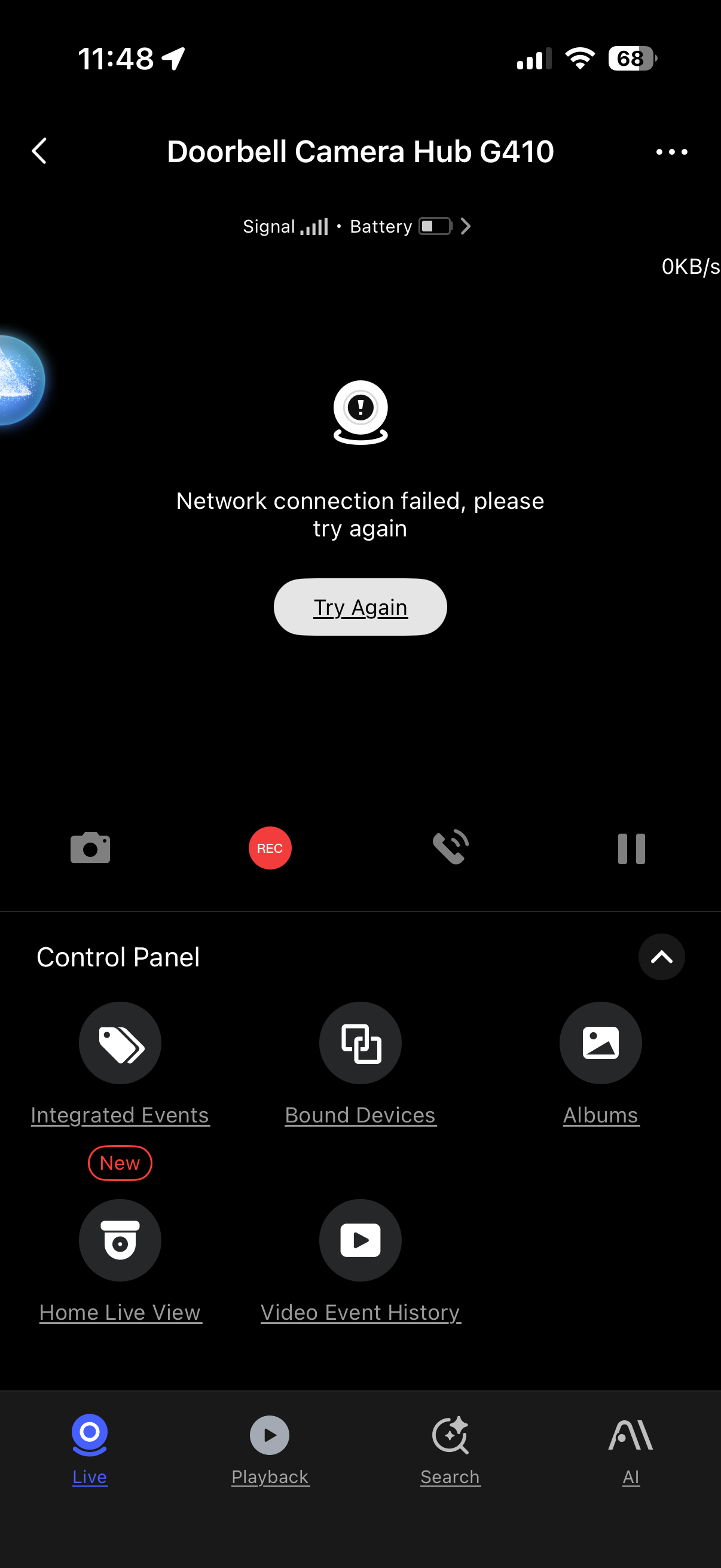

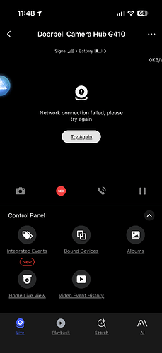

I cannot get a secure feed from my G410 doorbell. Lost in a week ago. Good signal, good battery. Was working perfectly previously.

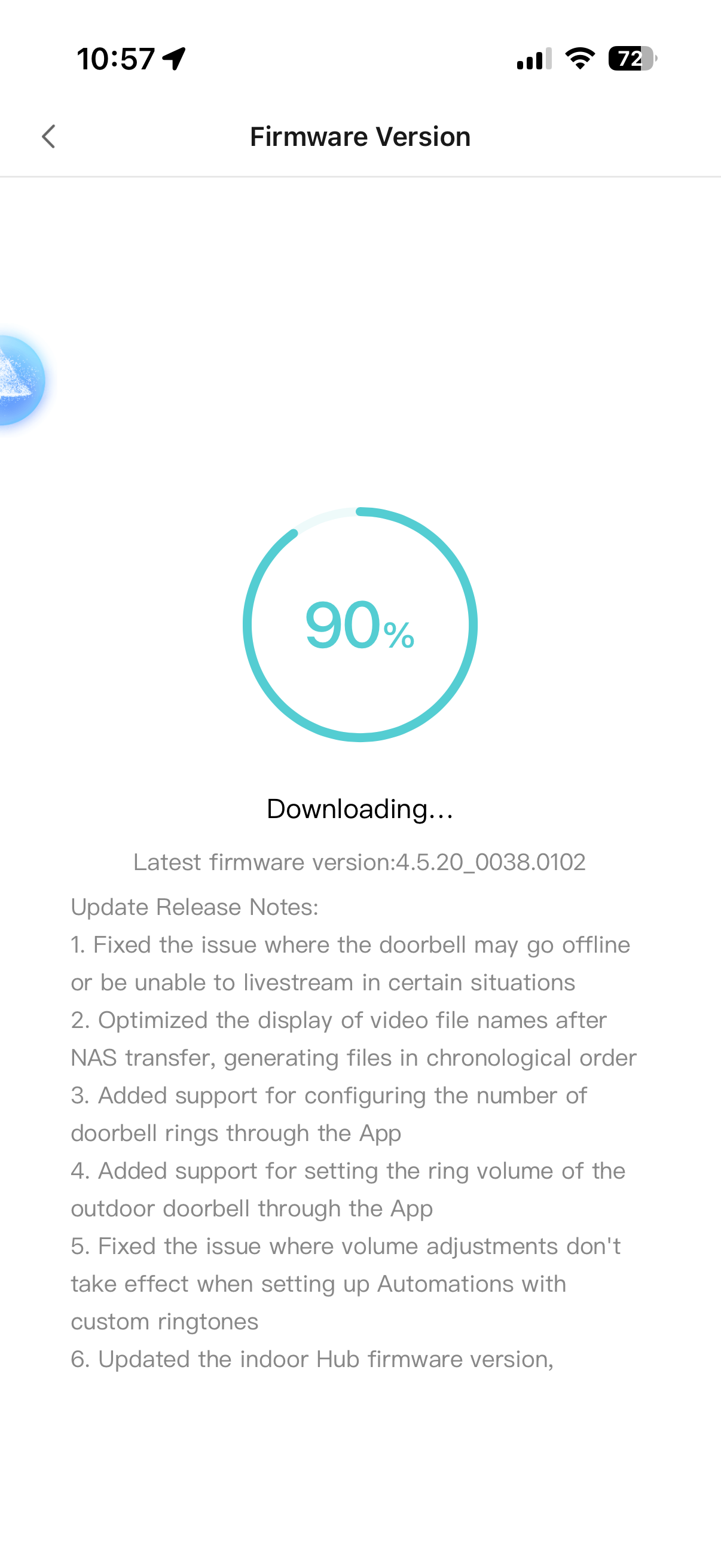

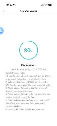

Update gets to 90% then fails. Tried multiple times
@neil14 It sounds like you’re facing two issues with your G410 doorbell: the firmware update failing at 90% and losing the secure feed. Let’s troubleshoot them step by step!
For the firmware update failure, here’s a tip worth trying: Use one phone to set up a Personal Hotspot (ensure it’s only connected to 4G Cellular), then connect another phone to this hotspot and attempt to add the Doorbell Camera Hub G410 again. After a successful connection, upgrade the firmware and then reconnect to your main Wi-Fi to see if it works.
Regarding the secure feed issue, since you mentioned good signal and battery, let’s focus on a few key checks after ensuring the firmware is updated: First, confirm the distance between the doorbell and chime is within 5 meters with no obstacles, as this can affect connectivity. Also, make sure the firmware is indeed the latest version, as outdated firmware often causes streaming problems.
