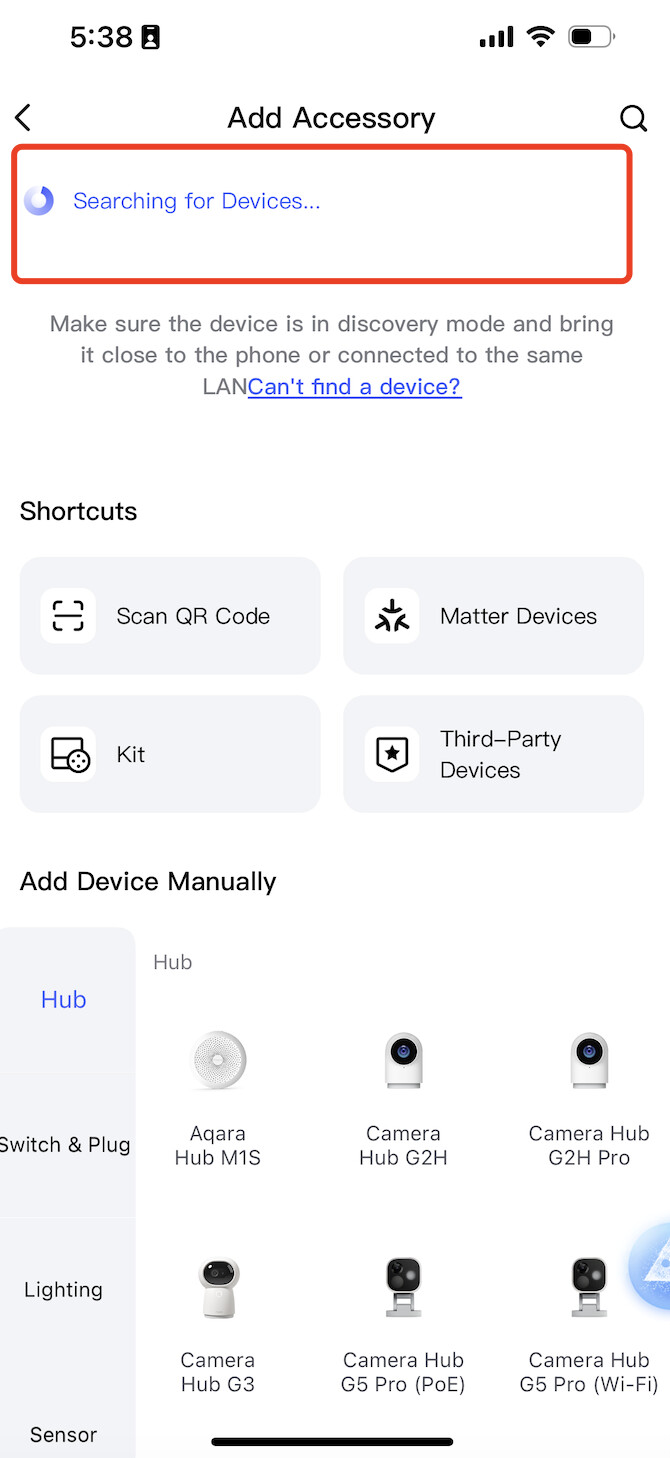

Hello Aqarlo, sorry, you might have misunderstood. The Bluetooth device pairing happens within the Aqara Home app, not in the phone’s settings page. You can refer to the steps below:
To use the device in Aqara Home (Zigbee Mode), an Aqara Zigbee Hub is required:
1.Double-press any button, then press and hold it for 5 seconds until the blue indicator light starts blinking. This indicates that the device is in networking mode.
2.In the Aqara Home app, tap Add Accessory, keep the phone close to the device, and the Light Switch H2 EU will appear in the app’s discovery section (at the top left). Tap the icon and select Zigbee under the Switch Protocol page.
3.Follow the instructions in the app to proceed.
