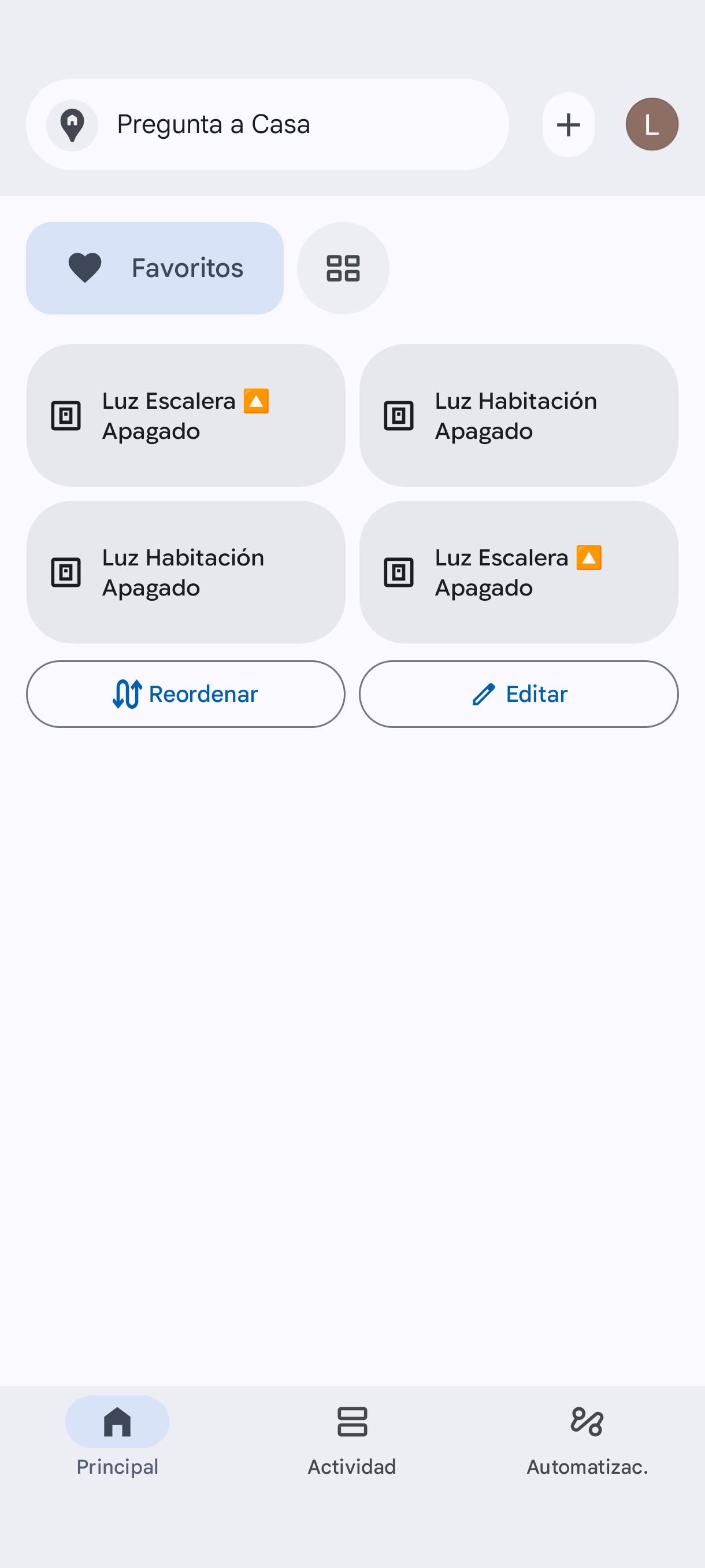

I’m in need of assistance. I have 2 aqara T2 controlling different lights.
Each T2 is connected to 2 different lights and works fine in Aqara app with different names.
But in Google home the name I see is the T2 name for both lights. I can’t remove them from favorites, I can’t delete one, I can’t reorganize them in the menú.
I need a way to tell them apart!

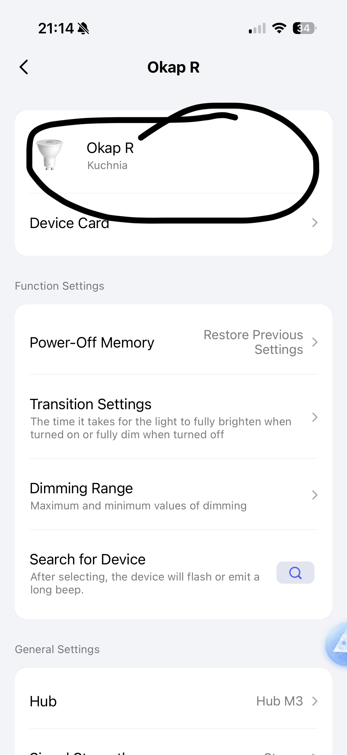

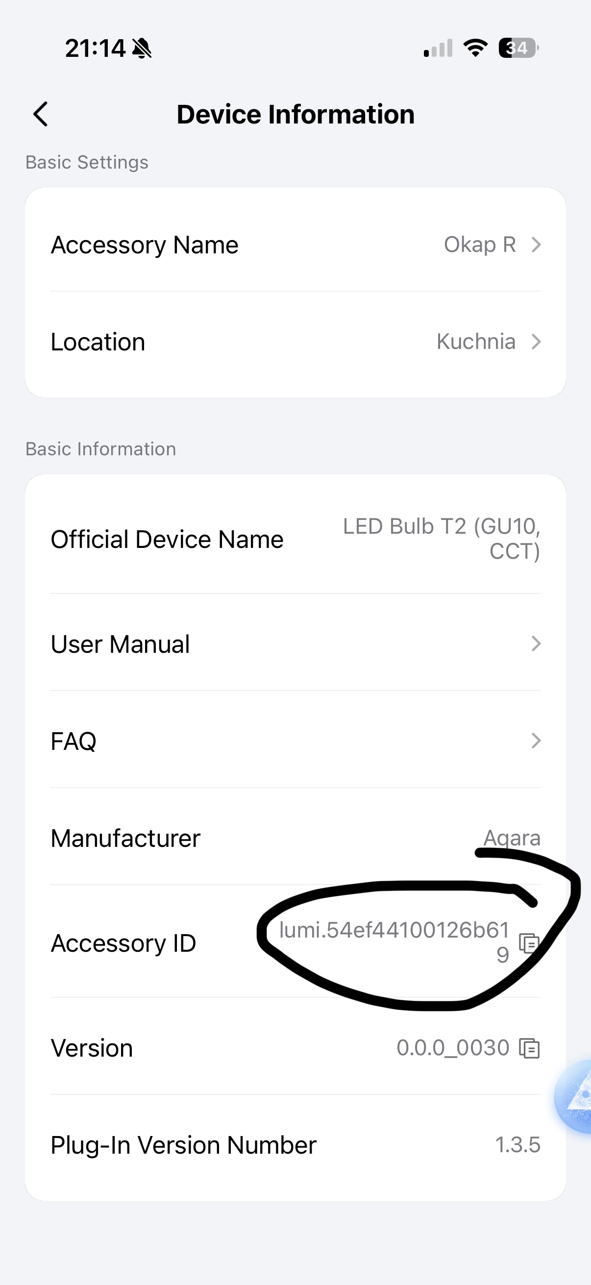

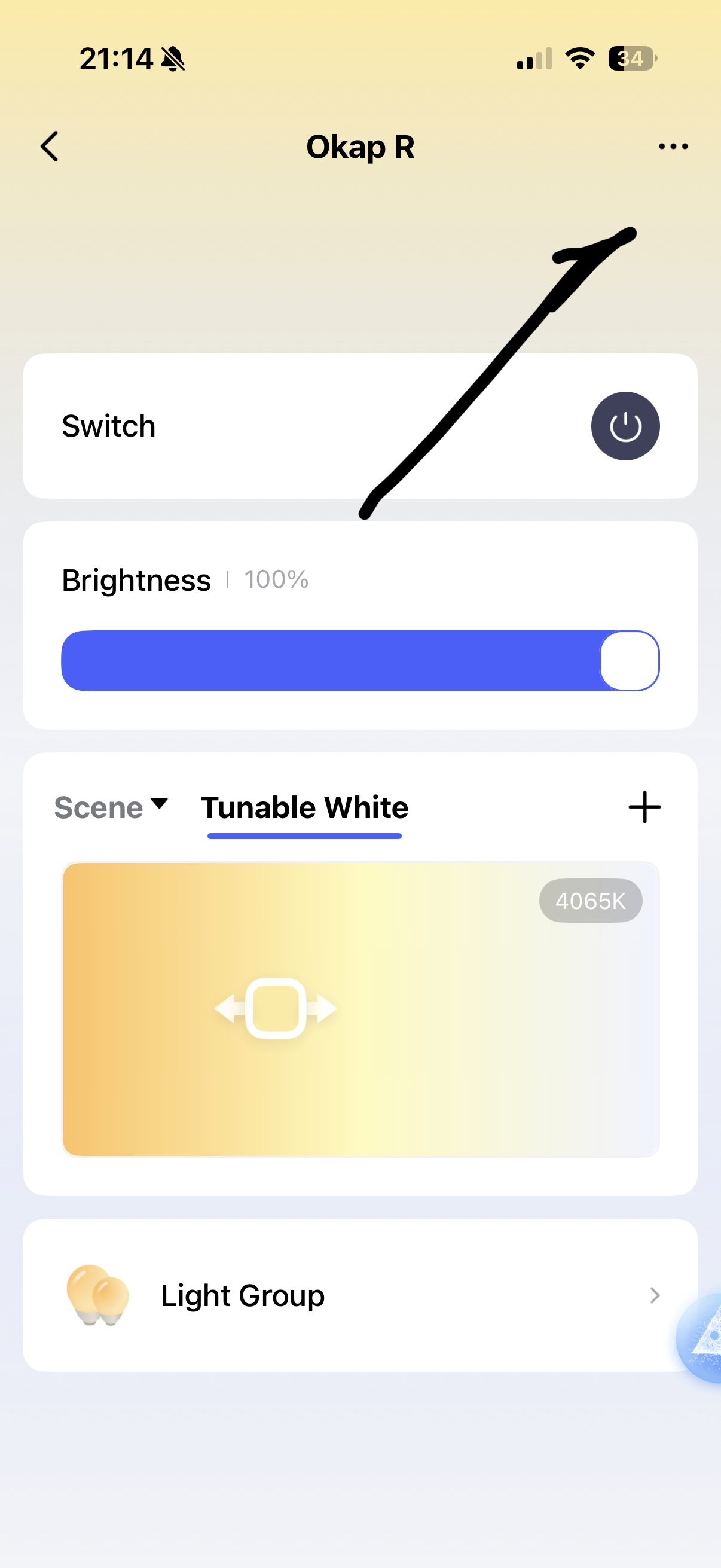

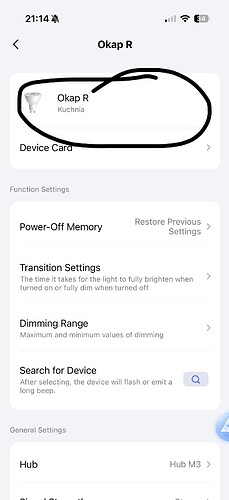

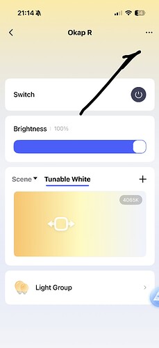

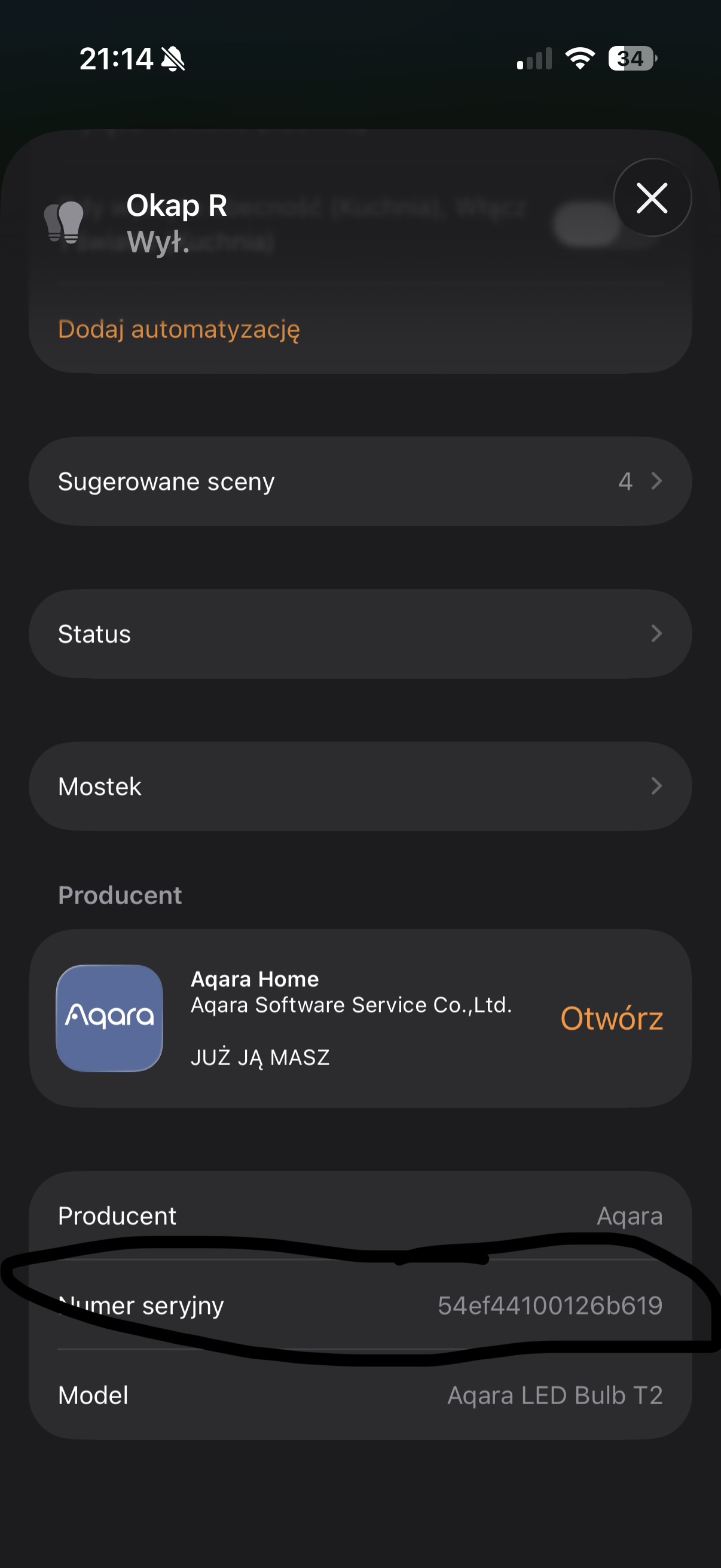

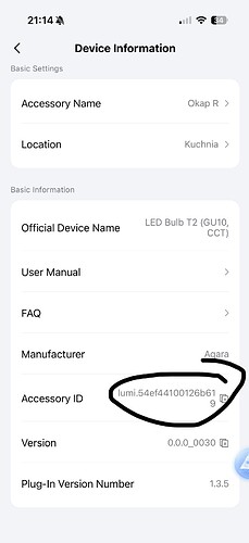

In the Aqara app, go to the device page, click three dots, then the device name (first item), scroll to “accessory id”. Remember the last three digits. Go back to Google Home and compare the device id/serial number.
How to find the accessory id:

Unfortunately, this problem is known, T2 is only visible as a relay. It cannot be seen as a light bulb. I’m talking about Google Home.
