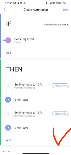

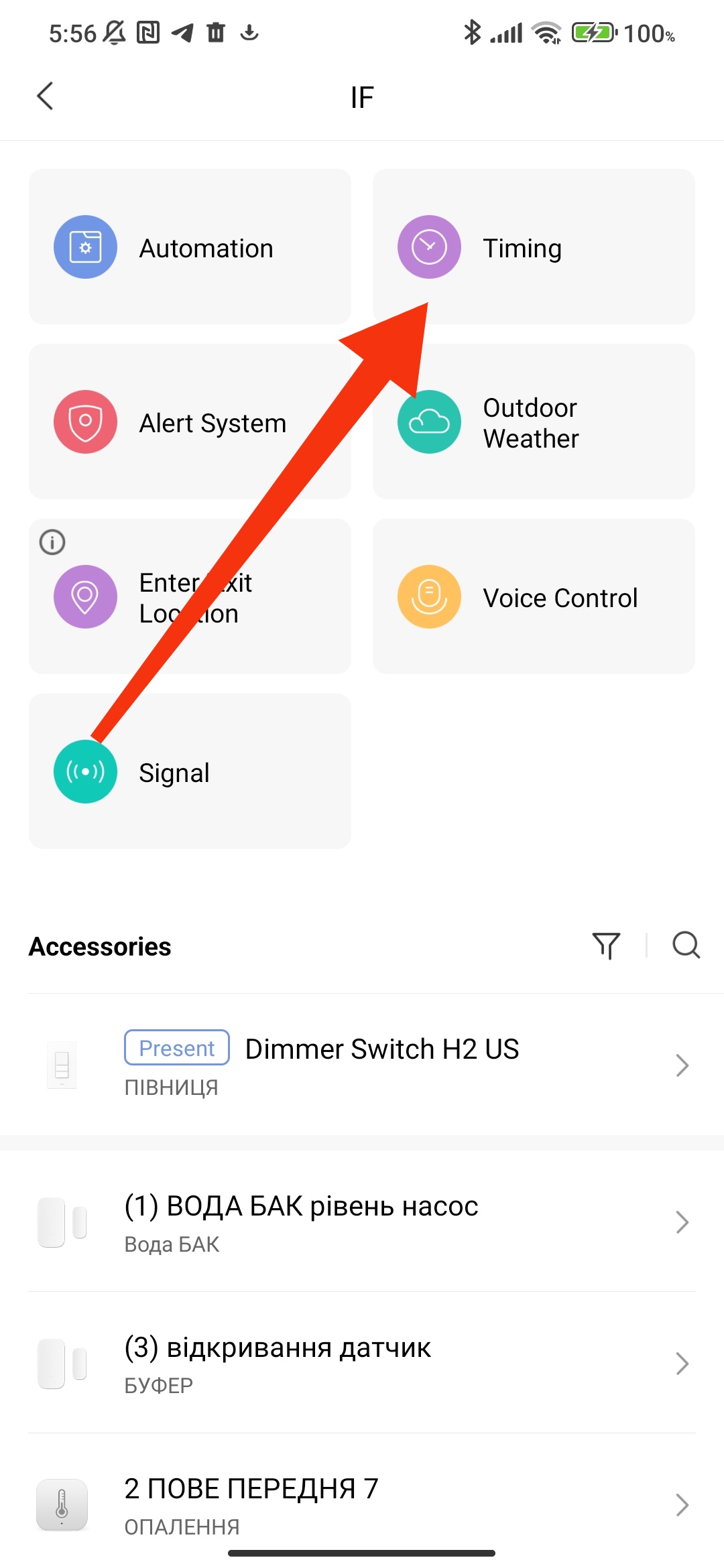

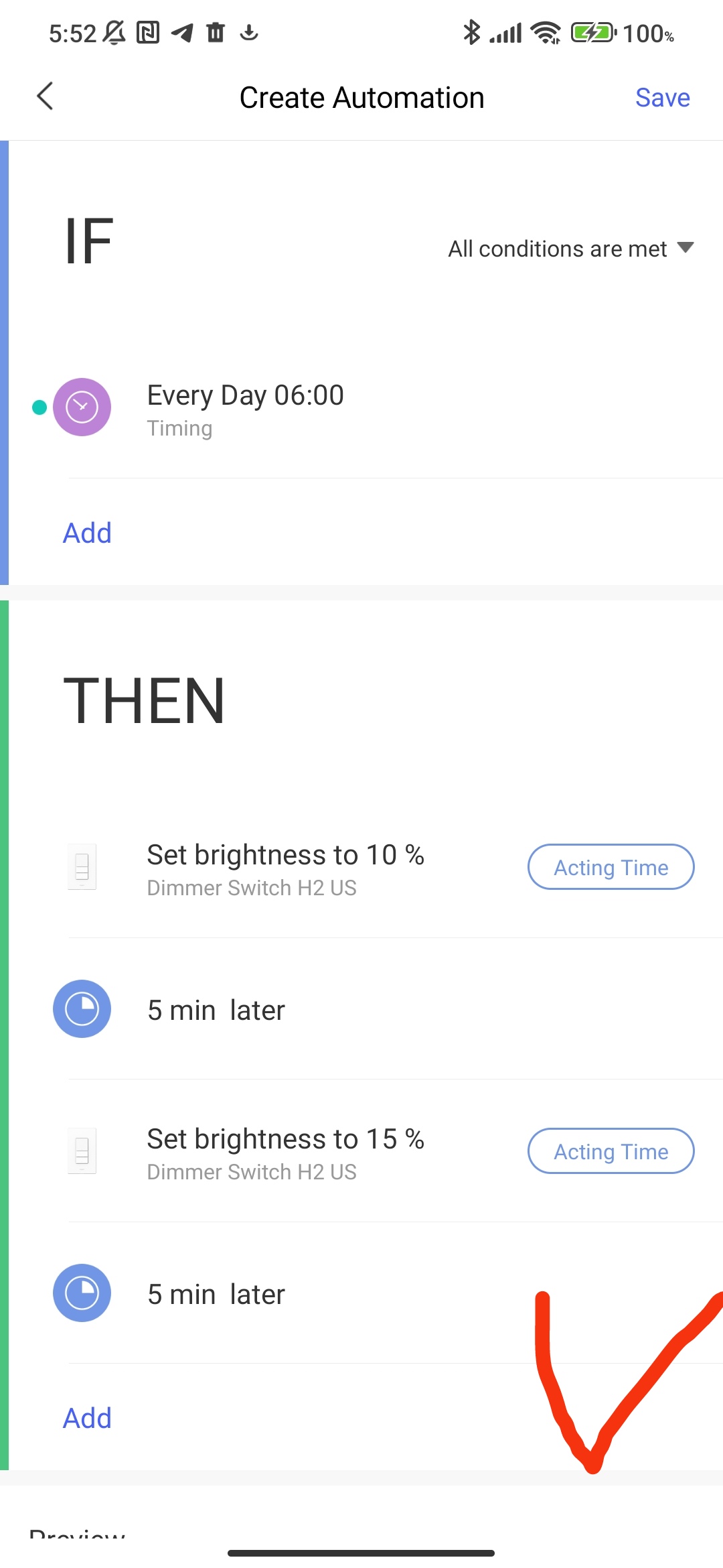

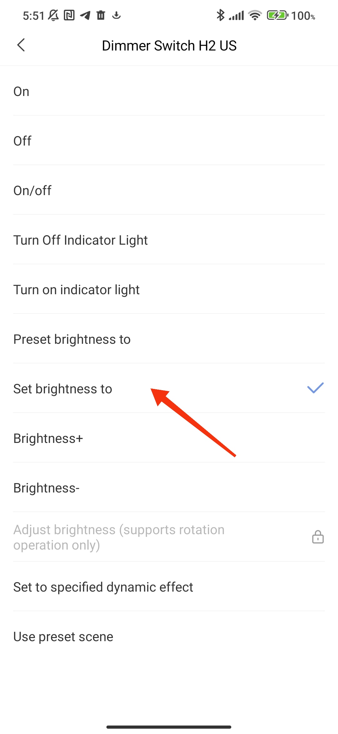

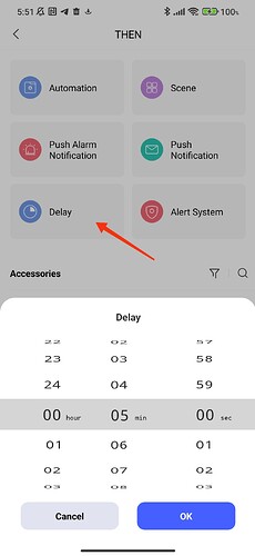

Make an automation
IF at 06.00.
THEN
set brightness to 10%;
insert a delay after 5 min.;
set brightness to 15%
delay 5 minutes;
set brightness to 20%;
make a delay of 5 minutes;
set brightness to 50%
But I hope you understand the algorithm.
