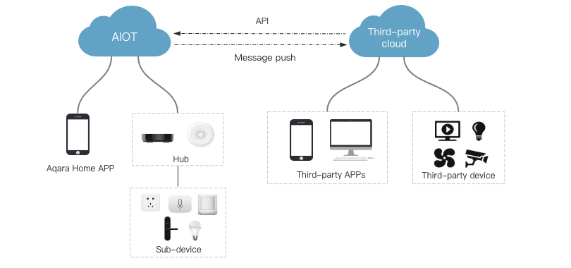

If I’m interpreting the diagram from the official API documentation correctly, it seems the app relies heavily on fetching and pushing device statuses through the cloud:
The diagram illustrates how the AIOT Cloud acts as the central hub for the official app. If there is a bottleneck or a sync error at the cloud level, it explains why the native app is struggling while local integrations (like HA) might still be snappy.
