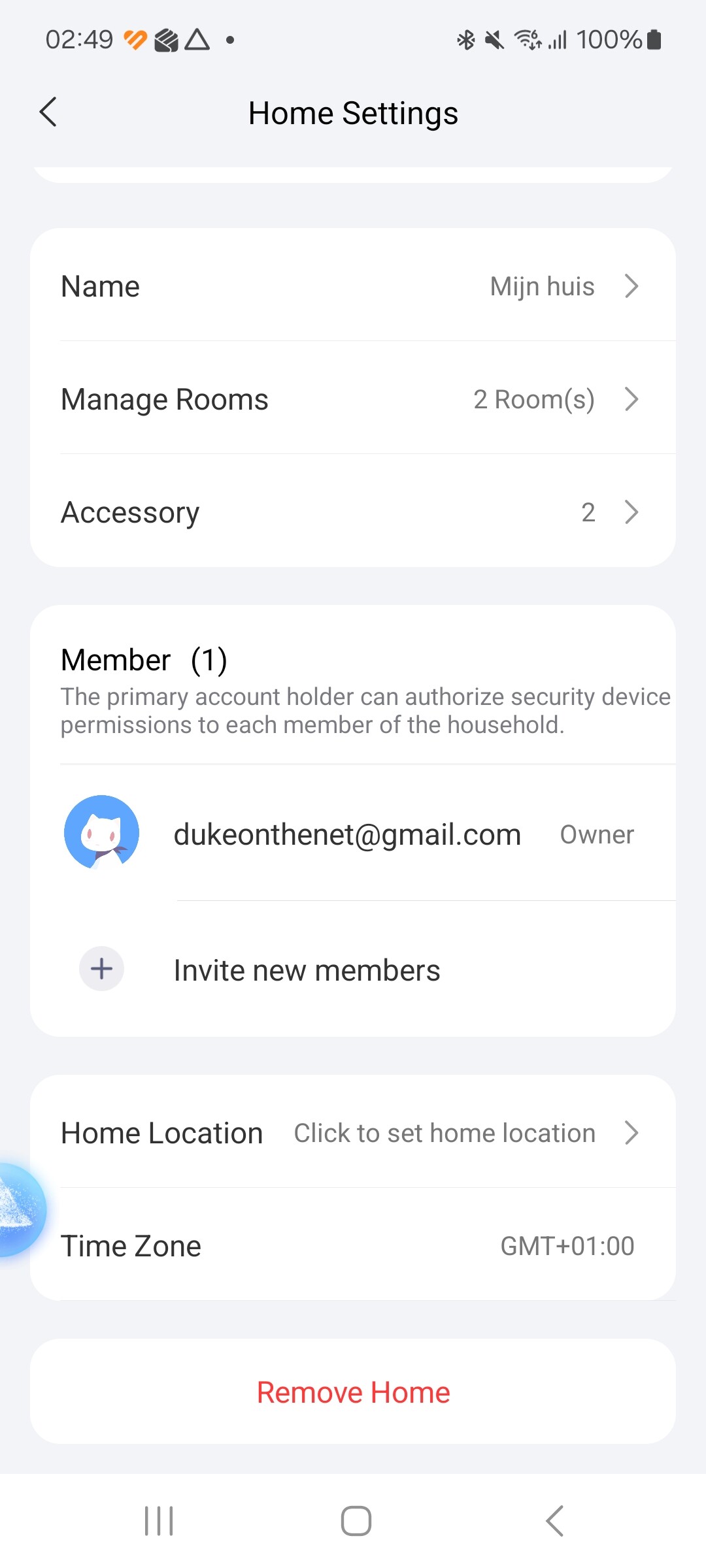

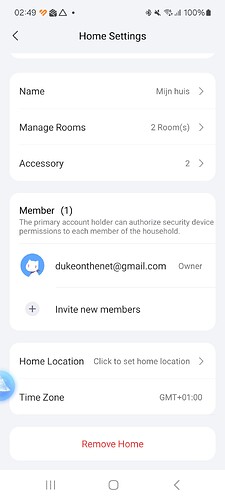

How can I set Day Time Saving in tehe Aqara App for my E1 thermostat and E1 hub?

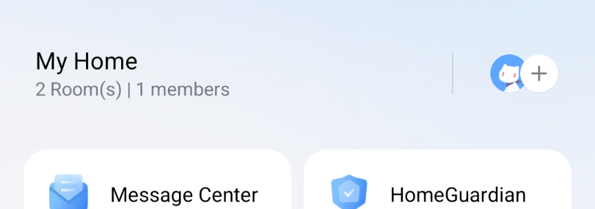

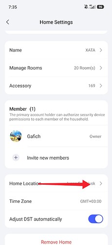

Welcome to the forum. It should be in your Home settings, tap on the “My Home”.

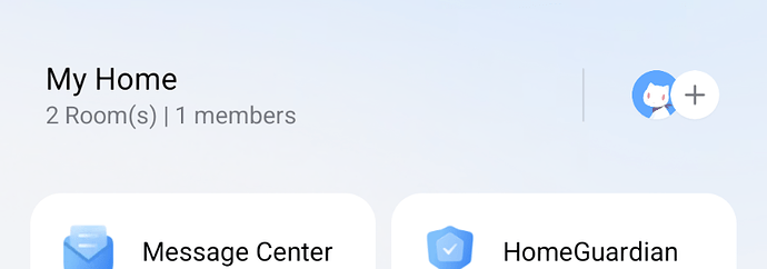

That is not shown in my app

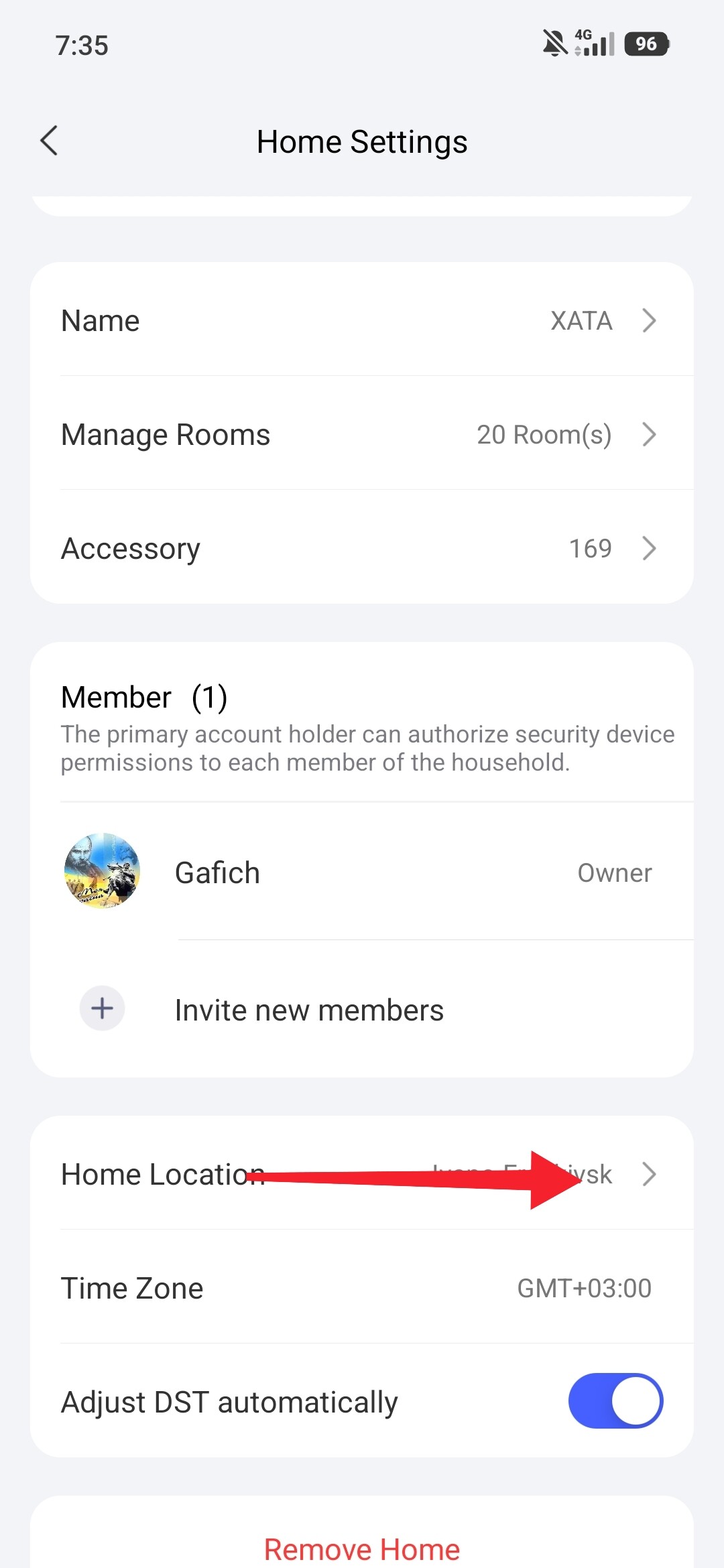

Welcome to the forum, an additional condition must be the selected region and location of the house for the correct transition.

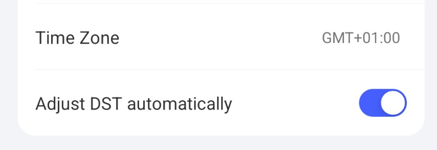

Thanks! That did the job. I knew I had set the region, but that was in My Profile.
Now it works! Thanks again.
