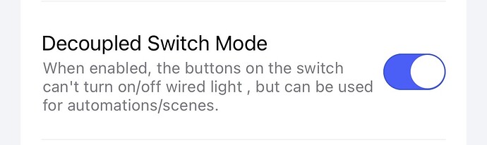

Yes, you can leave the L1 untouched. But you would probably need to power the lamps. As for the wireless mode, it is called “Decoupled Switch Mode” in the aqara app in the device settings.
