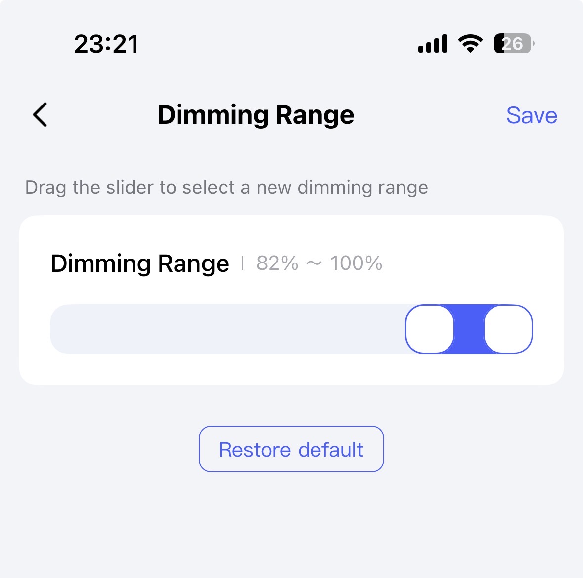

Hi @sites
I think you should pay attention to the calibration of the dimmer, maybe you changed the setting and it stopped working, you need to adjust the dimming range (start and end)

yes, these settings are available in the Aqara Home app and only in Zigbee mode, in order to connect a zigbee dimmer to Aqara home you need a zigbee hub aqara.
