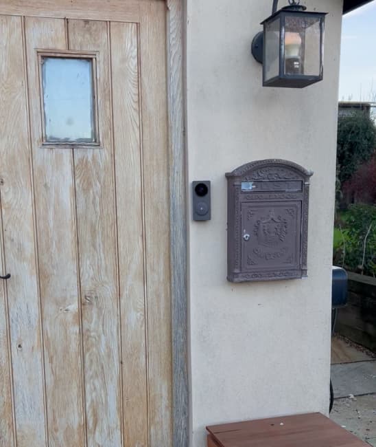

To see how the G410 is installed would be super helpful to give any guidance and tips to help and improve
Hi, I can take a photo and post it at the weekend (I’m not at home for a couple of days). It’s fitted to the outside of our porch, to the right of the front door about 1.2m from the ground. It’s an uncovered location.

Here is a photo showing the installation location.
Thanks for the pic! Looks really normal to me as well. Is that the weather side? But still wondering why it’s condense inside! Maybe a housing helps?!

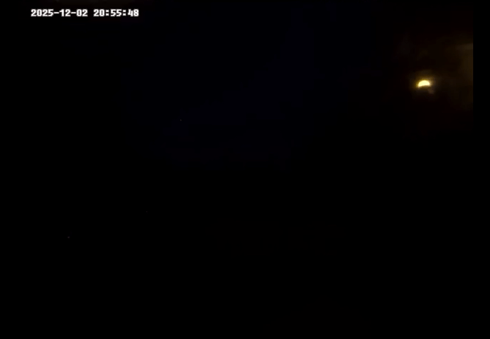

Last night was colder again - not as cold as a week or two ago, and the fogging wasn’t as bad, but I was able to capture some images that illustrate what I’m experiencing.
The first is with night vision off (forced), and as you can see - the image is pitch black, except for picking up the porch light which is dimmed to minimum here. There was cloud cover by the time I took these images, so it was totally dark outside the house. This image illustrates just how dark it can be where I live.

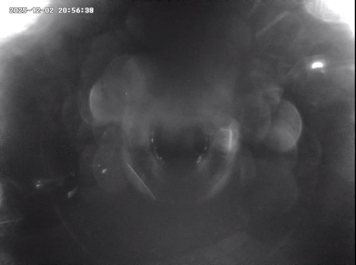

Next I force night vision on, and you can see more - but it’s terribly distorted. You cannot recognise anything in the image.

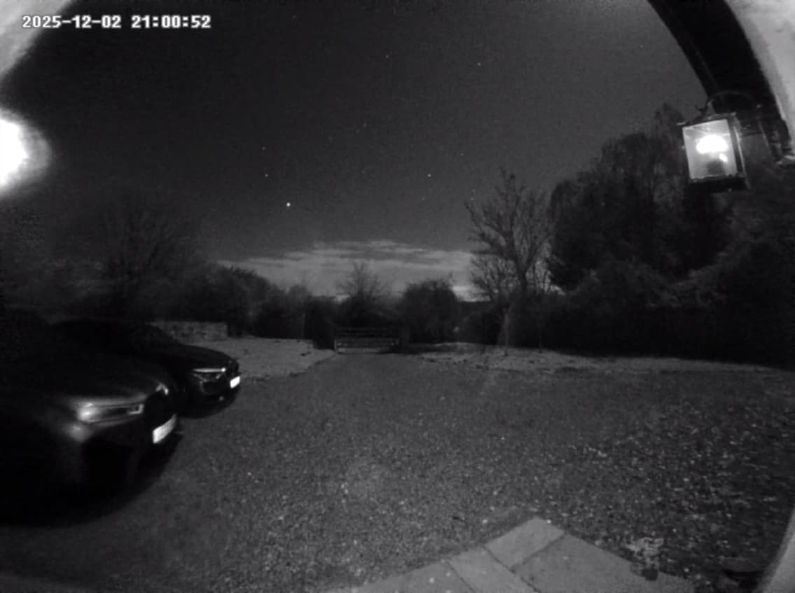

Next I go outside, and wipe the lens with a cloth to remove the condensation / fogging. Voila, the image is now clear and completely acceptable.
Is this typical performance for the doorbell video in these colder weather conditions? It makes the video pretty much unusable when the lens fogs over, and from my experience a couple of weeks ago, the fogging can last for several hours.

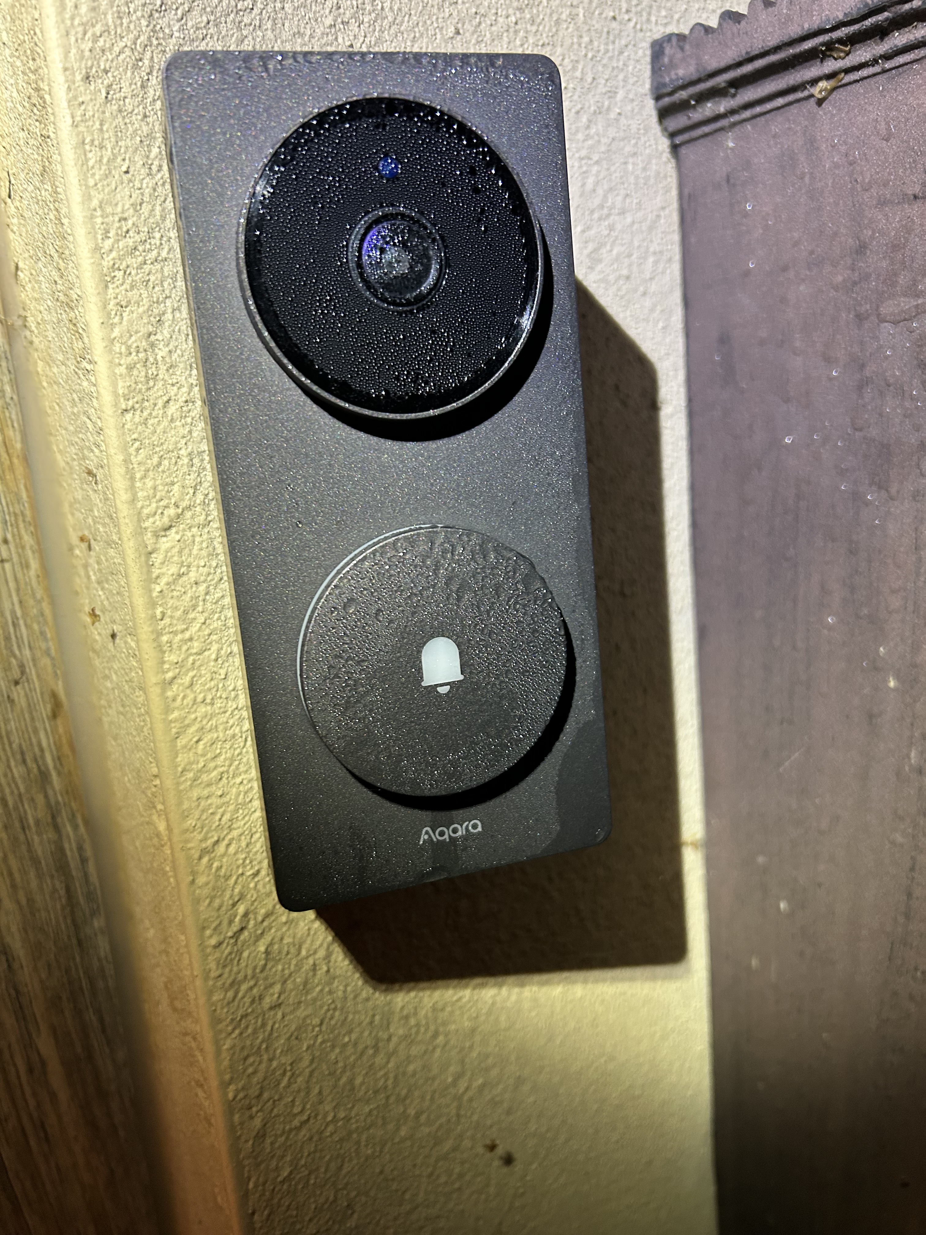

As the light waves pass through the condensation (water), it will be refracted. We can see that with the video image. Presumably if it’s enough condensation on the lux sensor, the refraction can impact the level being detected. The condensation was much worse during the cold snap a couple of weeks ago. The night vision switching has been ok for the past week - I suspect it will become more unreliable once it gets really cold, and the condensation worsens again.
For reference, there is a reasonably degree of condensation this evening. This is how it looks.

Sorry, I just saw this post. It’s a very important feedback. I didn’t expect the winter air in the UK to be so humid. In China, winter is dry, and only in spring do some southern regions experience brief days of humid and cold weather.
Regarding the differences in usage between G410 and G5 Pro, I provide some methods to help you identify the cause of the problem:
  1. The G5 Pro must always be powered on and maintain a temperature of around 50 ℃ during working, which makes it difficult for water vapor to condense. I guess your G410 is using a battery as a power source and operates at extremely low power consumption in sleep mode, unable to generate a large amount of heat energy to resist water vapor condensation. This may be the main reason.
  2. Another difference between the G5 Pro and G410 is that the G5 lens is hidden under a piece of glass (which is part of the structure rather than the lens, and the lens is actually wrapped inside a piece of glass), but I think it is still the first reason that makes it less prone to lens fogging.
  3. If you have the opportunity to use an external power supply for G410, it will increase its operating temperature and generate heat. You can observe if this problem still exists.
  4. If you are unable to modify the power supply of your doorbell as recommended in step 3, then I do not have a suitable solution recommendation for this issue. I will inquire with my optical lens supplier if there are any chemical agents that can be applied to the surface of the lens to prevent this condensation behavior. However, this is not my personal suggestion and I cannot make a commitment on whether it will have a long-term impact.
