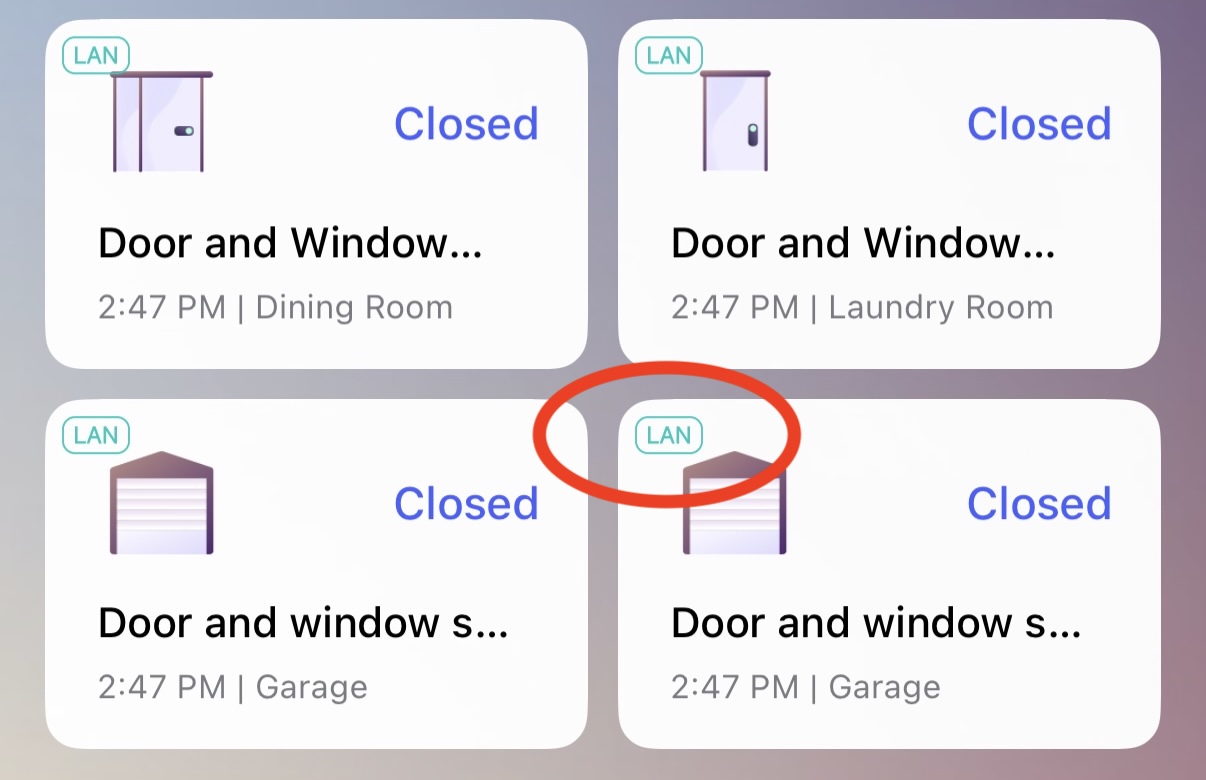

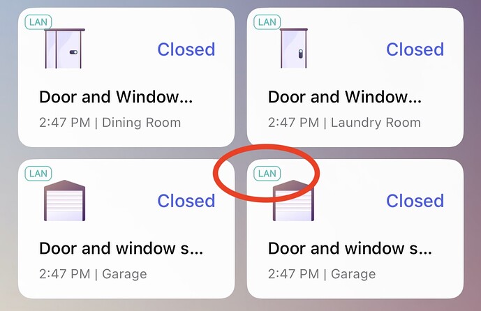

Another thing to consider in the Aqara app go the Settings-LAN Control and turn this ON. Your devices will still work without the internet
