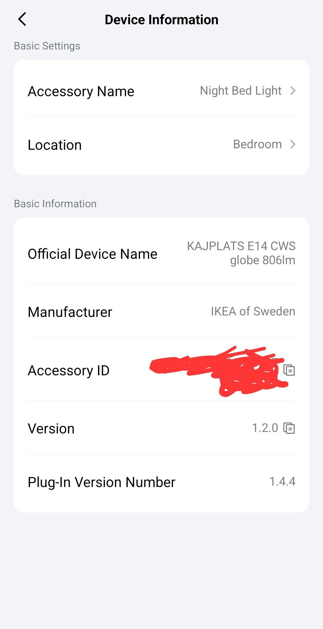

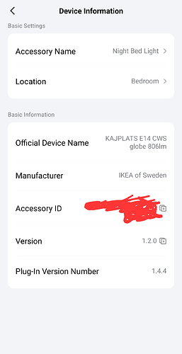

you can find firmware version here:

@Sugar While it’s likely true that Aqara doesn’t support these updates yet, the screenshot provided doesn’t actually prove it.

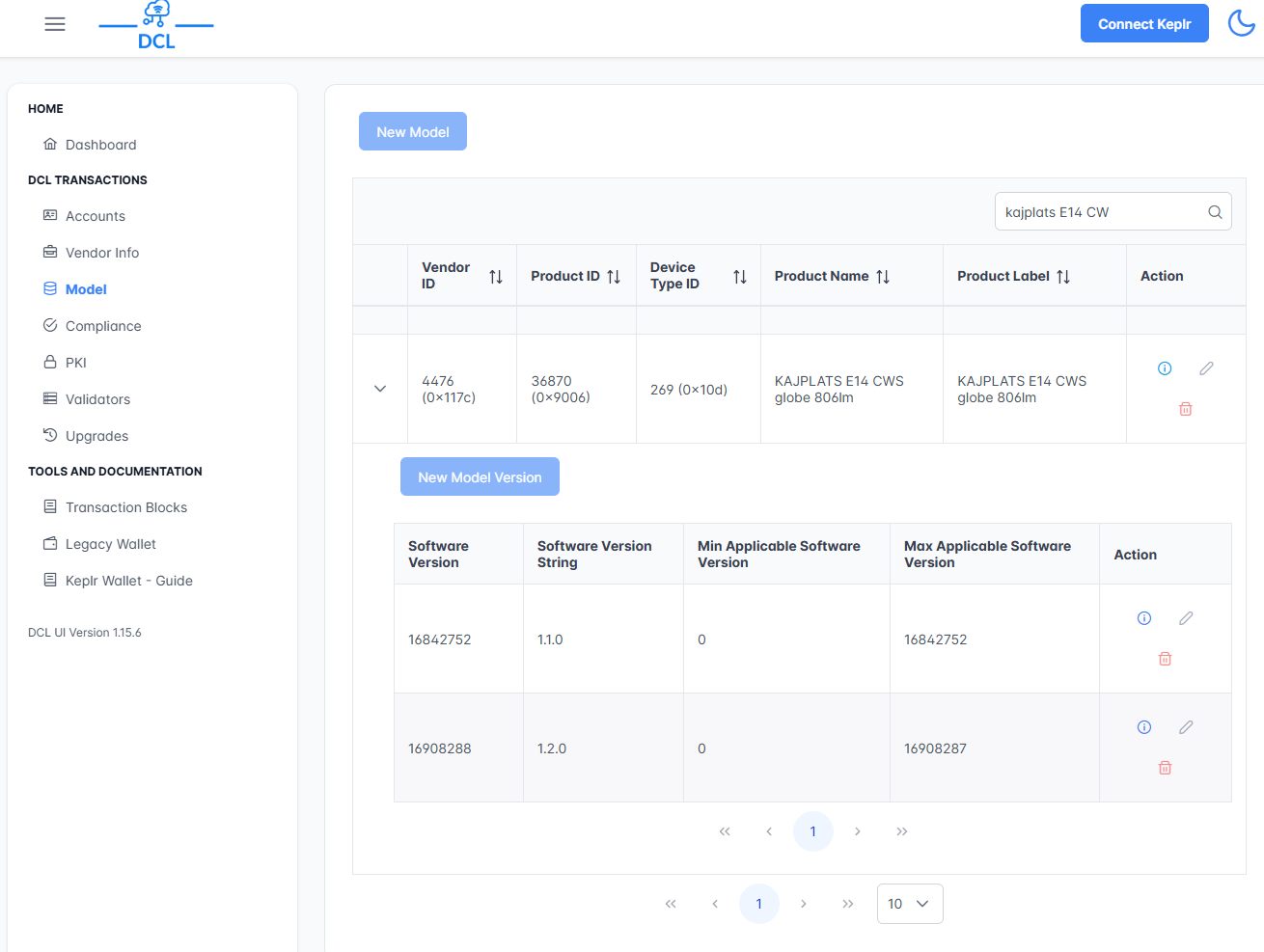

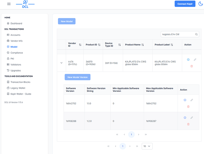

If you check the Distributed Compliance Ledger (DCL)—the central database where Matter manufacturers host their firmware metadata—you’ll see that version 1.2.0 is currently the latest release for this specific IKEA KAJPLATS bulb.
Since the device in the screenshot is already running the newest version available in the DCL, even a controller with full OTA support wouldn’t show an update. We would only know for sure if a new version was published to the DCL and the Aqara app failed to notify the user.
Source: Distributed Compliance Ledger

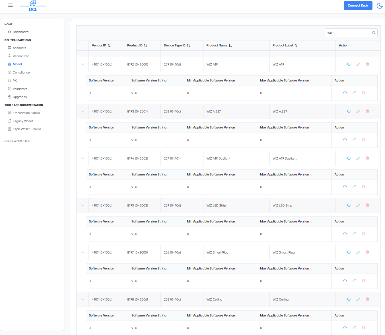

Just discovered that WiZ Matter devices only update through the WiZ app. I recommend setting them up in the WiZ app first and checking the firmware version — it should be in the 1.3x range. If not, wait for it to update automatically before adding it to your hub.
This is probably because the manufacturer doesn’t upload any updates to the Distributed Compliance Ledger (DCL). Therefore, it is impossible to receive updates from an ecosystem that actively supports universal over-the-air (OTA) updates.
