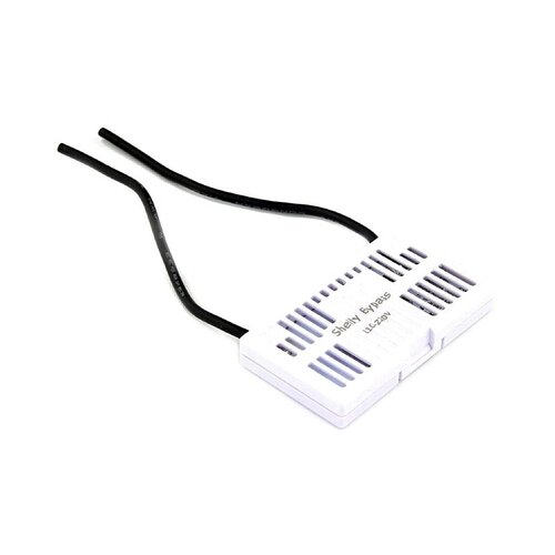

Install an additional bypass in the ceiling junction, then you won’t have to worry about using smart bulbs. For example
Thanks a lot for your reply! :pray:
Yes, adding a bypass like the Shelly one is definitely a solid workaround if it turns out the switch can’t stay powered otherwise.
That said, I’m hoping to avoid adding any extra components in the ceiling if possible — so I’m mainly curious whether the new Aqara LED Bulb T2 E27 already allows enough leakage current on its own to keep the H1/H2 No-Neutral switch powered reliably.
