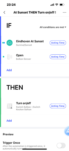

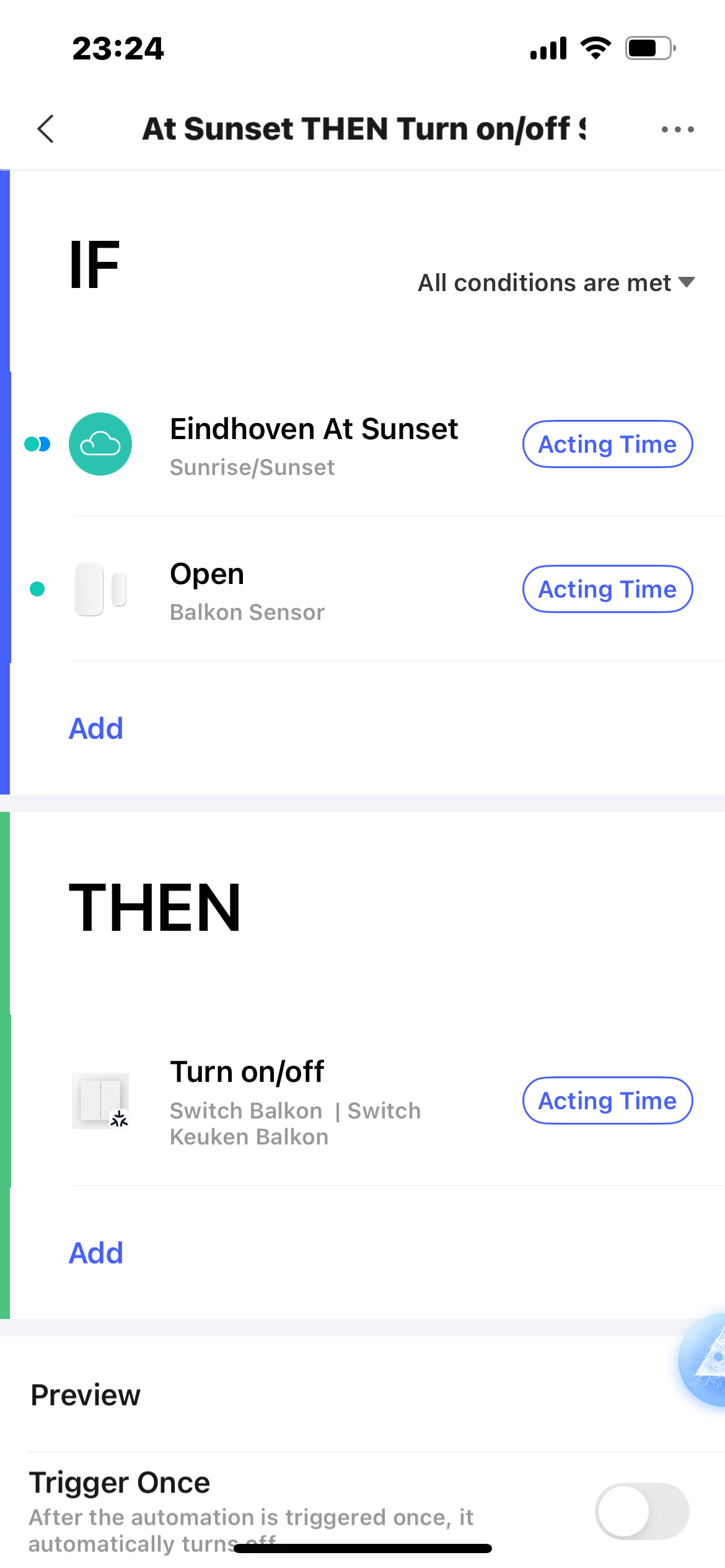

@gafich10 @Raman.V @gtxteo Thank you all. Maybe someone can explain to me why it doesn’t work with “Then: after sunset on/off” because I was thinking that it would be the same as “Then: Door switch on/off”.

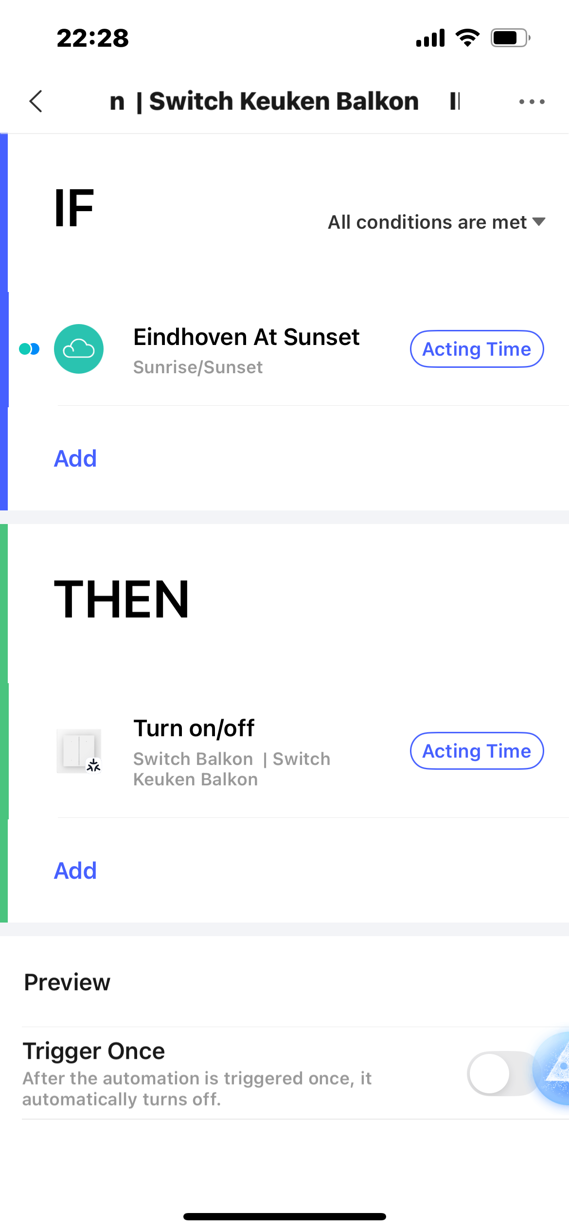

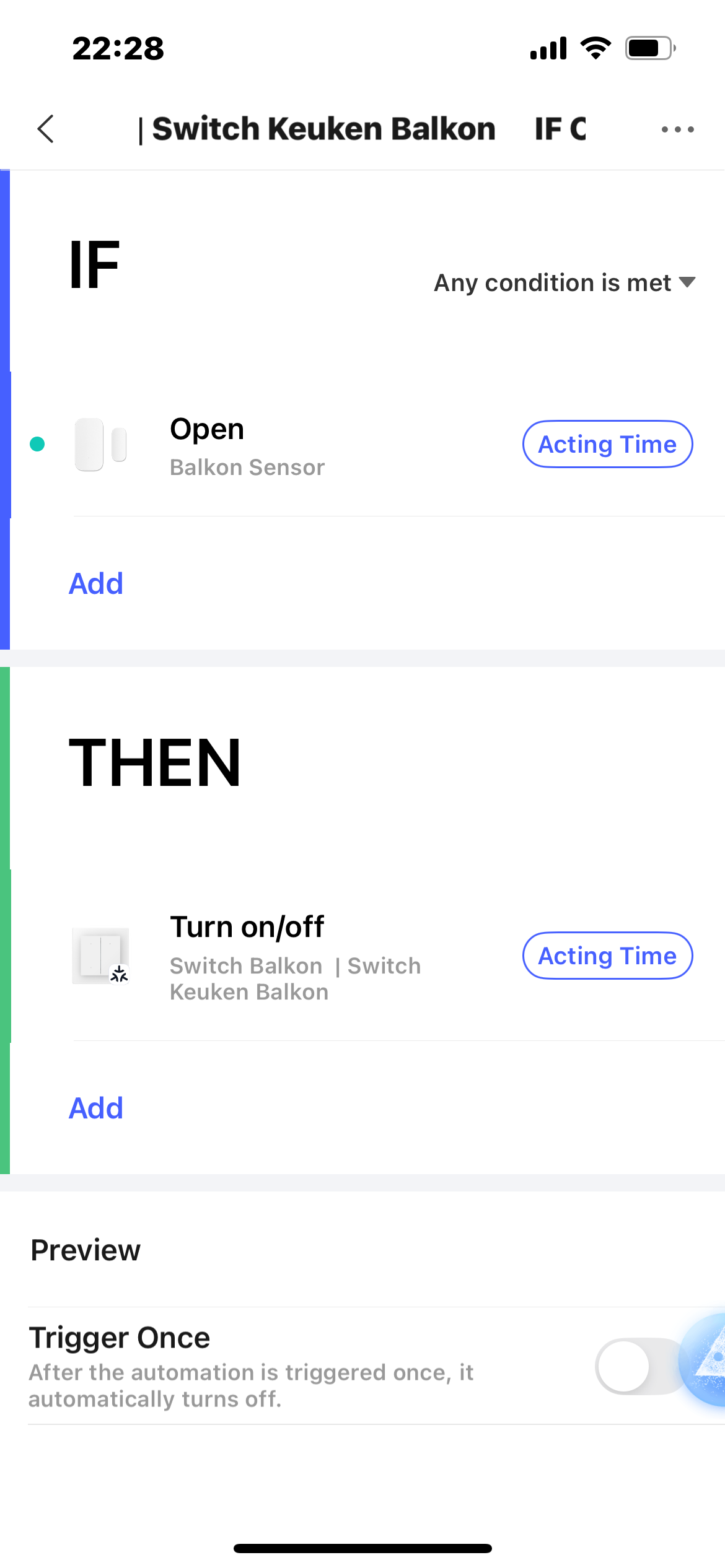

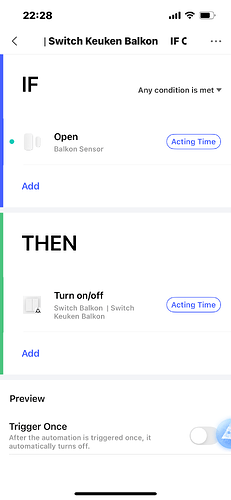

Give me a screenshot of the automation screen
These are the two automations
The first one works.
Translation: keuken- kitchen / Balkon- Balcony
@gtxteo, @gafich10 and @Raman.V
I found the automations that i needed. So now everything is working as it should be. It was a combination of the two automations.
