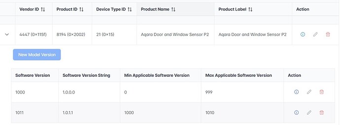

Aqara actually released a firmware update for the P2 door sensor, published in the Matter DCL with the OTA URL so any Matter platform could update it if they wished.
Word of mouth is it bricked devices so Aqara had to invalidate the update (software version valid = false) but never released a fixed one and just shipped new devices with the new firmware.

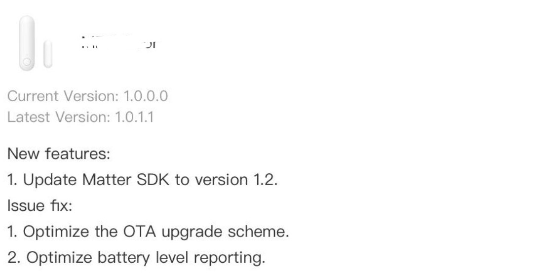

My understanding after these two years is that the first version of the P2 door sensor had a bug that prevents updating the firmware. That has never been confirmed by Aqara but, if that’s the case, a confirmation would be nice, and even a recall of the product would be better since none of the promised features will arrive if the product cannot be updated.
Can someone from Aqara give a definitive explanation of what happens for people who bought the sensors back when they were released to the market? Are they doomed with no updates?
Edit: Coincidentally, the new firmware release notes mentions fixing issues with the OTA updates, hinting at a problem with the updates of the original version. This is a pic taken from reddit:
I was wondering what happened to the 1.0.1.1 version and that pretty much explains it all… Looks like my sensors won’t be updated anytime soon… I hope I’m wrong

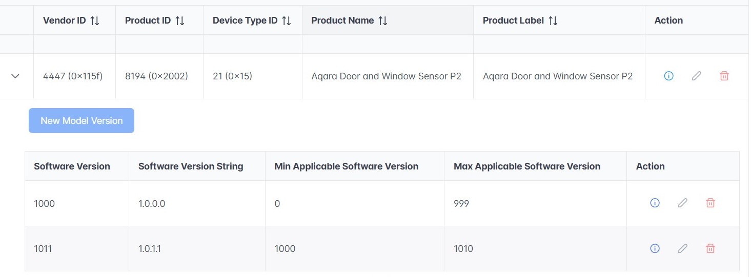

Now they did the same with 1.0.2.0. It appear to be discontinued too!
You’re right! :neutral_face: I didn’t even checked, but Software Version Valid is indeed false!
