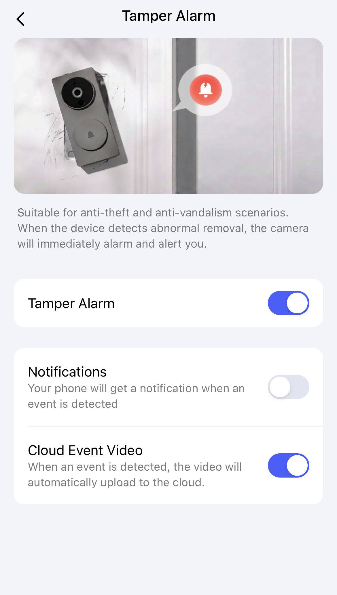

I have a G410, but I suspect it’s similar with the G4. In the Aqara Home app, go to
Accessories → your Doorbell → three dots in the top right corner → AI Detection → Tamper Alarm
If this option is enabled, I suspect that the alarm will be triggered as soon as the back of the doorbell is removed. So, disable the option before replacing the batteries and re-enable it afterwards.
Exactly! Like @JohnD described the same setting is also available at G4 - just disable it before replacing batteries :low_battery:
